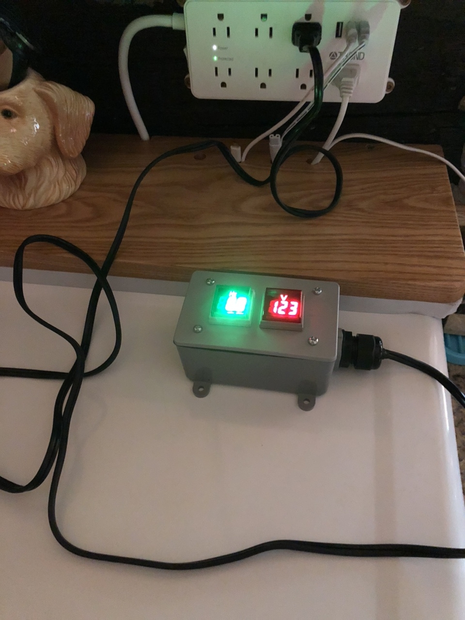

Got meters on Amazon. Checked with my fluke,
hertz right on, voltage <1volt low. Using the box to monitor house power by the tv. Hertz is steady. Voltage 121-124. Extra meters for generator. Box to monitor power inside.
