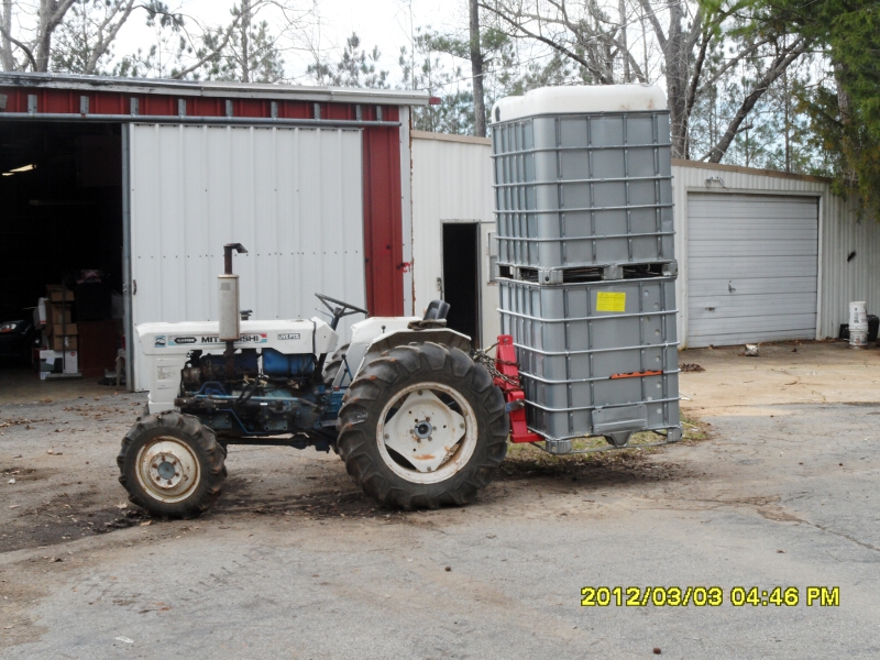

Where I'm retiring I'm setting up IBC totes for diesel and water.
That's about 300 gallons each.

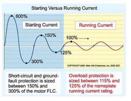

Here's running a 1-1/2 HP motor, that's = 1119 watts, his breaker is 240 * 15 = 3600 but the breaker isn't blowing when the motor starts in fact the breaker is most likely rated 30 to50% over his load. At 2400 watts (240V * 10A) he's a little over 2 times his rated HP. Motors draw is limited by wire ratings and sizes, you can't continually draw more than the wire current rating. At my conservative 3 times over rated HP he's more than safe in his energy calculations.
I think a motor starting load is a product of load regardless whether the load is a well head or a fridge compressor. Using more than three times is overkill, regardless of the application.
Are you saying well pumps draw more current than any motor with the same load? How much more than 3 times do you think he needs?
Motor inrush current can be more than 6 times running current depending on the NEMA Locked Rotor Amp code usually listed on the nameplate of the motor. Here is a chart for reference and how to use it. NEMA CHART
That's locked rotor amps! What happens when you lock a rotor on a motor? You blow the breaker! It's not the same as starting amps.
Motor Calculations | NEC content from Electrical Construction and Maintenance (EC and M) Magazine
" Motor locked-rotor current. If the rotating part of the motor winding becomes jammed so it can稚 rotate, no counter-electromotive force will be produced in the motor winding. This results in a decrease in conductor impedance to the point that it痴 effectively a short circuit. What痴 the result? The motor operates at locked-rotor current, often six times the full-load ampere rating, depending on the motor Code Letter rating [430.7(B)]. This will cause the motor winding to overheat and be destroyed if the current isn稚 quickly reduced or removed."
Electrical Motor Calculator
Plugging in 1 hp , 90% efficiency, 85 PF (power factor) and 230V to the calculator in this link.
You get:
1 phase = 4a.
FLA = 5A
What does FLA stand for? Full Load Amps! At full load the motor draws 5A, 230V * 5A = 1150W; 1 HP = 746W FLA for a 1 HP motor = 1150/746 or 1.54 times.
Now look at the chart for starting amps, what does the FLC state? 150% to 300% of running current and what's 300%? It's 3 times, exactly what I said. I work with this stuff everyday my systems are built on these calculations. Are you off the grid running several inverters on a daily basis?
