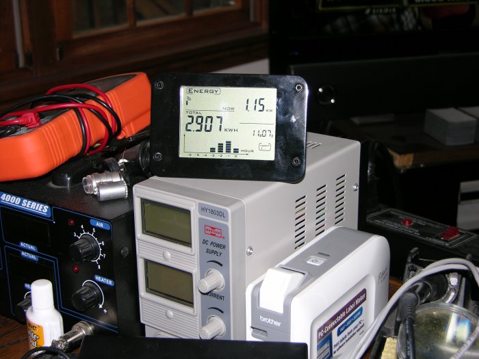

OK, thanks Rob. My reason for asking was to get some free advice, without any professional liability. Most engineers overdesign at the expense of their clients to cover their own Errors and Omissions. I'm a risk taker, and I accept that. The generator salesman wants to sell me a unit three times bigger than I need. The fuel salesman the same. I'm a survivor, just trying to get by. When the goin gets tough, every ounce of fuel really counts. That's why I originally posted your quote. We live in a wasteful society and we don't even know it, until we run out what we need. Just like our country has run out of affordable health care, because doctors order a lot of unnecessary proceedures to cover their own liability, and guess who pays. So, back to the drawing board I go...(BTW, what would you charge me to design the smallest, minimalist, survivalist back-up system that only gets used a few days a year, with a discount for waived professional liability?)
Fred, thank you for asking but I'm semi-retired now, most of my work is in electronic engineering using embedded microcontrollers and several audio designs I promised an editor. Perhaps one of the people here who found my solution overly simplified might be inclined to address your issue but, again, a 25hp hydraulic elevator mandates a bonded legal responsibility in my view.

Thanks for the advice. I checked with the power company and "demand" does not measure peak surge, only the average of maximum usage in five minute increments. They recommended I measure with a pulse monitor; so I am still learning.

For less than $100 (on Amazon.com--more at your local big-box) you can get an "amp clamp" will answer this question definitively. Be sure to get one with an "inrush current" measuring feature that will detect and hold the peak draw from the motor.

This digital monitor comes with 4 wrap around clamps 2 large and 2 small. I clamped one around each of the incoming load legs from the meter. The probes then plug into the back of a small transmitter that will send the signal a couple of hundred feet to the receiver. It gives a read out in real time and stores a 2 year log I believe. The whole shebang is battery powered.
Hmm, does it read amps per leg, or just combined amps?
Does it read voltage and/or Hz?

I don't know of any clamp on devices that measure voltage and/or Hz
It measures combined kw usage cost per second, hour, day, week, or month – iConserve conveniently converts energy use to cost per second, hour, day, week, or month. It is easy to adjust iConserve's settings to get the most accurate reading for your time period.
