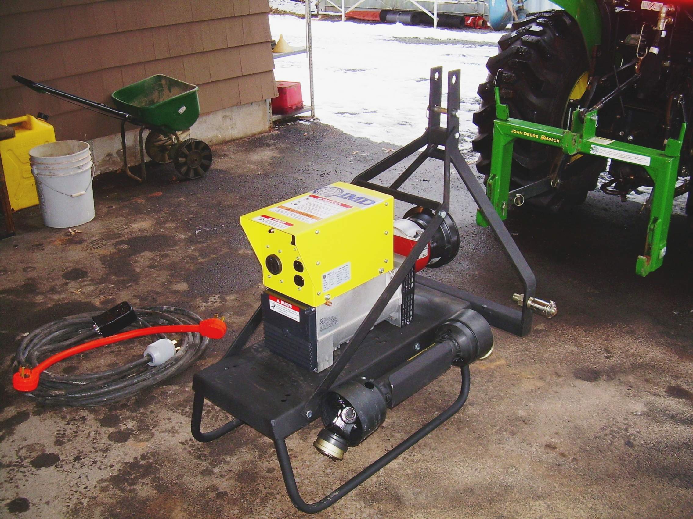

I'm seriouly considering purchasing a 15KW PTO Voltmaster generator. I have a 24hp lawnmower that absolutely uses gas at a alarming rate while my 790 JD sips diesel at rated pto speed compared to the gas lawnmower. I can buy a 15KW PTO generator for less than $1200 while a motor/gen set will run around $2300 and probably use twice as much fuel for an extended run time. Is there anything pro or con about the PTO/tractor combination I should know or am missing. I have a frequency meter to set gen speed with and have a smaller 6KW generator now. The governor on the small gen. is really nothing special in relation to frequency control. Really no better than on a tiller or lawnmower. I would think once speed/ frequency is set on tractor, it would have a better governor control verses the smaller gas engine, or am I missing something. I appreciate any information or experience either way in regard to the two. Thanks - Chuck
/ PTO Generator Question #2

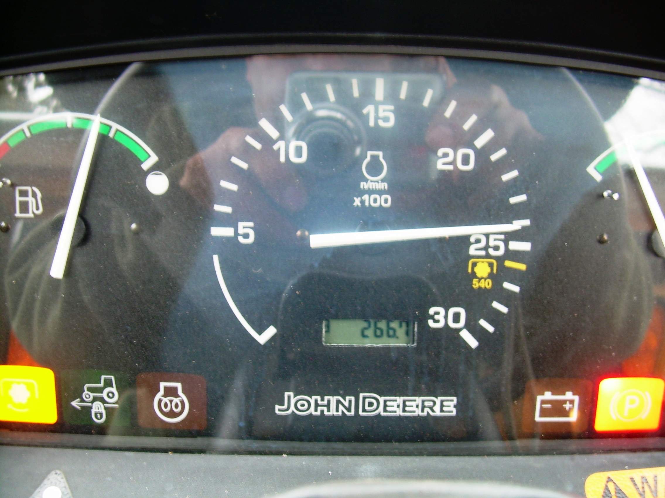

There are alot of threads on this subject but I don't know how to link to them, I learned a great deal here while I was in the process of getting a pto gen, I got a 10 KW IMD brand.as far as the governor goes I can give my own experience, I experimented with mine on an old ford 1700 diesel and a newer JD 4310, it not just set it and go, the tractors gov will not compensate for the wide swings of 5-10 KW you will have to manually adjust throttle a little, the newer tractor was a little better but still required manual input.
If the load was constant then that obviously would be better,
Like I said there is alot of great info here, you'll have to search a little or maybe someone can link some of the threads.
Your 790 has around 30 pto hp? so 15 kw would not be to big as the gen rule is 2 hp per kw, I kinda wish now that I got the 15 kw as the heavier mass spinning probabbly makes it easier on the governor especially with a 10 kw draw, would run cooler to.
As far as the pro and con goes there's alot of that, it almost turns into a fight when really it should be just a personal preference.
this might link you to a recent discussion
http://www.tractorbynet.com/forums/attachments/129834-power-take-off-generator.html

Where you will probably run into issues, is governor control like JB4310 mentioned. Your typical tractor governor is/does not have full authority. It only has fuel control in a narrow area around where the throttle lever is placed. What does this mean for the PTO generator user? Well if you have any really massive single loads, they may exceed the governors ability to react. Basically, the governor can't deliver enough fuel to maintain RPM for a large load increase, even though the applied load is within the engines HP capability. This is where a larger tractor might work better, as the governed range is larger in terms of HP. You of course will have to experiment to see exactly how much of an effect your major loads shifting on or off has on how well the governor can maintaion RPM/frequency.
A 15KW set is a good match for a 30 PTO HP tractor. But a 10KW set may maintain RPM better unassisted from zero to full load. Even with gearbox losses, you will probably be under .2 gallons per Killowatt per hour for fuel consumption. IE: a sustained 5KW load will cost you one gallon per hour...

I run my 12/14KW with an L2550. It holds the gen speed +/- 5% regardless of load. This has presented no problem to appliances or computers. No glitch when the air compressor or AC comes on. I have had a problem with a standalone tho, that did not run steady under light load. It caused problems with electronics due to "hunting" rpm unless the gen was carrying at least a 25% load causing the rpm to be steady.
