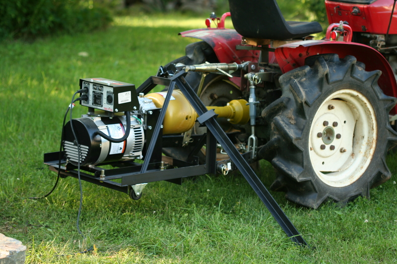

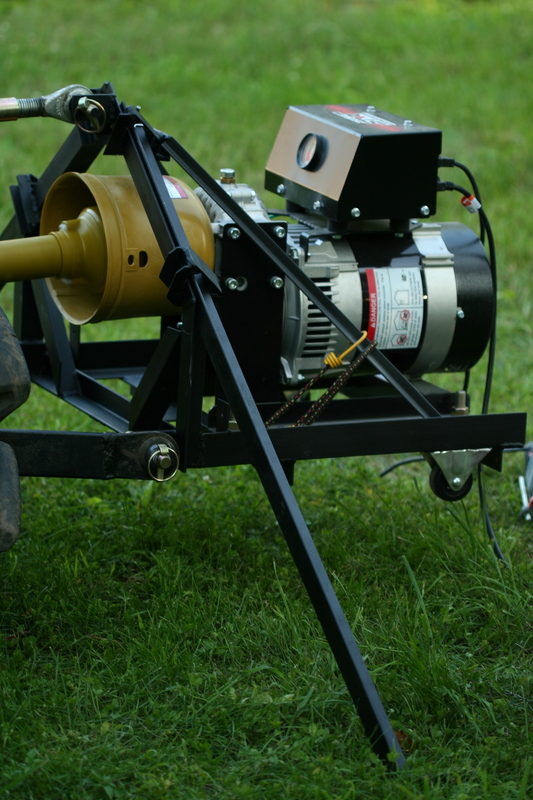

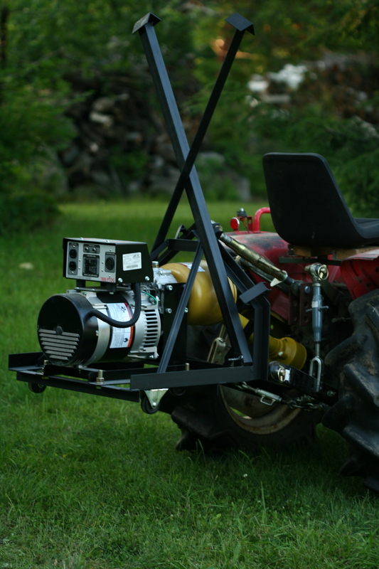

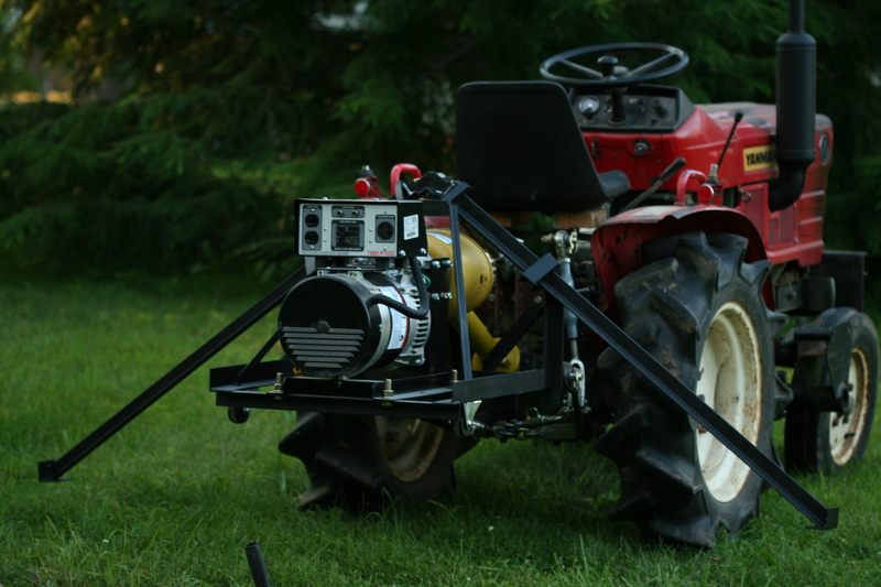

I got the 7200W PTO generator from Northern and made this frame to mount it to my YM1510's 3PH. I wanted it to take up as little floor space as possible when not in use. The detachable side arms provide horizontal stabilization and the 3PH keeps it from tilting back when resting on the side arms.
If I were doing this again, I'd put the lower link pins up an inch or so higher (turns out my lift arms only almost reach them), and I'd make all three casters swivel (I used a swivel caster in the center front, and two rigid casters in the rear). Otherwise, it seems to work pretty well.

Nice job on the generator frame! I've never used a PTO powered generator; but does it bounce around that much to require horizontal stabilizers?
/ PTO generator 3PH mounting frame #4
Mine doesn't.... the 3pt holds it solid like any other pto powered 3pt implement..
It would hold fine, but there's slop in the 3pt connections, and when it goes from no- or low-load to a higher load (like my well pump coming on), I didn't want one side to jerk up when the generator suddenly provides a lot more resistance.
Need to fix that slop! :) where you getitng it at/ bal ends or??
