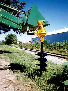

One of our partners has found a slightly used Danuser 8300, a hydraulic PHD that mounts to the tractor bucket. Any of you guys have an opinion? Ever used one of these 8300's?

   / PTO-driven post hole auger suggestions #55
The hydraulic digger is ideal in some respects.
A: it has down pressure due to being bucket mounted.
B: it is reversible
C: it's easier to place the holes precisely where you want them
Downsides:
A: be careful not to twist the loader arms, a center-line attachment point is best.
B: be sure you have enough hydraulic flow to run it properly. Most smaller tractors may not.
I have no experience with hydraulic diggers in general, and the Danuser in particular, just speculation on my part.
Sean
#56
When you say "center-line attachment", do you mean the best place for attachment would be in the center of the bucket, directly between the two loader arms? The Danuser website shows the device mounted on the side of the bucket, so I just want to be sure I understand what you mean.
   / PTO-driven post hole auger suggestions #57
They are usually mounted to the side of the bucket for operator visibility.
   / PTO-driven post hole auger suggestions #58
A lot of people seem to think that they would like them. Not me, the pto units have more power, are easier to see what your doing IMO. A 3pt PHD is maybe 5-6 feet away and a hydraulic auger is waaaay out there mounted on the side of your bucket or in the middle as it should be. Just how good can you see out in front of your tractor at ground level? No thanks, I would keep looking for a 3pt PHD. Now there are hydraulic 3 pt PHD, and if you lived where you had to deal with a lot of rocks or roots, that would be the way to go IMO.
Do all 3 of you guys have remotes? If not, the hydraulic route may not be the way to go anyway. Just some more things to ponder. ;)

   / PTO-driven post hole auger suggestions #60
I'd prefer to have the auger centered between the loader arms, any excess loading wouldn't tend to twist the loader.
I find my neck gets stiff running the PTO digger after a while.
A hydro unit for the 3 pt would be sweet as well, having reverse is a VERY GOOD THING, particularly for smaller tractors.
One thing to consider with the bucket mount, is that the size of the loader defines how easily it will twist. A 100 hp tractor FEL won't be bothered by a bucket mounted PHD, a 30 hp might be. My 2 cents on the situation only.
