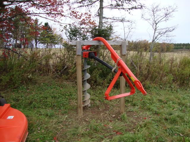

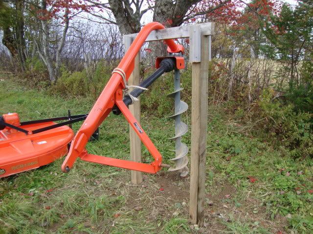

Funny you asked for pictures, I was outside this afternoon moving the auger to a new spot for the winter. Unless it REALLY rains tomorrow, I should be able to get some pics of the hanger. My total cost was two pieces of pressure treated 4x4, a few short pieces of PT decking, and a few screws. The old hanger was even cheaper, I laminated two pieces of 2x4 together.
The dam* things are like wrestling with a 300 lb steel octopus unless you have some way to support them.
Sean
   / PTO-driven post hole auger suggestions #43

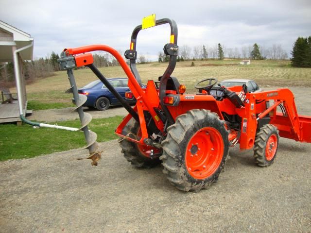

Pics as requested. You can decide whether or not you want the auger tip to touch the ground when you cut the posts to length. I cut two inches off one 8-footer, the other is full length. 3 feet plus in the ground, my post height is 58 inches, and the auger is just clear of the ground.
You'll want to tamp the posts in place as you fill the holes to firm them up, or add concrete for a more permanent job.
It works well for me, a one-armed man with a runny nose could load the PHD with this setup. Credit goes to Gary (mountainviewranch) for the idea, I just copied what he had.
The auger tip clears the ground by about 12 inches on my 3400, I think it's a 42 inch auger on the Kubota digger. The PHD is probably 15-20 years old, it got a fresh coat of paint and an overhaul when I got it.

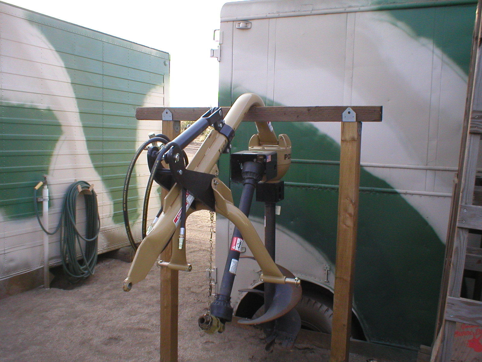

Hey, Sean glad that the PHD stand worked out for you, looks good. Just like you have said, with this stand it is pretty easy to hook up your PHD. Anyone that has problems hooking up their PHD needs something of this type. Unless your digging 1 very small hole, it is faster to install the PHD, dig the hole and take it back off than it is to spend 15 minutes to hand dig a hole. Anything more and your just saving time and a backache. :cool2:
As far as down pressure, I have some ground that is so hard that my auger would not dig down much more than 8"-12". Pour water in the hole and maybe if the water soaked in you would be able to get the hole dug the next day. With a down pressure kit that multi day hole now takes right about 90 seconds.:thumbsup: Believe me or not, :confused3: just saying how it is with conditions that I have.
Here is a pic of my auger with the down pressure hydraulic on it hanging on my stand. Oh and my name is not Gary. :D :laughing:
