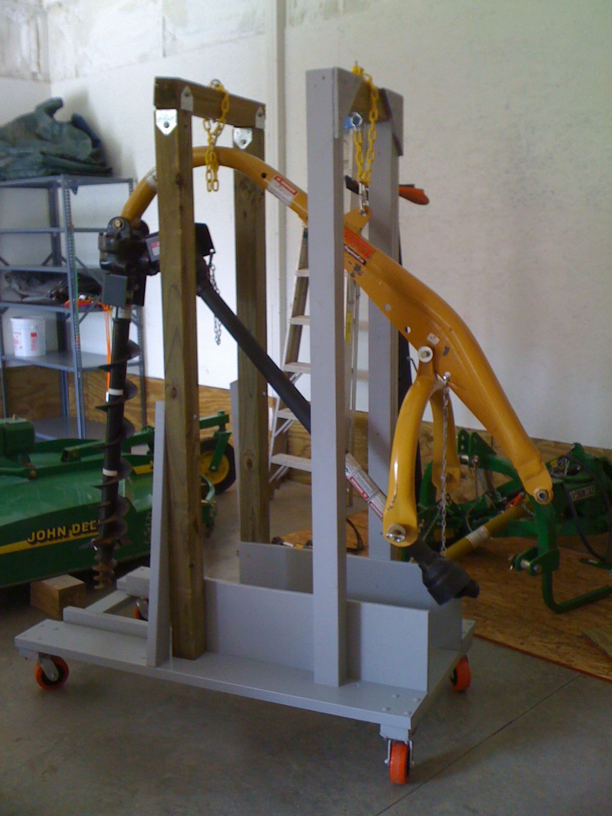

As far as getting the PHD on and off, a frame or dolly helps. I did mine with two mount points so that I can back the PHD up to the tractor and just have to move the end an inch or less. Concrete floor helps. This would be the "over 50" design style of dolly :laughing:. Build out of scrap wood, that's why you see different types and sizes of wood. It's easy enough to put on and take off that I'd use it even for one hole. Like many attachments, you should be required to perform the chore by hand before you use an attachment so you can really appreciate the tool.
I'm using the Speeco PHD from TSC. I use it on my JD4520, so I can't speak as to any height issues- it fits. I also put that white electrical tape at the 1 foot and 2 foot depths, it's coming off so I'll paint those marks on this winter. It was half the cost of the Deere, but that's not important. What makes that work for me are two points:
1) I only wanted to have a 6" and 9" auger for 4x4 and 6x6 posts.
2) This area/my property has clay that is relatively easy to dig in, big rocks are more that 3 feet down, don't need down pressure.
Yes, the Speeco isn't as well made as the Deere, Woods, and Linebauch. I'm just lucky in that my requirements and soil types let me get by with it.
I grew up in New England, and would not try to get by with this up there in most places.

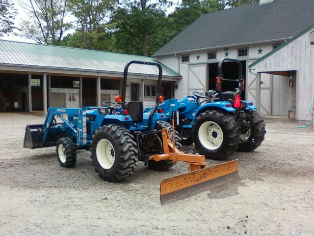

Here is a pic of the "two blues" the TC-30 and the TC-35. Although the camera angle makes the 30 look a bit larger than it really is in relationship to the 35, it is still a shorter tractor with a smaller frame. That's why I'm paying so much attention to not accidentally buying a PHD that would be "too tall" for the 30.
