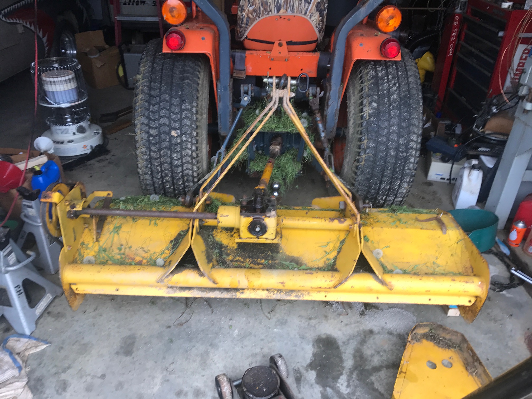

Hello,
I recently purchased this flail mower but it is not totally right for my tractor. I wanted to find out if the alignment of the PTO drive shaft is OK to be about 3-4 inches off alignment from the center line of the tractor PTO shaft? I was thinking of welding new mounts on the mower to get the PTO shaft aligned but I was not sure if this would be necessary.
Thanks,
Paul
/ PTO Drive shaft alignment #2
That should be find. I have a BearCat chipper that is off-center more than that.
gg
/ PTO Drive shaft alignment #3
The manual that came with my wood chipper says to run the pto shaft at a 15 degree angle or less.
/ PTO Drive shaft alignment #4
It's the angle, not the offset, that affects universal joint longevity. So if ericm979's PTO shaft was similar to yours with your 4 inch offset, than any shaft longer than about 15 inches (between u-joints) would be less than 15 degrees.
Angle=arcsin(offset/u-joint distance)
Also, that offset is the total offset, not just horizontal or vertical offset but their combined effect. That can be calculated too.
