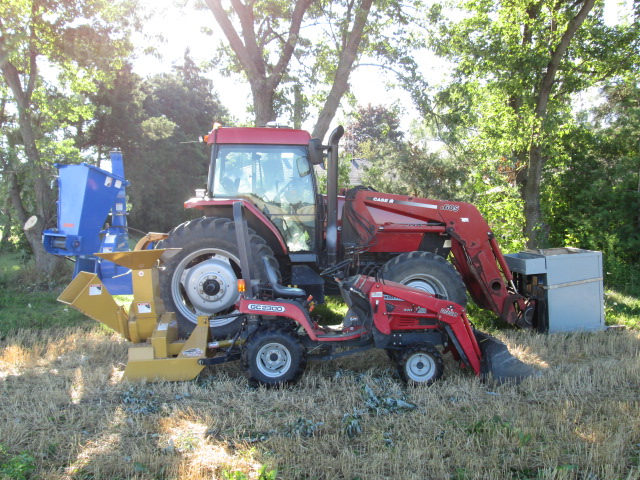

They look so cute together.

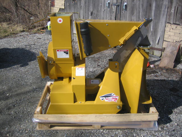

I just picked up a BX42 from Woodward Crossings from the freight yard yesterday. Shipping was very fast and communication was superb. Great place to buy from.

They are a husband and wife team, nice people. Wife handles the computer and money, husband handles the equipment. Shipping would have been ~$250 for me. I was able to pick it up cheaper, not including my time, and I didn't have to take any time off from work to meet a delivery truck at my house either. It was about 4.5 hours each way for me. I left at 4am and was back home before 2pm.
And I also got a second set of chipper baldes for free!

It worked for me. I actually rented a truck, as there is no possibility of it fitting in the trunk of my Honda Accord! I got a 2014 F150 with the 3.5L ecoboost an averaged 19mpg.
1 day rental from Enterprise ~$65
560 miles round trip/19mpg=29.5 gallons*$3.80/gal=$112
So I am ahead about $70 over shipping. It did take a good portion of the day for me, but it was a weekend. If I had to take a half a day off for work to meet the truck, not only would I be paying the $250 for shipping, I would be losing $200 in salary (or using precious vacation time).
Woodward Crossings loaded the chipper into the truck, and when I got home, I backed it into the garage and used a chain hoist to lift it, drove the truck out, and lowered it right into my garage next to my work bench!

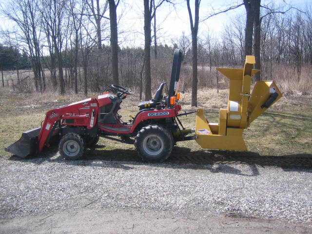

You might have to cut down the PTO shaft a couple inches for the GC2300. The shaft supplied with mine was too long, not allowing the the 3PH to fully raise.
*edit* or you may not have to with the QA on the back

Your got it. I would definitely have to take a couple inches off, if I weren't using the QH!
