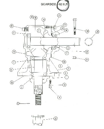

Sandy this is a picture of a 40 HP King Kutter gearbox showing the shear bolt and the circle clip that keeps the rear of the PTO from coming off if the shear bolt breaks.
Good pic pineridge!
