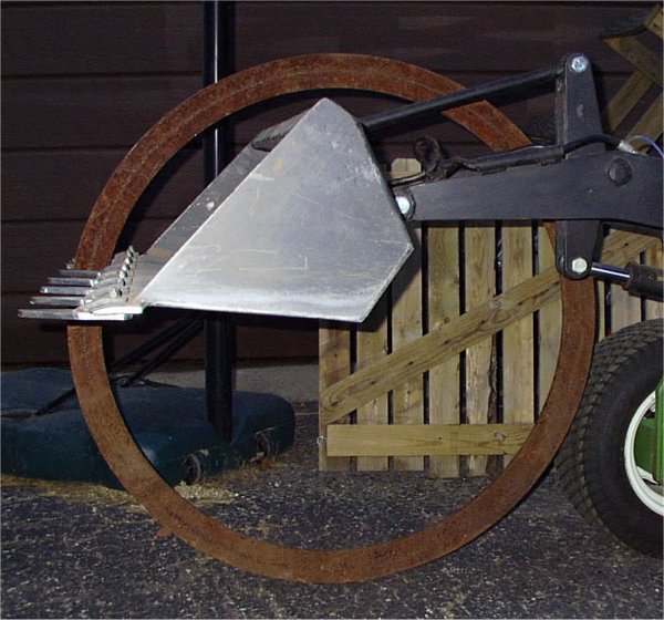

Here is a picture that you might be interested in. The grapple is similar to what you have built.

Moss I sure am looking forward to you getting your grapple done. I really wouldn't suggest anyone building a grapple the way I did. Hind sight I think that there would be much less welding, less material and labor to build one the way Power-Trac does. Mine seems to work just fine it just took about twice as much everything than it should have.
