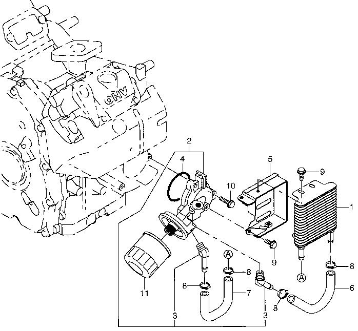

While running through the Robin parts manual to figure out which oil filter that I needed, I ran into a picture showing the oil filter/cooler arrangement on the EH72 (PT425 engine).
Since the engine is essentially the same, all the parts should fit... and the more cooling the better.
Does the manual picture resemble the PT425 arrangement at all?
