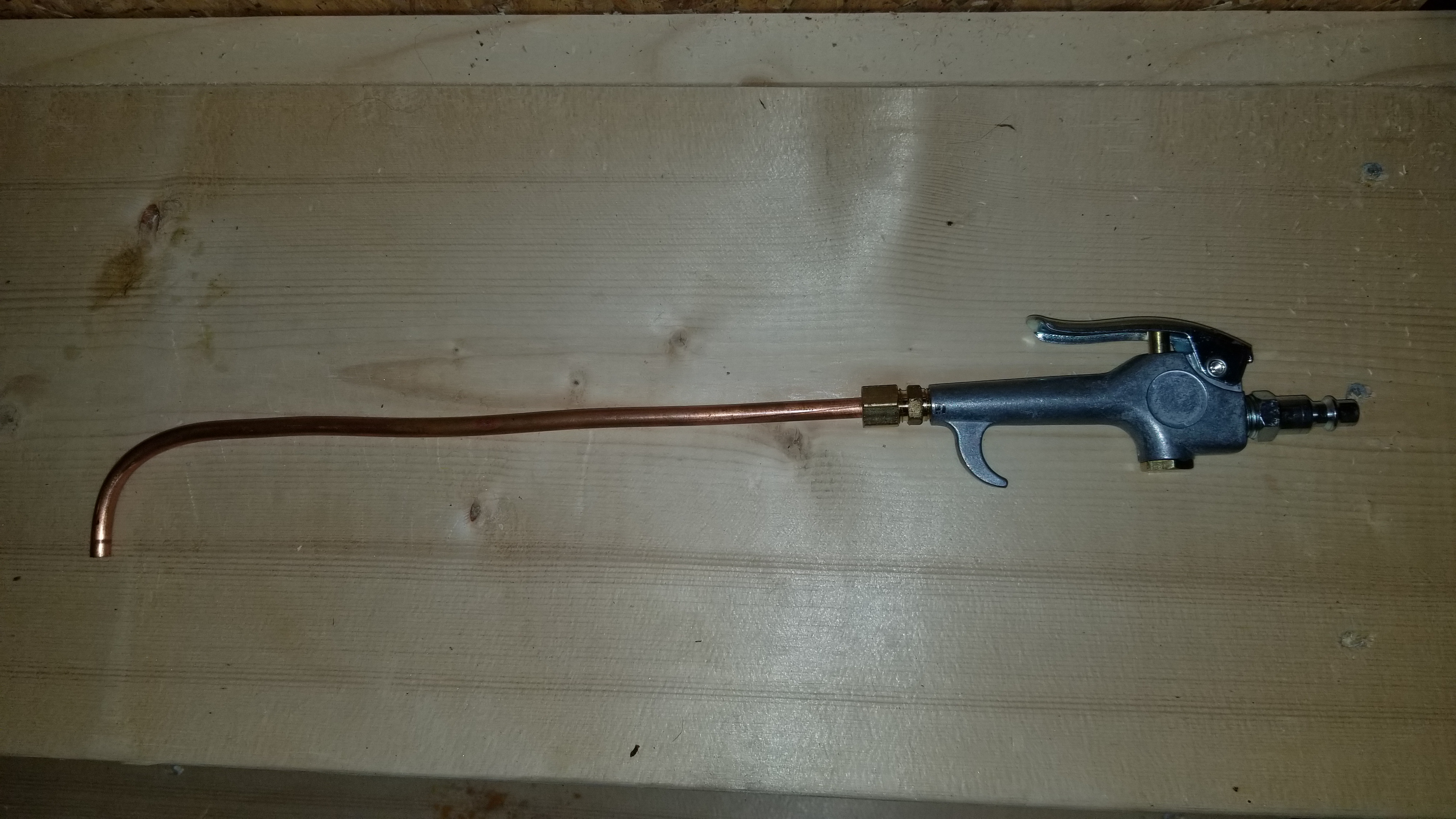

I also made a handy little tool out of a piece of 3/16 copper bent at the end, a compression fitting, and a blow gun to clean out the cooling fins without taking the shroud off. Temps are still running a little high for my liking, so a full oil and filter change are next. Its a little grimy under the shroud, so I was thinking about washing it. Engine cleaner and a hose? Pressure washer? Please tell me there is a drain so that that tub doesn't fill up with water....

There are lots of drains in the tub.
I use a pressure washer, once a year or so. I do take the precaution of having the engine cold, and taking the air shroud off so that I can spray up as well as down, and it also improves the draining. In between, I use the compressed air trick on an as needed basis (weekly/bimonthly). For me, with my dust/chaff, that's all I need. Others here do use detergents. There are some nice products for cleaning AC evaporators that you spray on, and let drain through. It's simple, and solves the problem if you have sticky gunk in there.

One caution on the pressure washer is that it will bend fins of the hydraulic oil cooler. Just be a bit gentle.
Agreed with Peter on all the rest. I pressure wash with a bit more frequence, twice to 3 times a year, but I have either mud or dust with all the clay. I also built a 90 degree attachment for my pressure washer to get in the engine oil cooler fins.
Oh, let the engine dry before you move it (assuming it is dusty out). It was an idiot move on my part, couldn't figure out why it was runnign so hot after a good washing on a hot and dry day. All the dust turned to mud in the fins.
