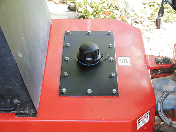

duane: <font color="red"> John, after you have worked your 1845 machine hard, could you post some hydraulic reservoir temperatures along with the ambient temperatures. Curious to see where the bulk temperature settles out at. </font>
I haven't gotten in enough seat time yet for anything definitive. At the moment I'm running the hydraulic cooler fan backwards (cause I accidentally hooked it up backwards and this gives me a chance to test whether the concept will help reduce chaff getting into the engine compartment) which kind of skews things toward the high side. I think the highest I've seen was 140 degrees at about 70 degrees ambient.

</font><font color="blue" class="small">( I'm running the hydraulic cooler fan backwards (cause I accidentally hooked it up backwards and this gives me a chance to test whether the concept will help reduce chaff getting into the engine compartment) )</font>
John,
That's something I've been wonderin' about, too...but then I complicated it (on the design napkin) with a dpdt switch (or relay) so the fan could be reversed "for cleaning"...now you've got me thinkin' /forums/images/graemlins/shocked.gif that there would be real cooling benefits to permanently running it backwards.
/ PT Rises from the Ashes #52
<font color="red">( I'm running the hydraulic cooler fan backwards (cause I accidentally hooked it up backwards and this gives me a chance to test whether the concept will help reduce chaff getting into the engine compartment) )
</font>
I will be interested in the results. I have no problem with chaff since I taped screen over the rear panel of the enclosure and changed to a side discharge mower deck. I get some chaff on the screen material in a circle that exactly corresponds to the intake for engine radiator air cooling but it simply brushes off. I have not had build up on the hydraulic oil cooler since the changes.
One thought about running the fan reversed--if you do get chaff it will be much more difficult to clean.

</font><font color="blue" class="small">( if you do get chaff it will be much more difficult to clean )</font>
Good point...Ahh...Now, with a short wood/metal framework over the top of fan with house screening attached and held on with strip magnets (fridge door style) we'd keep positive pressure in the engine bay(keeping it cleaner) and maybe a cooler (??) environment for engine...
...Not sure if the "clean" factor would be worth the effort , but, a cooler operating environment for the motor would be a worthy goal(??) /forums/images/graemlins/wink.gif
/ PT Rises from the Ashes #55
<font color="red"> but, a cooler operating environment for the motor would be a worthy goal(??) </font>
It seems to me that what is important is that you have cool clean air going to the engine air cleaner and to the engine cooling. On the diesel power units both the air cleaner and the intake for engine cooling are located at the back of the tractor. I think there is a good chance the temperature of the air there would be increased by running the fan backward.

Bob999:<font color="red"> I will be interested in the results. I have no problem with chaff since I taped screen over the rear panel of the enclosure and changed to a side discharge mower deck</font>
Guess it's about time I added something here since I seem to have started this discussion about chaff filtering. /forums/images/graemlins/tongue.gif
My mowing is probably a bit different from most, especially this year since I just started the mowing season last week /forums/images/graemlins/tongue.gif
Let's start with a picture from yesterday after 1-1/2 hours into brush hogging an unmowed field. And not a terrifically heavy chaff day at that - the growth didn't include much dry grass es- mostly mature goldenrod etc.
<font color="red"> I get some chaff on the screen material in a circle that exactly corresponds to the intake for engine radiator air cooling but it simply brushes off. I have not had build up on the hydraulic oil cooler since the changes.</font> I say a light chaff day yesterday because I only had to brush off the rear screen half a dozen times in the 1-1/2 hours - instead of the usual double that.
<font color="red">One thought about running the fan reversed--if you do get chaff it will be much more difficult to clean.</font>
I'm not sure it makes much difference - once I determined my cooler was full of last years chaff, way deep inside where you can't see it, it took nearly an hour with the hose to wash it clean. That's from last years stock non-reversed fan setup.
Sedgewood

bmkar: <font color="green"> Good point...Ahh...Now, with a short wood/metal framework over the top of fan with house screening attached and held on with strip magnets (fridge door style) we'd keep positive pressure in the engine bay(keeping it cleaner) </font>
Kind of like this? What you see is a screened "house" (with a solid roof - screens on sides only) taped on the hood. Inside is a piece of furnace filter material lying atop the fan. In the center is a trumpet bell shaped piece of aluminum I thought might redirect the flow.
<font color="green"> ...Not sure if the "clean" factor would be worth the effort , but, a cooler operating environment for the motor would be a worthy goal(??) </font>
Blowing 150 degree air over the engine doesn't seem to help the cooling much. It's running hot as ever.
