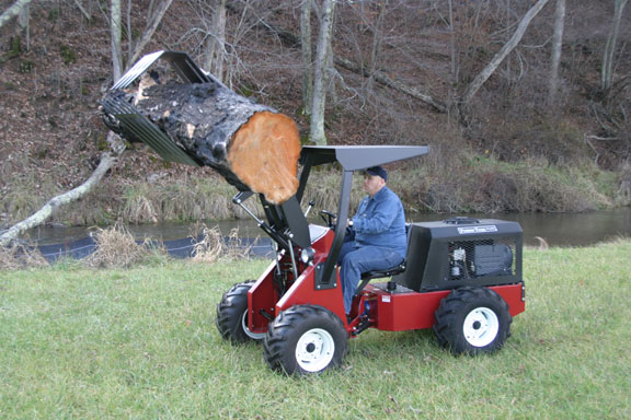

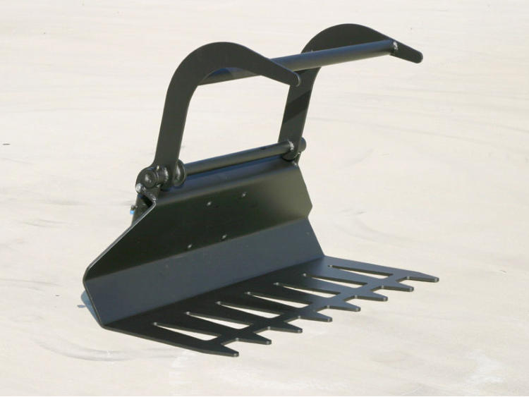

For the record, I went with the grapple bucket. It is working out great and seems well made. I weighed it and found it to be 370 lbs. The shipping weight on the utility grapple was 380 lbs, so basically the same. Terry at Power Trac stressed that the utility grapple will bend if you try to crush with it and by looking at it's flat design I can see it bending if abused. The 1430 model grapple bucket seems more forgiving being it has a hyd cyl on each side and four bushings across the top shaft to keep it in alignment. Terry did say not to crush things with it also. Time will tell.
I think you made the right decision between those two. The flat design of that grapple sure does look like it would easily bend but that would depend on the steel used. Your bucket grapple looks solid. :thumbsup:

If I had an unlimited budget I would definitely have both the grapple bucket and utility grapple. I thought the grapple bucket to all around more useful therefore the better deal and it works well when you use it like MossRoad explained (dump bucket forward and face down into pile then close grapple). But even if I don't get a full grasp-load-pile, the Power trac moves and cycles quickly to load my dump truck that it doesn't hurt to bad to have a smaller pile each trip.
I thought if the utility grapple jaws were made out of spring steel it would bend and return, but Terry said no and you can't use it to crush. I called the guy that has the ad for a utility grapple on the PT webb site and got the impression he was selling it and replacing with a new one for his business. I have attached a pic from his business web page of the way he used the UGrapple, make of it what you will.

On that utility grapple you seen, did it look like the one in the ,Attachments for Other Equipment, picture on the Power Trac website? Their website has type styles of the utility grapple. I think I like the look of that one better, the one in the Attachments for other equipment.
Did you notice the cylinder is way to one side? Which may cause distortion if you bear down on an uneven object. I think the other pictures are current with a center cylinder
Yeah, it looks like it would cause binding with it being over on one side. I'll ask Kristy if there is any difference in the two utility grapples, maybe this week and we'll see what she says?
