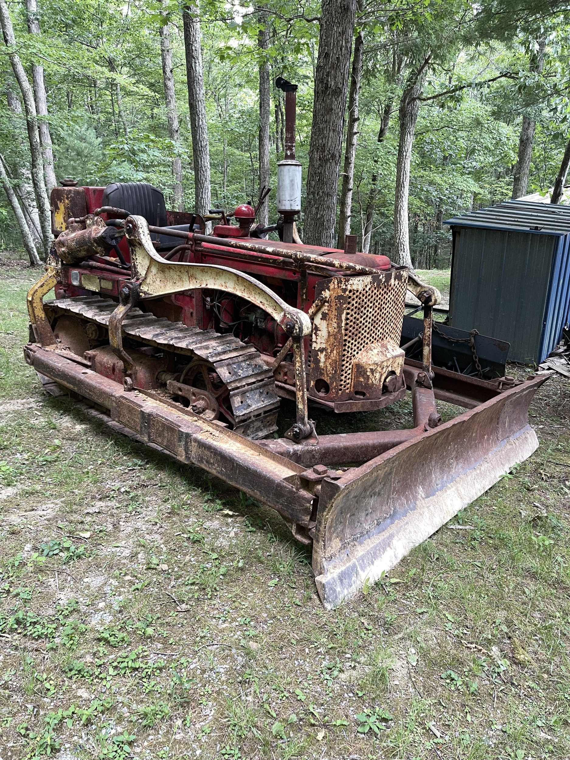

We'd love to see some pics of the crawler. ;)
I love it. It’s a bit over my head but I’m learning more about it as I find books/manuals. All of the running gear was rebuilt and it’s really in great shape. My neighbor/friend works for a local mom-and-pop equipment place and does most of their rebuilds on dozers and such. He did the finishing touches on it before he delivered it to me. (His boss/shop owner owned the Crawler, passed down from his late daddy, who along with dad’s brother had done all the rebuild a few years back)

My back hurts by just looking at it.

Love the seat... throne of power! 🤣
Sometimes I pretend my little PT425 is such a beast! 🙃
