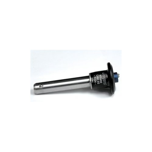

I fold my seat up often, so I would try to use one of those pins with the tumb button in the middle to release the spring loaded ball bearing deals. What are those things called, anyway? :confused:
Not quite the same thing, but I tried a spring plunger. http://www.mcmaster.com/itm/find.AS...DtlLink&fasttrack=False&searchstring=8482A341 On my 425, the seat has to be tilted forward to open the cover for refueling, so I drilled 2 holes - one to hold the seat up, and one to hold it down. The outside thread was 5/8", with a sliding pin of about 5/16". It didn't last long before the pin bent, then finally broke off. They are available in larger sizes, but as they get fatter,they get longer and might get in the way. I've got a vague idea of making one that uses an external spring so the pin can be fatter.

I was thinking of something like this...

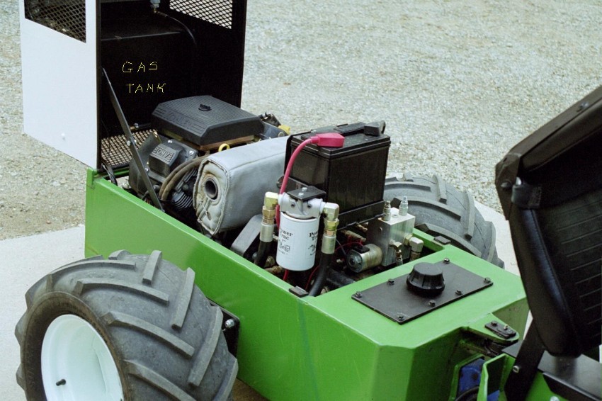

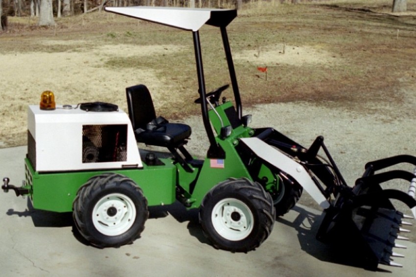

Every time I fuel up, I fold the seat forward so no fuel splashes on the seat. The filler opening is only about 6 inches from the seat back. I check the hydraulic oil level every so often, so I need it then, too.
Fortunately, I have a Kohler model built 2/4 with the steel fuel tank behind the hydraulic fan. By using a large funnel no gas ever gets spilled.
Since I have a rubber hose on my grease gun, the grease fittings are easy to reach.
By articulating the PT fully to one side or the other the hydraulic fill is easily accessible.
If it is hot and sunny, I park the PT in the shade or facing away from the sun.
Also, the tail of my seatbelt was way too long, so I adjusted it to the minimum length that would ever be needed and cut off the excess. A burning match melted the nylon at the cut edge to prevent fraying.
PS: When my OEM battery dies, there is enough room for a 1000 AH car battery!!

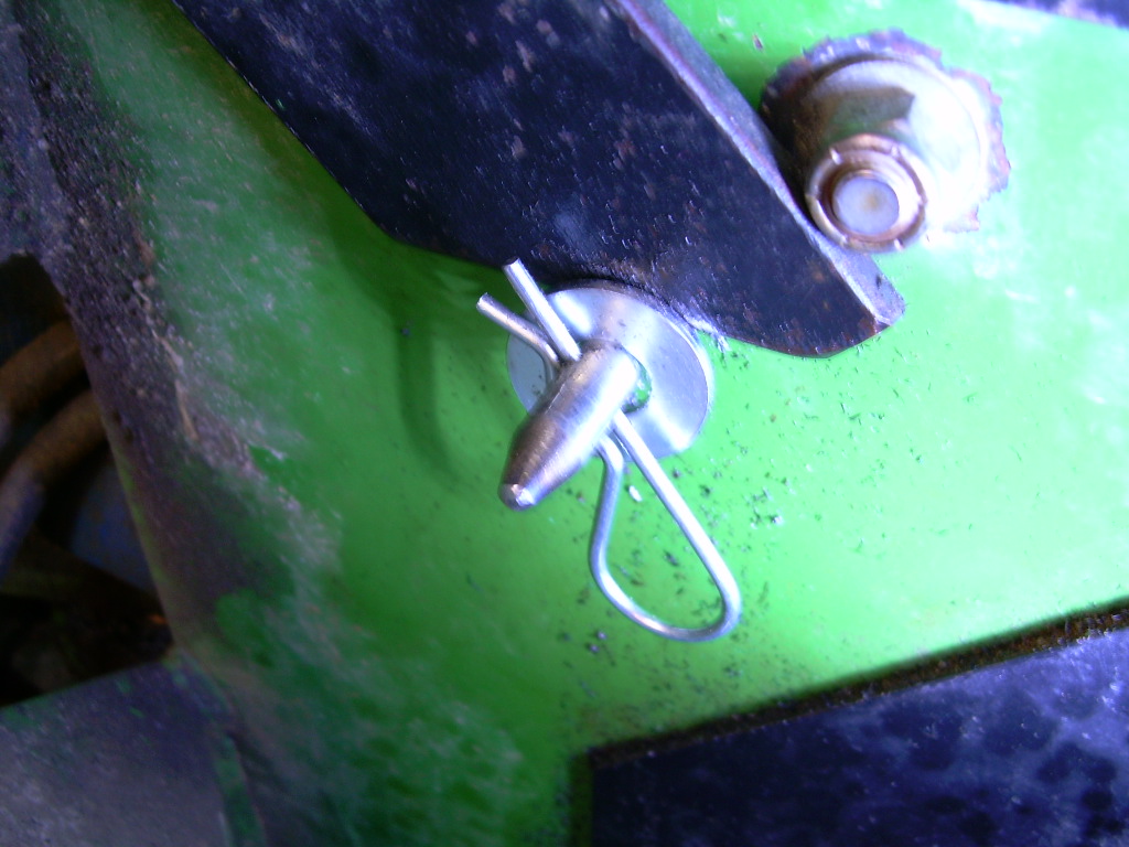

Did you remove the top tunnel cover? I have the left cover off to allow me to grease the fittings behind there.
I realized that the nut was too hard to take off and access was required too often, so I drilled a hole in the bolt and put a clip through. I don't know the name of the clip, but I attached a picture. This is a little easier to use.

...I don't know the name of the clip, but I attached a picture. This is a little easier to use.
That's the exact combo I was talking about earlier Bob. :) That's a cotter pin as well... I think it's known as a hair pin cotter.
