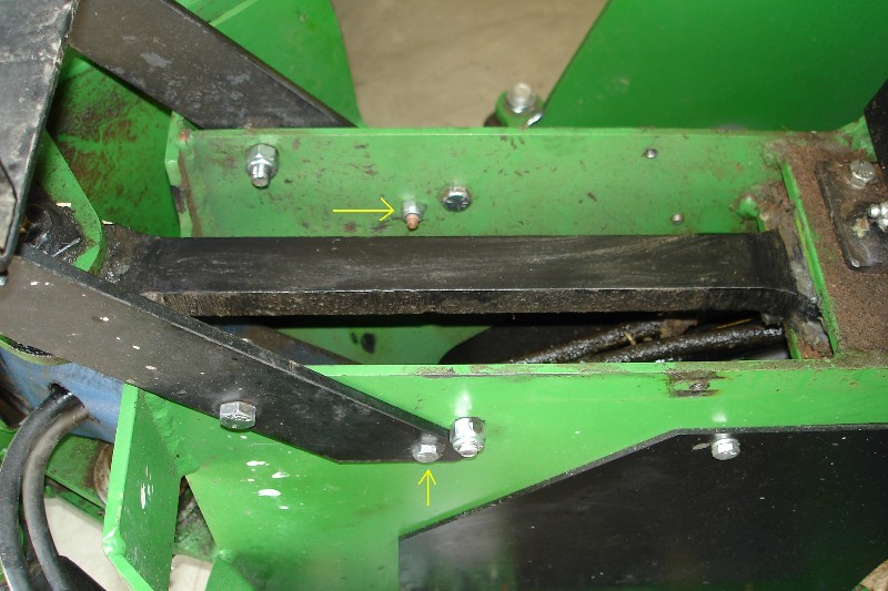

Last week while moving some large logs, the front of the grapple bucket found a low cut tree stump that I had overlooked. My forward speed immediately went from medium to full stop! Well actually the PT-425 made the full stop! Being snuggly seatbelted in, I continued forward strapped to the now folding seat! My head hit the ROPS bar, my belly got punched by the steering wheel, and both knees slammed into the steel dashboard! My head and belly have since recovered, but it still hurts to kneel!
For over three years I have worried and wondered about why Power Trac provided a folding seat! With the folding seat the seatbelt will keep me from falling off the seat laterally, but the seatbelt is rendered completely worthless if my movement is forward!! I can reach the grease fittings and hydraulic tank with the seat down, and seldom ever fold the seat forward except when washing it at the end of the day!
My seat no longer folds! I installed a ¼-20x1” bolt through each seat arm to hold the seat firmly in place and prevent it from folding. If I should want to fold the seat, I simply remove the tunnel plate, and then the bolts and aircraft nuts to allow the seat to fold. My head, belly, and knees are happier already!!

Good safety improvement. I always figured that PT was just trying to keep you from launching out of the seat into what ever attachment is on the front. Could you put a long 1/4 rod through the holes so that you would not have to remove the cover to tilt the seat.

Sure! I didn't have a rod, but I did have some bolts!
However, the rod would not have the shear strength of the properly tightened bolts. I'd hate to hit something again, and have the rod ends bend releasing the seat to fold forward anyway!! For the few times that I foresee wanting to fold the seat, I think that the bolts would be the preferred way to go!!
As you know, I have no fear of PT Pucker, but that is another instance where the folding seat acerbates the situation by dumping you forward onto the steering wheel just as you are trying to regain control!! A snug seatbelt attached to a solidly mounted seat will hold you in the proper position to effectively control the PT in nearly any situation!!
