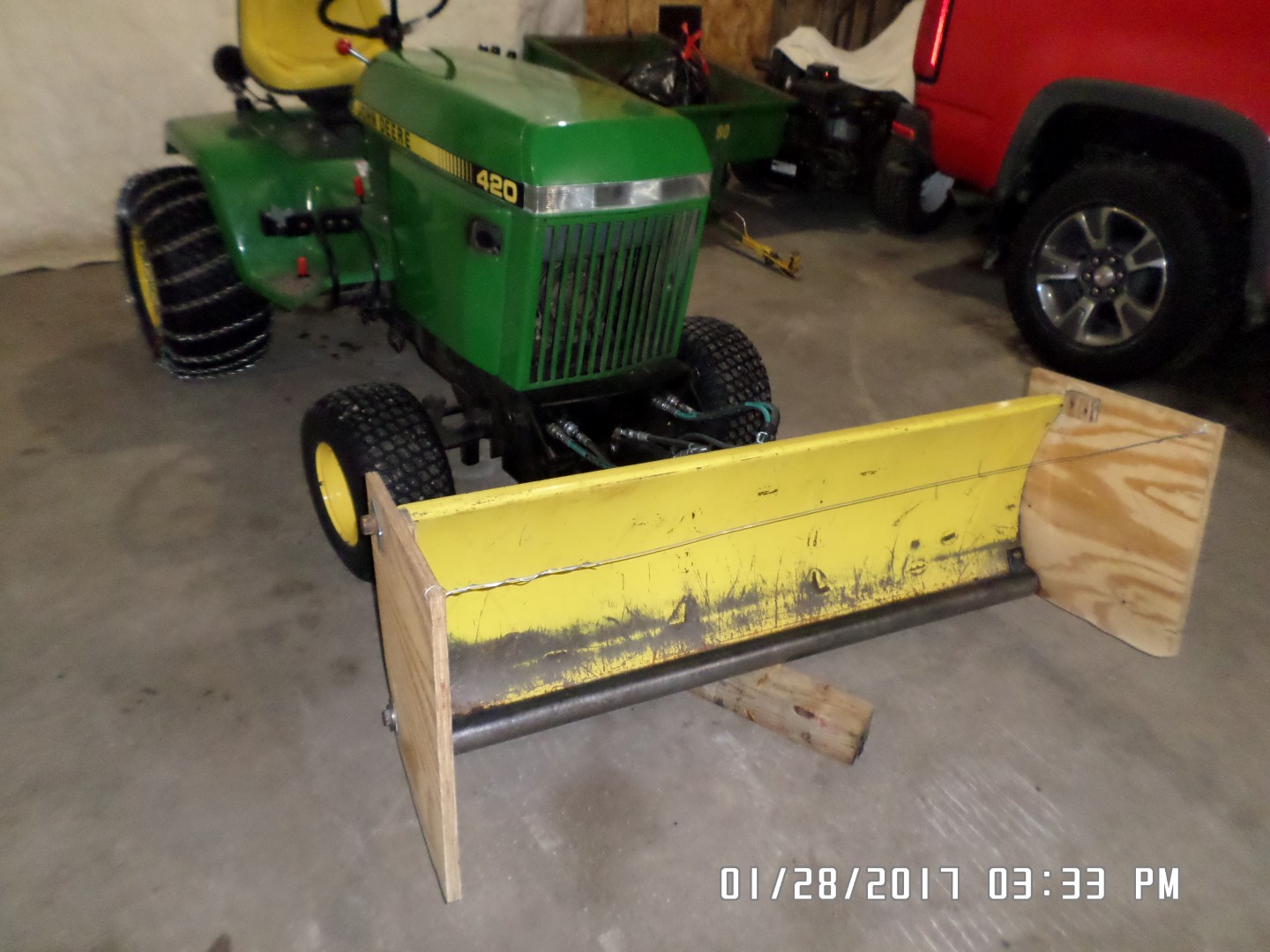

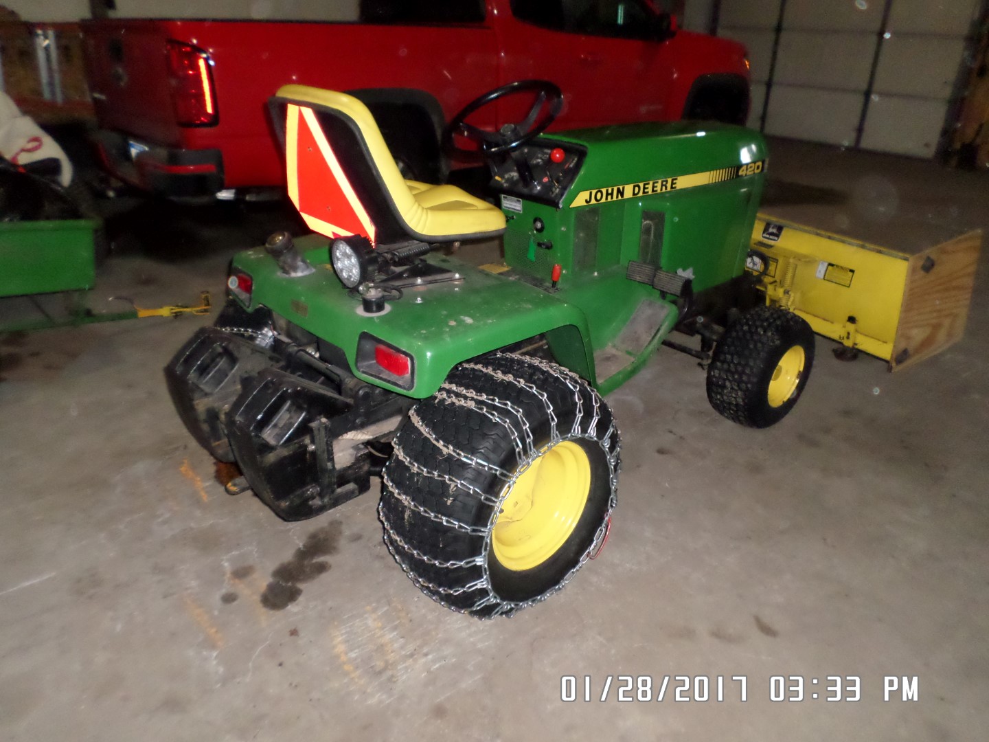

I just have a 54" blade on the front of the JD 420 that I turned into kind of a snow push box. If I buy one next summer, it will mostly be used in the Spring/Summer/Fall, but needs to do light snow duty especially in early winter when I am building my base. I could get buy with a lighter duty cable or strap type chain, especially if the unit had all wheel drive. Pushing is not sometimes the worse part, it's backing out of the pile a little up hill on ice or wet slush that sometimes gets my JD stuck. I would be going with the turf tire like on the JD, that seems to work best with just about any type of chain unless you wanted to go studs. Thanks..!!! [ here is20hp a couple pictures of what I want the PT-425 to replace.. 4 AllisC 100 pound suitcase weights on back, chains on rear, and cheepo push box... 20hp Onan hydrostatic 2 wheel drive with two speed locking rear axle ]
