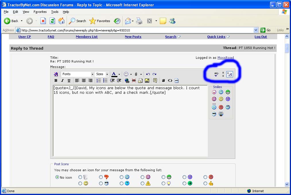

J_J,
I hit the quote and get the screen that is attached... I circled the spell check in blue. Do you get a different screen when you hit the quote button?
David,
I also can not get the spell check to show up.
PJ

I finally found the spell checker by clicking on
User CP
Edit options
Miscellaneous options
Standard editor
There are three options,Basic editor, Standard editor, and Advanced options.
After all this I had to download ieSpell but I do have all the icons , some on the right and on bottom . The spell checker now works.
