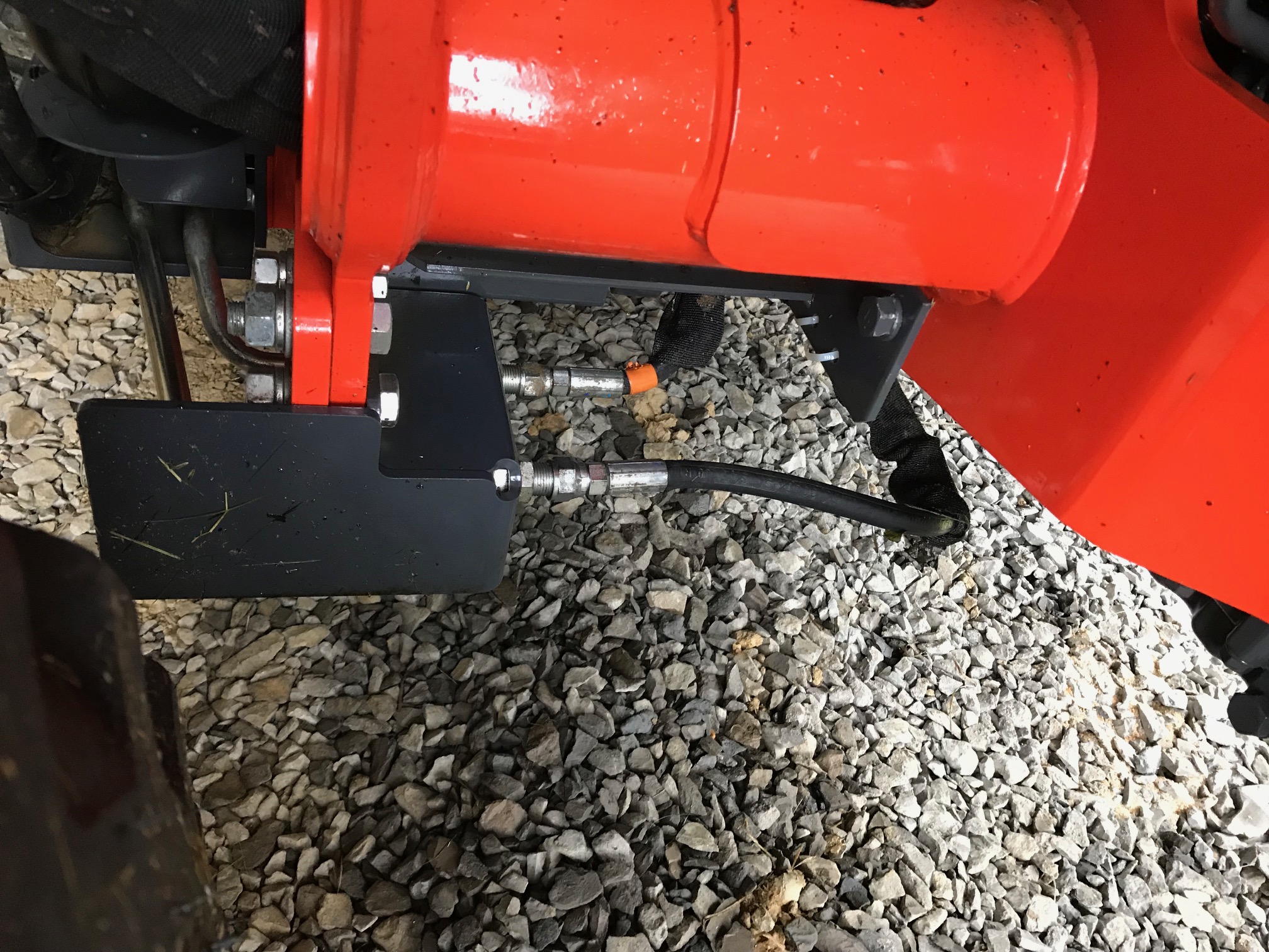

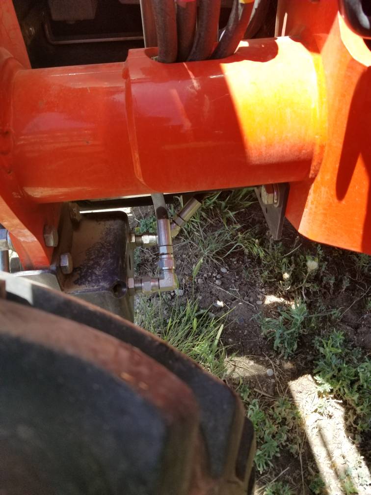

I got mine also the first time that I took my L6060 into areas where I could not see all obstacles. This, even though I was aware of the vulnerability and was paying attention. Simply did not see the obstacle.
I shut mine down immediately and fixed it where it was, loosing less than a gallon of oil.
Later, I installed 90 degree elbows similar to those in Fallon's photo above. The 90s reduce the vulnerability but the lines are still vulnerable.
The third function system, though functionally excellent, is not well executed as the lines are much too vulnerable and the switch is a joke.

In my case, the obstacle broke the fitting where one of the lines passes through the bulkhead behind the front wheel. Oil sprayed beneath the tractor and I immediately noticed it spraying out beneath the tractor to the left.
I shut it down immediately and repaired it where it was, in thick brush/grass and over 1/4 mile from the barn. I lost nearly 4 hours doing so and making a couple of trips to my CNH/Kubota dealer, which, fortunately, is only five miles away.
Subsequently, I replaced the straight fittings with 90s and rerouted the hoses from the factory position to a less vulnerable location but the hoses behind the front wheel remain vulnerable, albeit, somewhat less so.

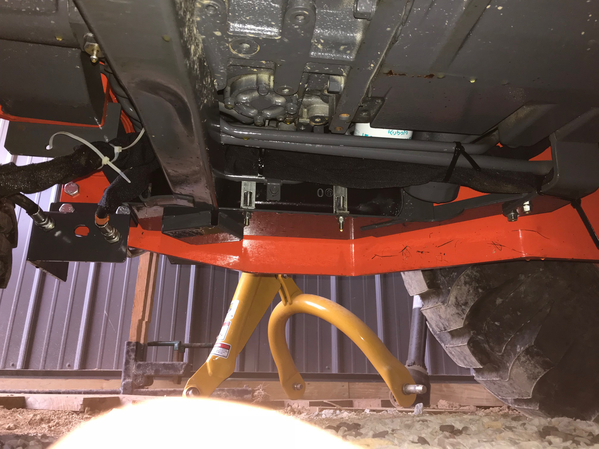

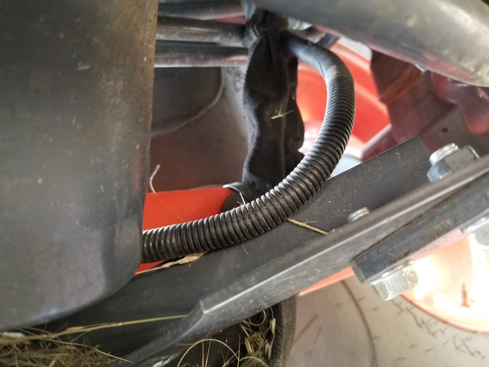

Ok these are pictures I took before I had a chance to wash it but good enough.
I'm not sure why but the resolution was to simply tighten the nut and I had no issues finishing my mowing today. I lost 6 gallons of clear liquid gold known as Super UDT2 and had to take out a small loan to replace it. Thankfully my dealer has been pretty good and their prices on parts including the fluid have been right on par with everyone else including Messicks. I am very surprised tightening the nut resolved the issue unless the hose just vibrated loose and wasn't tightened down to start with. However, I did bottom out on a stump that somehow the loader grapple and axle missed but the support under the fuel tanks caught. I'm not sure if it hit the lines, because I would have thought if they would have been hit things would have been even worse.
In any case, I definitely need to get it protected before the hose gets ripped off the side and I see dollar bills start spraying out of the bottom of the tractor.
Edit: I should mention in the picture the black ties were from the dealer. The white ties I put on there before I started mowing to try to raise those lines a little so they would be less prone to catch.
/ Protection of third function lines on L60 #11
mljenkins,
Thanks for the photos! For some reason I was thinking the hose was "torn" off near the front of the loader. Anyway, at that location, it will be an easy fix to protect them.

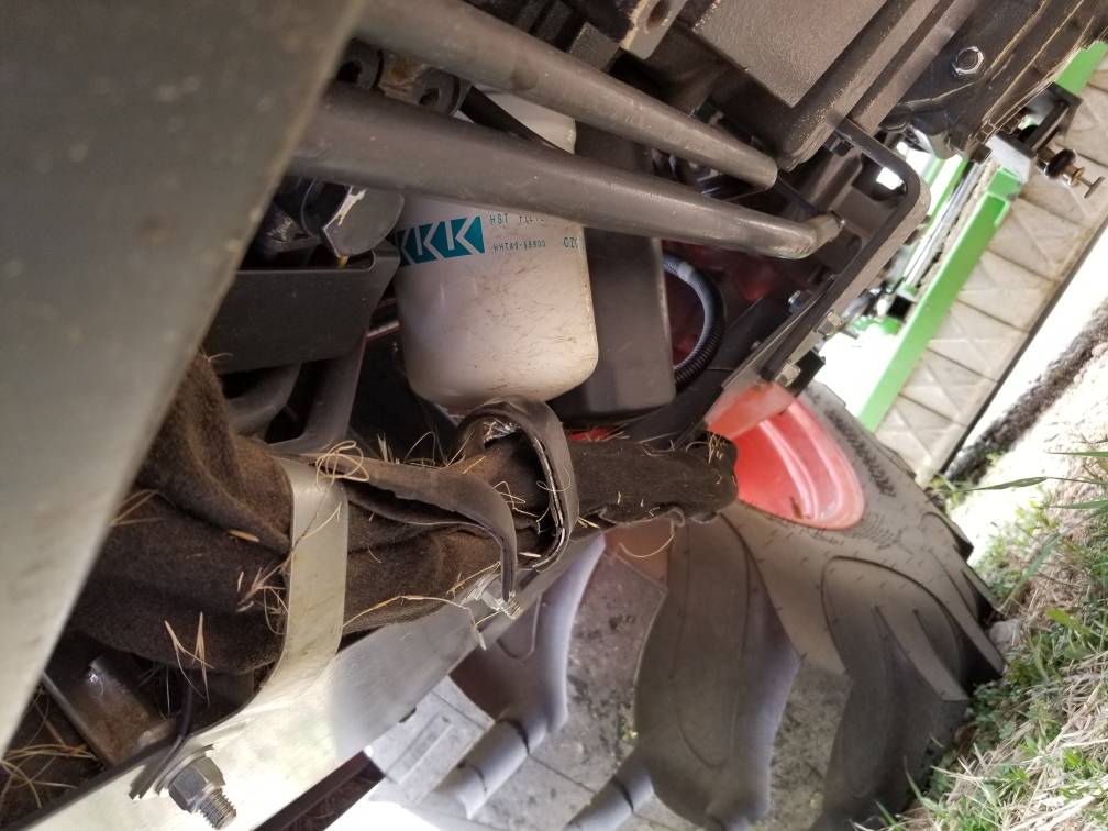

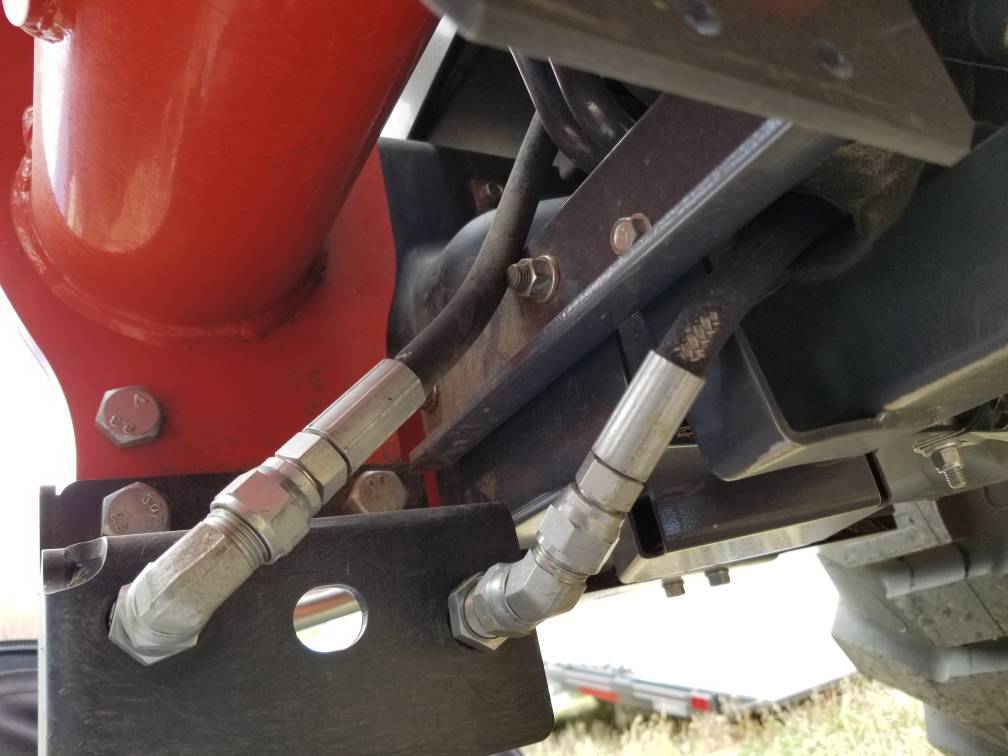

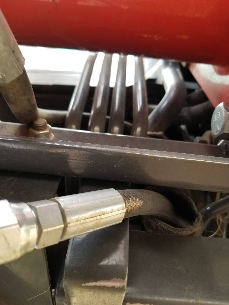

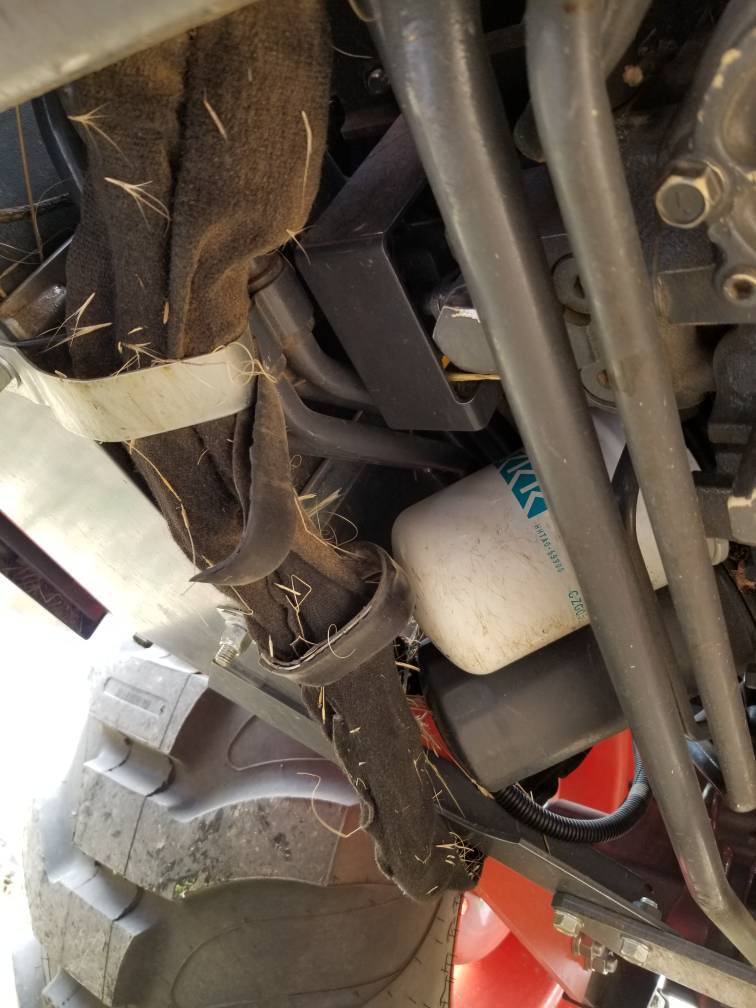

Grabbed some photos cleaning things off today. Just over 200 hours & have the new filter & fluid to take care of the grey one. The steel the fittings are comming out of is plenty beefy, so we could mount something to it.20180622_125802.jpeg20180622_125849.jpeg20180622_125909.jpeg20180622_130007.jpeg20180622_130222.jpeg
#13
There is a hole in that beefy plate that another poster used to mount his setup although I wasn’t sure how he supported it on be other side.
I do worry about mounting something just to that piece and whacking something to the point it bends everything there. But I think that’s probably the easiest thing to do at this point.
Has anyone ever made a skid plate for the bottom of these tractors that is easy to remove for service?

Well they guess the holes are in the plate under the tractor. I was thinking there was a smaller bolt hole on that plate. Seems it is sturdy enough to drill a new one though.

All I can think of when I look at those pictures - - WoW!!! I have WR Long third function installed by Kubota dealer to work the grapple. I have NOTHING anywhere close to what is shown in those pictures. All routed hoses are well protected and nothing - absolutely nothing - is on the underside of my tractor.
Those pictures show what we call - " A well engineered accident" just waiting to happen.
I can certainly see why additional protection is necessary.
