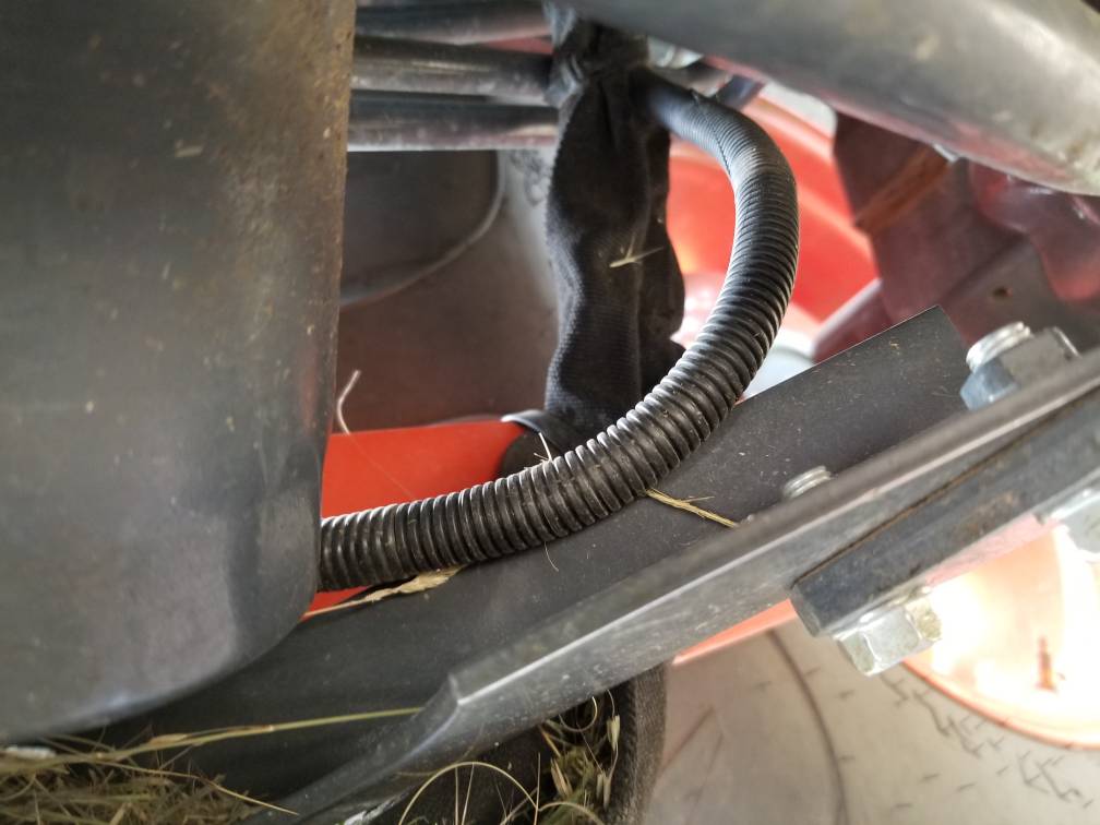

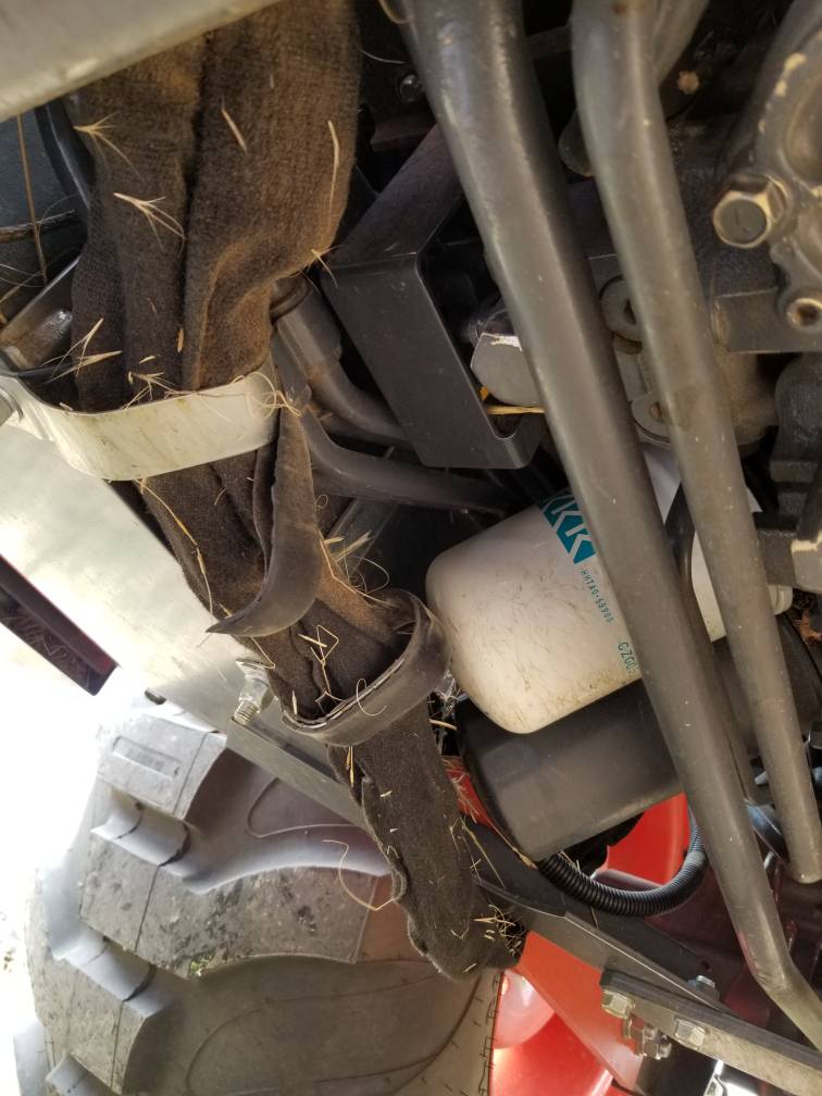

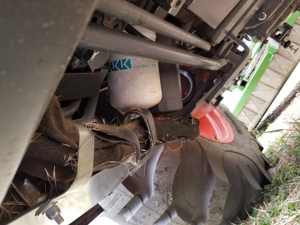

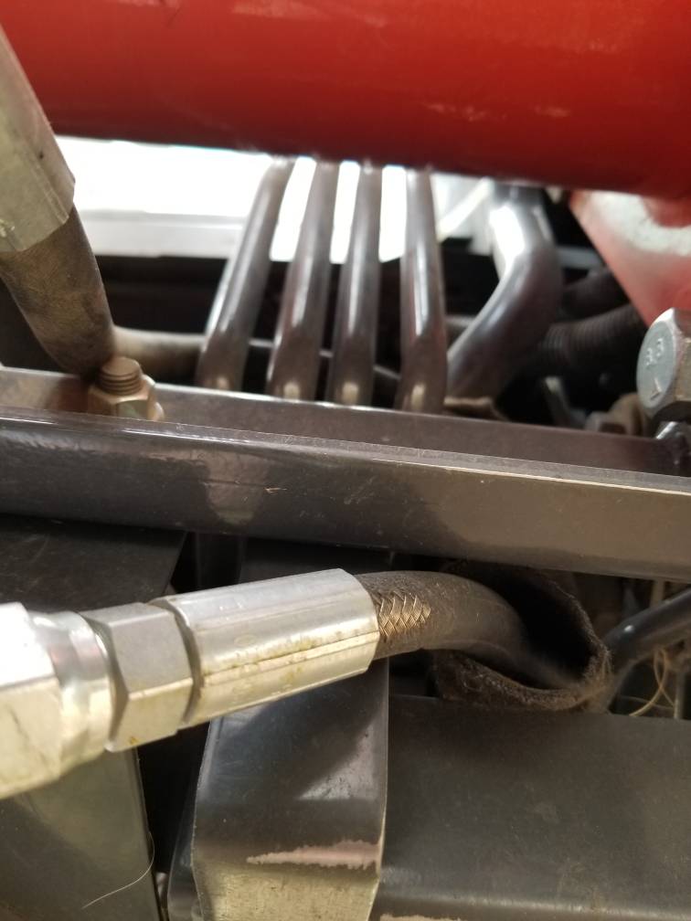

Grabbed some photos cleaning things off today. Just over 200 hours & have the new filter & fluid to take care of the grey one. The steel the fittings are comming out of is plenty beefy, so we could mount something to it. 20180622_125802.jpeg20180622_125849.jpeg20180622_125909.jpeg20180622_130007.jpeg20180622_130222.jpeg
There is a hole in that beefy plate that another poster used to mount his setup although I wasn’t sure how he supported it on be other side.
I do worry about mounting something just to that piece and whacking something to the point it bends everything there. But I think that’s probably the easiest thing to do at this point.

Well they guess the holes are in the plate under the tractor. I was thinking there was a smaller bolt hole on that plate. Seems it is sturdy enough to drill a new one though.

All I can think of when I look at those pictures - - WoW!!! I have WR Long third function installed by Kubota dealer to work the grapple. I have NOTHING anywhere close to what is shown in those pictures. All routed hoses are well protected and nothing - absolutely nothing - is on the underside of my tractor.
Those pictures show what we call - " A well engineered accident" just waiting to happen.
I can certainly see why additional protection is necessary.

Actually, the "beefy plate" is itself vulnerable to damage. I bent mine the first season but the resulting leak was repaired by tightening the fittings.
To avoid down time, I bought a new one, swapped the units, repaired the damaged one and kept if as a spare.
