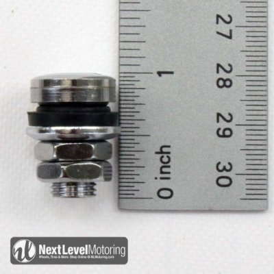

I have been planning on welding pipe or metal to keep my valve stems from ripping out. I have never had this problem but it has happened frequentoy to others. Before i put my expensive sealer in, i figured i had better do something.
Searching for metal valve stems, i found these recessed valve stems which might be a neat solution so I ordered them:
Amazon.com: Flush Mount Chrome Valve Stem System (Set of 4): Automotive
They are meant for fancy rims but might be a neat solution to the problem. I want to sandblast my rims but once i do, i will give them a try. Inflating the inner duals would be a pain but with the sealer, that should be a rare occurrence.

Just a word of caution if you decide to weld colars on the rims instead...
Welding on any rim with a tire mounted (even deflated with the bead broken) can have explosive results. Always completely dismount the tire first.

These are not normal metal valve stems but recessed metal valve stems
I just test fit one on a beat up spare rim I have and it looks like they will work. I can not say they will not leak yet but there was enough clearance that the cap nor the nuts hit the rim.
After I actually ry them, I wll let you know how they do.
Ken

Now the big question is, can i remove the valve stems from these in order to add the tire sealer.
Ken
just checked to see - the internal valves in the stems look like they can be removed just like normal stems

Do you need a special air chuck to put air in the tire?
/ Protected Valve Stems
No, but you need to thread on an extension tube before you can add air. The extension has a piece of metal in it that presses down on the internal stem when you press down on the extensions internal stem with your air chuck.

I have been using them for about 7-8 months now in 4 of my tires with no problems. Ia m glad I installed them. But these tires now have the bullet proof sealer in them so I have not had to add air. To add air, you have to screw in a supplied extension.

Just an update: I still have not had to add air to the tires because of the sealer. Before the sealer, I was adding air every week or so due to rim leaks etc. No issues with the valve stems but then I have not had to use them to add air.
