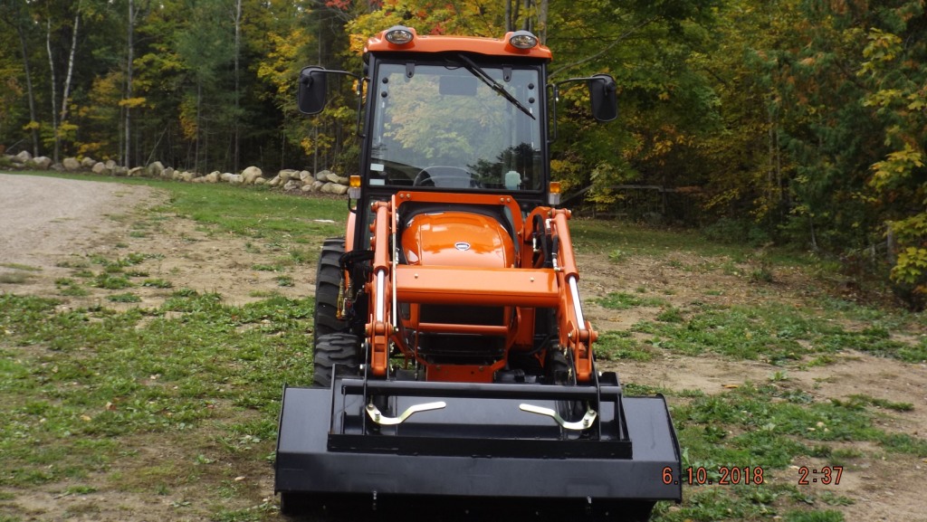

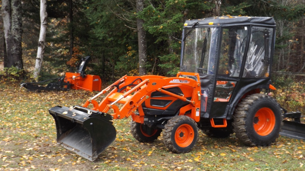

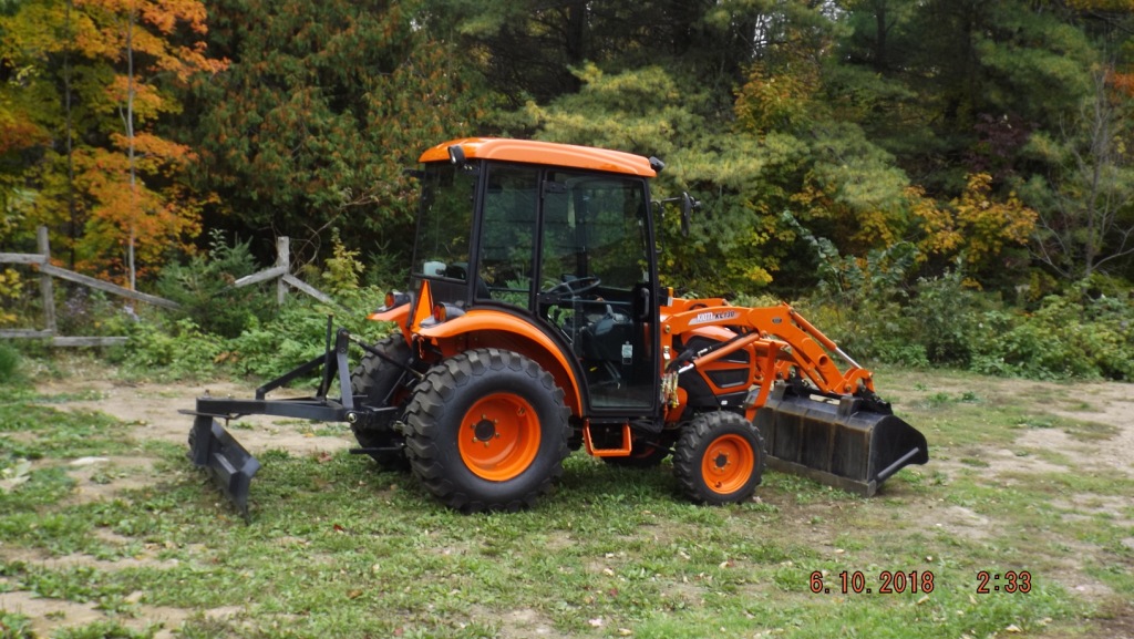

Update post. I had a hard factory cab installed this Spring. My machine is a lot quieter inside now but no AC. I used it this summer with the heater fans on and windows open and it was cool inside. Can't wait for Winter so I can blow in comfort with the heat. Bottom pic is the soft cab you will also see the Kioti 66" dual stage hydraulic front mount snow blower in the background.
