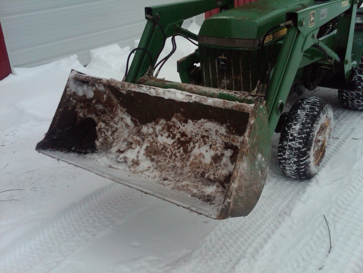

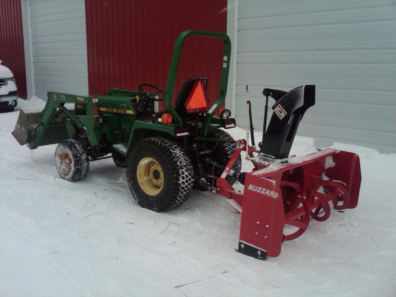

I'm a rear mount Snowblower advocate, because I still use my FEL to move manure during the winter...:)
