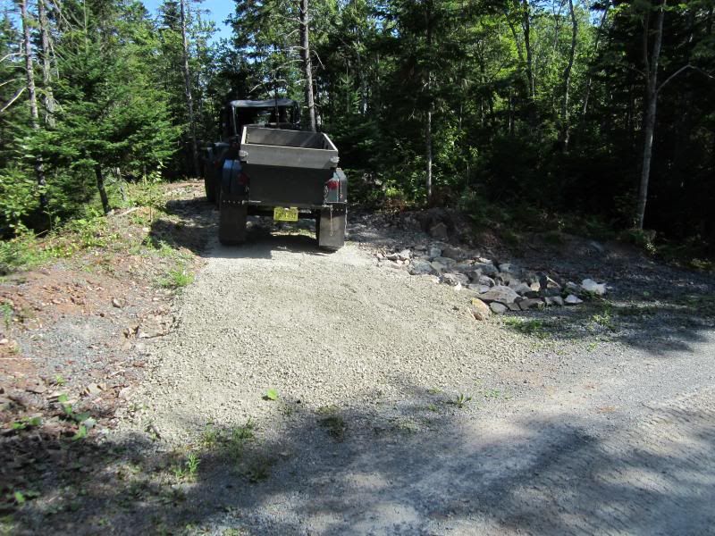

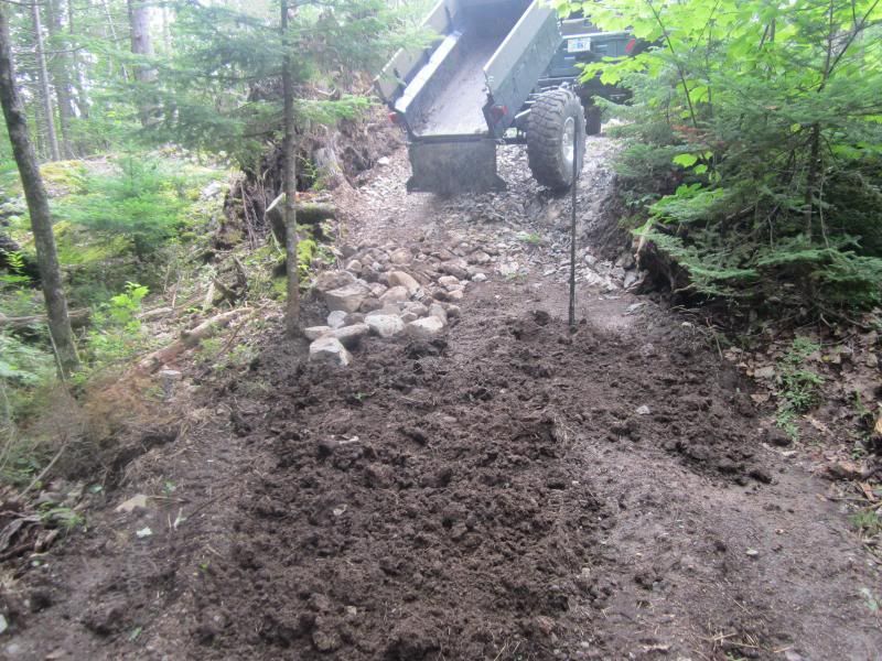

Anyway, back on topic. I looked over the pictures I've posted and realized I'd missed the load of rock spread over the swampy part. This is prob 10' wide and 1' deep. When I put the topcoat I'll narrow that up. The rock I put ahead of that comes from the besement walkout that I'd busted with the jackhammer, but never got a chance to move.
This corner's been swampy, so I went and got a load of shale... made a shale soup! LOL Seriously I hope it firms up before I drive over it again.

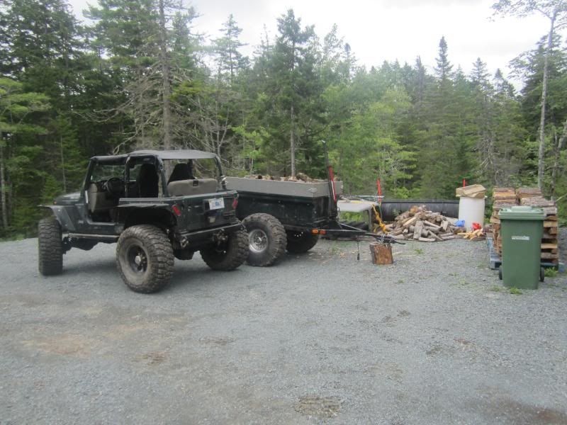

Load #3 in about a week. Made myself a "shelf" so i don't have to lift the shovelfulls. I'm throwing it down into the trailer.
My little helper : )

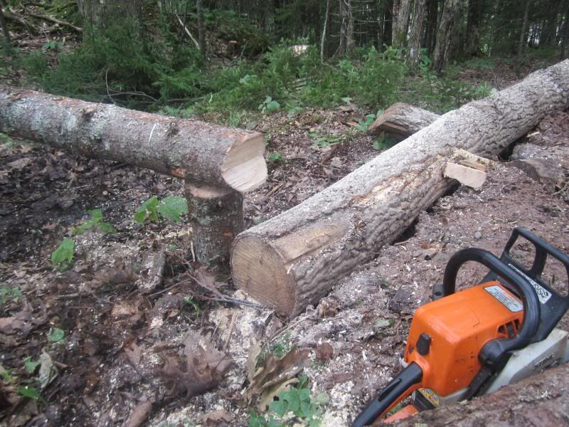

And lastly.....you SCARED me when you pulled that tall pine over with the winch and then with all that pressure on it you cut it with a chainsaw. DON'T do that, release the winch pressure THEN cut it. That little girl is too pretty to lose her father. Nuff said, have fun, BE CAREFUL
Thank you. Some call it OCD, I say I'm driven and detail oriented. LOL The plan is to have the trail graveled and I'll build a tow behind grader to keep vegitation at bay. Until then I have a Sthil Kombi I use in spots that grow (mostly ferns). I have very much noticed that once the sun hits the forest floor saplings spring up like mad. I went through and hand plucked a 50' section full of 1-2' spruce. Figgured if I just cut them they'd grow back.
Have another look... the cable was slack when I cut that tree. ; ) ... but thank you for your consern.

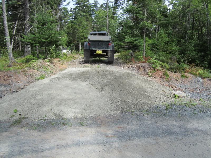

Got a bit of a second wind and started hauling gravel again. My goal is to finish this little section before winter takes hold... but man there was a good 2" of frost in the gravel pile today.
Put a decent dent in it
before (muddy mess)
after (7 loads later)
It's still wet, but very solid. There is one 3" culvert because that's what I had... but I've since got a couple 4" lengths, so may put those in too.
Cresting the hill! Not much needed on the other side! :)
