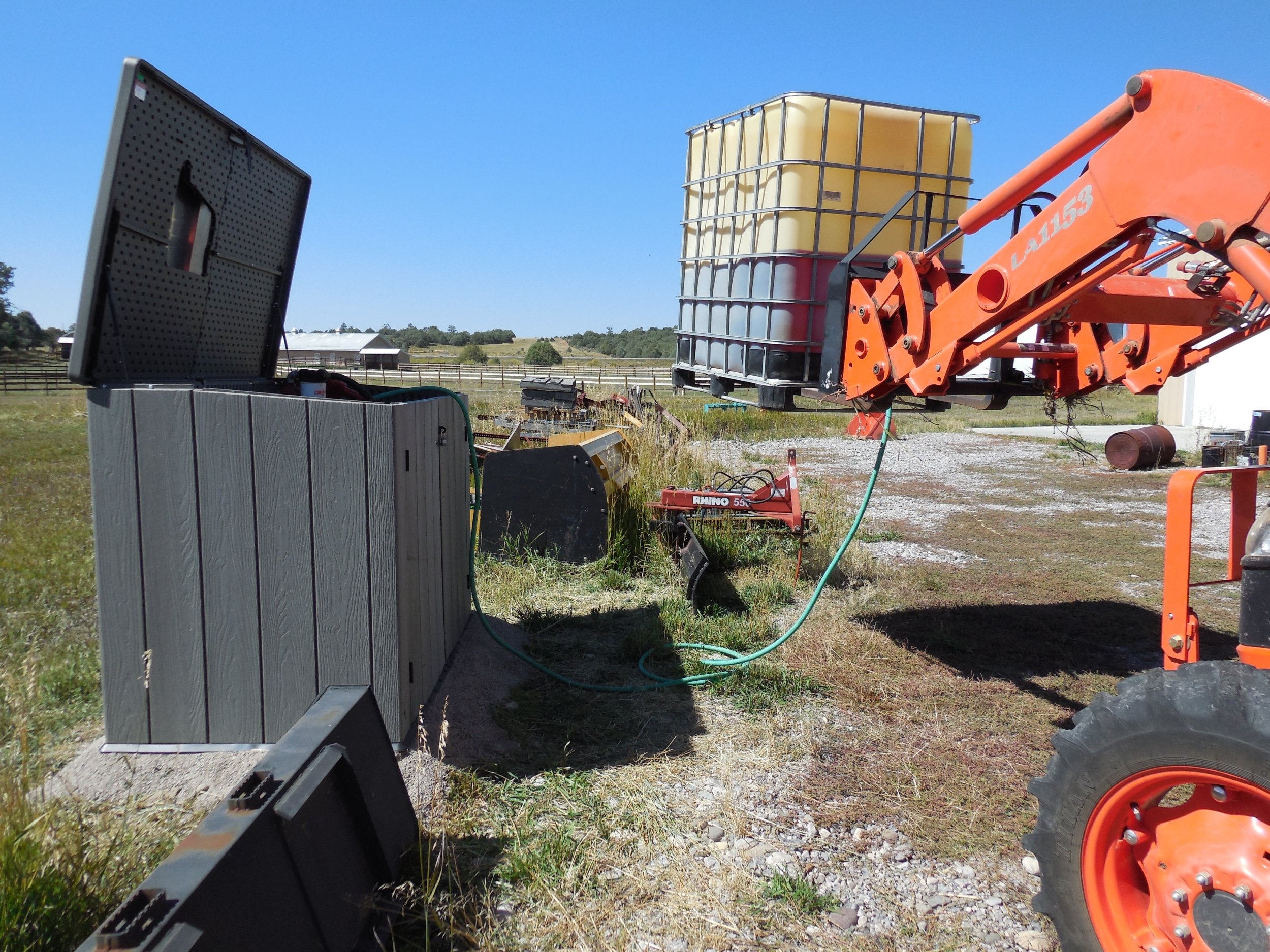

I may only use it every two weeks or so, but sure like my pump equipped 200-gallon Lee Agra tanks, this one in a modified trash can enclosure, being replenished from a tote.
With four totes I can go for a while before calling for more fuel to be delivered, which is also cheaper than buying it at a gas station. Call me lazy if you want, but my bad back doesn't like lifting 5-gallon cans, let alone 20-30 gallon propane tanks.

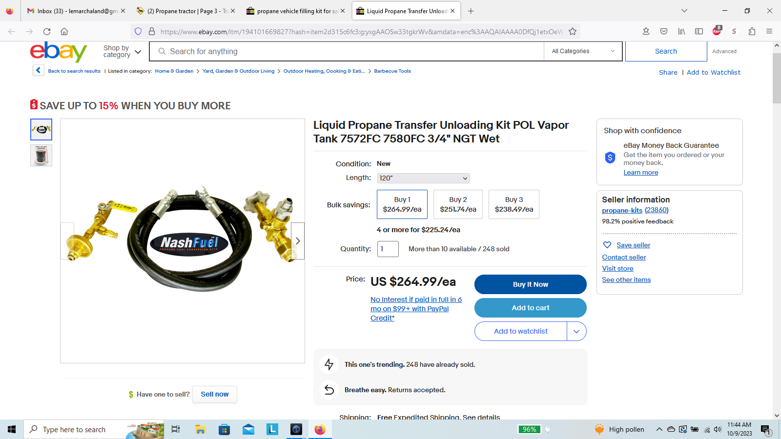

No you simple drive up to your supply tank and connect up and fill. Very simple and safe and easy to do.
One end of this type of kit fastens to the liquid withdrawal port on the main tank (supply) and the other to the tractor tank, open the valves and fill the tractor.
Very much like pumping diesel from a tank into the tractors tank, only propane can be filled without a pump being required.
