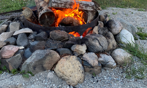

What’s the fuss about having a metal type container for a fire pit?
Just build the fire on a non combustible material that’s large enough to contain all the flammables. Concrete sidewalk blocks or flat slate rock work well.

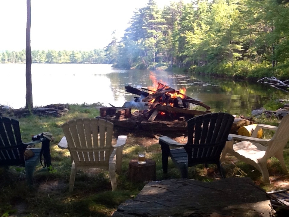

In one case I used concrete sidewalk blocks laid flat for 15 years or so With no cracks. In the picture shown the slate rocks have been in use for over 20 years.
They both sat above normal ground elevation with no side walls. Gives excellent burning conditions. In the picture shown the flames are easily visible. The radiant heat is good, the fire gets lots of air and burns well. The air flow keeps the base cooler.
From your picture it look like you are in a forest so that shield the wind, it depends on the surrounding condition, I need to shield my fire on my proprety because I am surrounded by field so a lot more wind, I mean If there is zero wind I don't have too. I am surprises about the sidewalk block but when I initially read it I was thinking of concrete blocks and not sidewalk block. Setting a fire on concrete or rocks slab vs shielding around the fire is different as there is a lot more heat on the side then under a fire. Ashes also insulate the surface below it. If you look at the rocks from my fire pit you see how a lot of them are crack... the darker rocks would need a lot more heat to crack since they are mafic rocks. Shielding around a fire is nice since it keep the heat and wood in so you don't have to keep moving the logs back to the top / middle of the fire for them to burn all they way.
