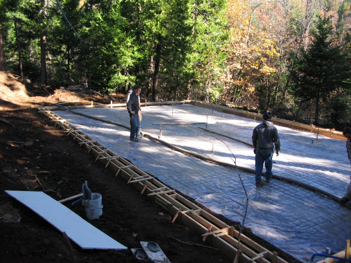

Another angle.

I didn't mean to start any arguments here.
I'm taking a route that is middle of the road. By that I mean I am going about this one step at a time. I've contacted a few of the necessary professionals and I have testing for the concrete scheduled for mid December. I am not rushing to a lawyer however I have not discounted the idea totally. I'd rather go to the lawyer once I have evidence by professionals that he has been negligent and not just my rants. Once I figure out what the total damages are I will decide what action to take next. Last thing I want to do is go off half cocked and I certainly am not going to let this go by without correction. I've got to take little steps or I'll loose all control of what happens and I can't afford to have that happen.
At this point I have no warranty on my building until it is re-engineered by a licensed engineer and it has to be stamped and certified. this is what the building manufacture has told me.
The building is still in the field tied up. I'm going to see if I can get it covered or something until this is settled.
The contractor seems to disappear for days and out of the blue he wants to rush and do mostly nothing. Which in itself is aggravating. I have not seen him or heard from him in maybe a week +/- until yesterday. He called yesterday and I told him the project was on hold and not to come out. He sent a guy out this morning who started to work so I had to go out there and tell him to leave. He tried to argue with me. I explained that I was not going to discuss this with him he just needed to leave. Not 20 minutes later the contractor showed up. I asked him if we could set up a time that we could discuss this matter. I didn't have time this morning as I was late getting out already. He was very upset and told me I was crazy that there were no problems and all this could be fixed easily. He didn't understand why I was being this way. When I explained the warranty issue he said they do this all the time and there are no problems. After I left he gathered up all his wood and took his trailer with him. I will give him a day to calm down and then I'll call him.
I know this is going to be more of a fight than I signed up for but I have to deal with the situation now. I will do what's fair for all involved but right now I don't know how bad it is until I have the tests done and the engineer gets here to tell me what the problems are and what it will take to make it right. Then I can decide what I need to do. I have no intentions of letting this go without an acceptable fix. I do plan to sell at some time and even if I didn't I don't plan to have a subquality building, even if it is a barn.
We may end up leaving that slab in place with some fixes and starting over next to that slab. We've discussed making the existing slab more of a carport of sort of patio with a trellis of sorts. Maybe a place for BBQ's. I'm thinking that if it's not structurally sound for the building that it may be useful in another way. I'd hate to think it was a total loss. The top of the slab is fairly nice and I'm sure with some engineering we can make it work. If it still looks bad then we could do a concrete topping on it. It's expensive and was not in our original budget but we'll just have to see where this takes us.
Back to the concrete mess...
The testing company has given me 2 options. 1 is to core drill it at 500.00++
the other is to do what they call a Swiss Hammer test that runs 250.00
I've heard of core drilling but i've never heard of the Swiss Hammer. The testing company comes highly recommended and they are leaning towards the Swiss Hammer because of the steel in the slab. I haven't spoke to the Arch. Eng. about it yet, just thought I'd get your ideas.
Thanks

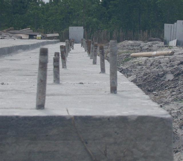

Jim,
I agree with you on your opinion of the contractor. I'm not so sure about the slab though. I've copied and attached two of the pictures that Mrs. Tiles posted that caught my eye about the quality of the job. Not the bolts, but the finish and pour itself. First, she mentioned all the extra water that was added. There was no reason for this except to give the crew longer to work the mud. He would have done that if he was short of people. We pour here in hundred degree temps and don't add water, so outside temps are not a good reason to add water, just time. Extra water means less strength.
If he'd done everything right, than it probably wouldn't matter if the concrete was a little weaker than it could have been. From the thicknes of the pad and beams, I doubt it would have cracked.
In the first picture, you can see the exposed rebar. This are doesn't have any strength in it at all. There are two pictures like that in her link, which indicates to me that nobody worked the mud to get rid of the air pockets. If she has two pictures of it, and mabye there's more, than you can gurantee that there's other air pockets inside the pad that nobody can see. The odds are just too overwhelming.
The second picture I've attached is one that shows the pad from the side. The other pictures make it look smooth, but this one makes it look wavy and very un-even. Ignore the bolts in that picture and look to the left at the edge of the pad. To me, this looks very bad and extremly unprofesional.

Ms Tile, in your first picture, is that grass I see? If it is, that tells me the contractor did not remove organic material. I don't know where you are located, but in North Carolina, you need to remove all organic material prior to pouring concrete. Top soil should also be removed. Not removing will cause the concrete to settle / crack.
Eddie:
I hate to disagree with you, but in every reinforced concrete structure I have ever seen engineering plans for, the strength is derived from the bar, not from the concrete.
The reason bar is placed a certain distance from the edge of a pour is usually to prevent rusting. While I agree that the job is sloppy to the point of being inexcusable, I think that this area could be salvaged by being grouted, especially if a consciencious contractor took care to assure bonding between the grout and the existing pour.
I completely agree with the idea that there are probably major voids in other areas.
This is never going to be a fine slab, but with some additional expense it might be salvaged.
The part that gives me some concern is from the original post:
While I waited for the building documents and the permitting to go thru I had my neighbor dig up the area for the slab pad and I brought in several trucks of dirt. No real requirements but I wanted to elevate the barn about 2'. This dirt pad sat for some time til the contractor got the permit and we could finally get started.
The pad apparently was poured on 2' of "dirt" (topsoil, clay, whatever is not specified) and there is no mention of placing this in lifts or compacting it.
If anyone is concerned about settlement, look no further. This is almost guaranteed to settle over time.
I see a potential mess here with tile's wife (and tile) having a very valid complaint about an incredibly sloppy job, but the contractor having a counterclaim that the preparation was improper. Now why the contractor would agree to pour concrete on such a poor surface is a mystery to me, and he may be liable for it, but you would need someone familiar with construction case law in the local juristiction to sort that out.
I would certainly think that any competent contractor would recognize a 2' base the exact size & shape of the pad as a recent fill-in and would question how it was placed.
The other issue which is of some concern is that while I see vapor barrier, I see no drain rock under it, and I see no sand over it. This is just plain not the right prep work out here on the left coast, and I think the laws of nature are the same wherever you are. No sand over the vapor barrier will lead to cracks.
And, speaking of cracks, there is no indication of any bar or mesh in the slab itself, just in the grade beams under it.
The real bottom line is that I would not pay the contractor anything until I had the engineering report, and then I would subtract the cost of fixing the problems from the contractor's bill.

I've always been led to believe that concrete has a certain level of strength based on it's mix and the materials used. Adding rebar to that mix increases the strenghth of the concrete by spreading out the surface area and allowing the concrete something to bond to. Haveing exposed rebar doesn't accomplish anything from my understanding. If it's just that one area, than a patch over it will keep it from rusting and make things pretty, but that will always be a week spot.
Concrete has strength in compression. It has almost no strength in tension.
While steel has strength in both tension and compression, the long, thin pieces of rebar would easily buckle if subjected to any significant compressive forces.
Reinforced concrete is a composite material which uses the strengths of both components to achieve its properties.
The way an engineer designs a reinforced concrete structure is to examine the tensile forces developed under the anticipated loads, apply a safey factor, and then specify enough bar to withstand the tensile forces. For most instances, unless you have a completely rediculous amount of bar (ever see a bank vault being constructed?), the area of the concrete times its compressive strength is so much greater than that of the steel that no calculation is ever done for compressive strength. The common term for this is "designing for the bar" or "designing for the steel".
Clearly, the structure is stronger if the bar is completely surrounded by properly compacted concrete, but I expect that the right grout would fill in the exposed voids in this pour. If I owned it, I would mix epoxy with sand, and force that into the exposed voids. Expensive and probably labor-intensive, but the epoxy-sand mixture would adhere well, and make a decent repair. Another possibility would be mixing up a grout with the concrete-adhering emulsions I have seen.
No it wouldn't be as good as doing the job right in the first place, but it could be "good enough".
If it's like you say, and I believe you're right, that pad will be moving for the next 30 years.
Probably longer. The house I live in had areas of uncompacted fill under concrete slabs. It was originally built in 1928. In 1988-89 I completely remodeled and rebuilt it. I had noticed some of the concrete slabs settling before I tore them out, and when I did, the dirt under them was still not fully compacted, 60 years later.
