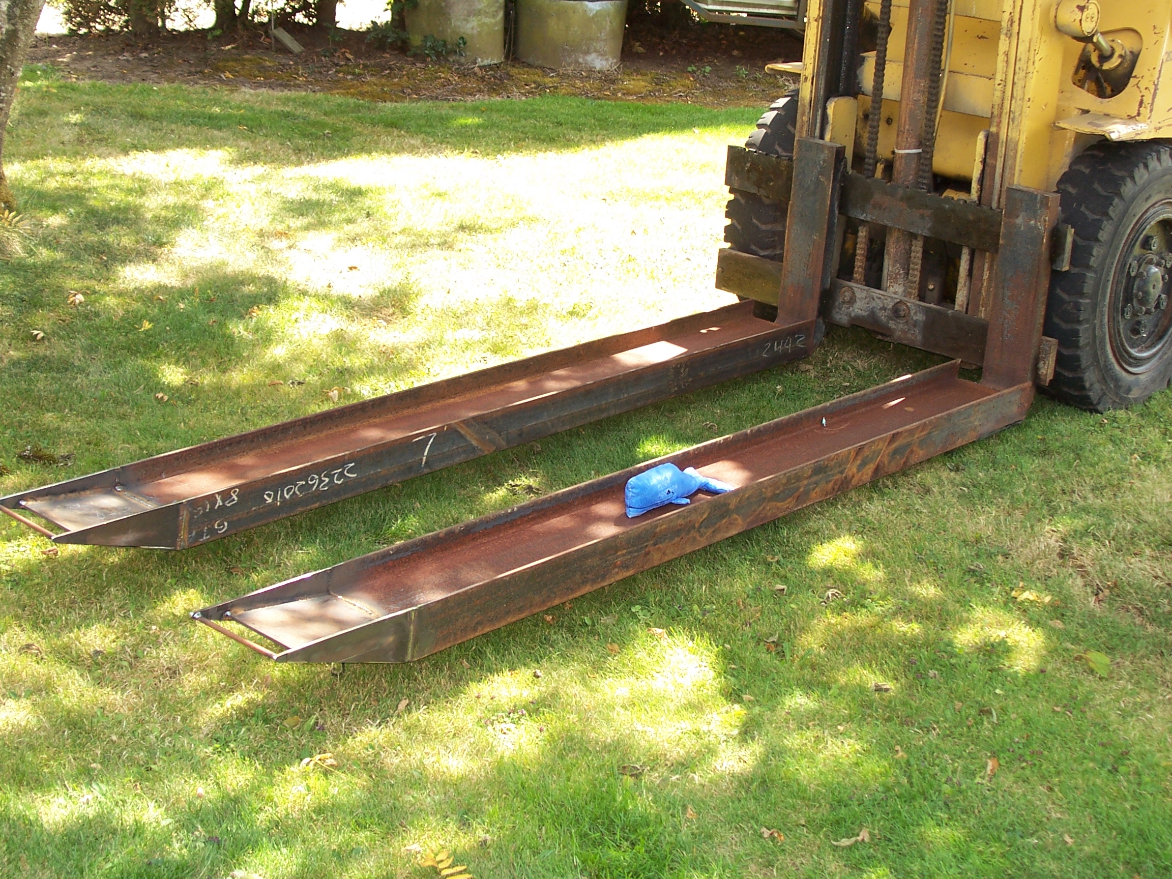

Ya I'm not sure. Years of grinding on hard surfaces did them in. I straightened out the tabs on the one to the left tonight. Off to the scrap yard tomorrow for some plate

Patches cut and fit, nice patina match!
Welded
Ground smooth
Nice increase in length
   / Project Clark forklift #23
Looks good, those have the proper taper and everything. Having the extra length comes in handy sometimes, especially on big bulky items like pickup toppers or beds. I picked a whole S-10 Blazer body off the frame without a bit of damage, would have been nearly impossible without the longs.

Well u did some nice work on those custom forks!

Nice to have the Clark back and the extensions are great. Good to move the crawler out of the scrap pile. Time to pull off the pto from the parts machine and sell the rest

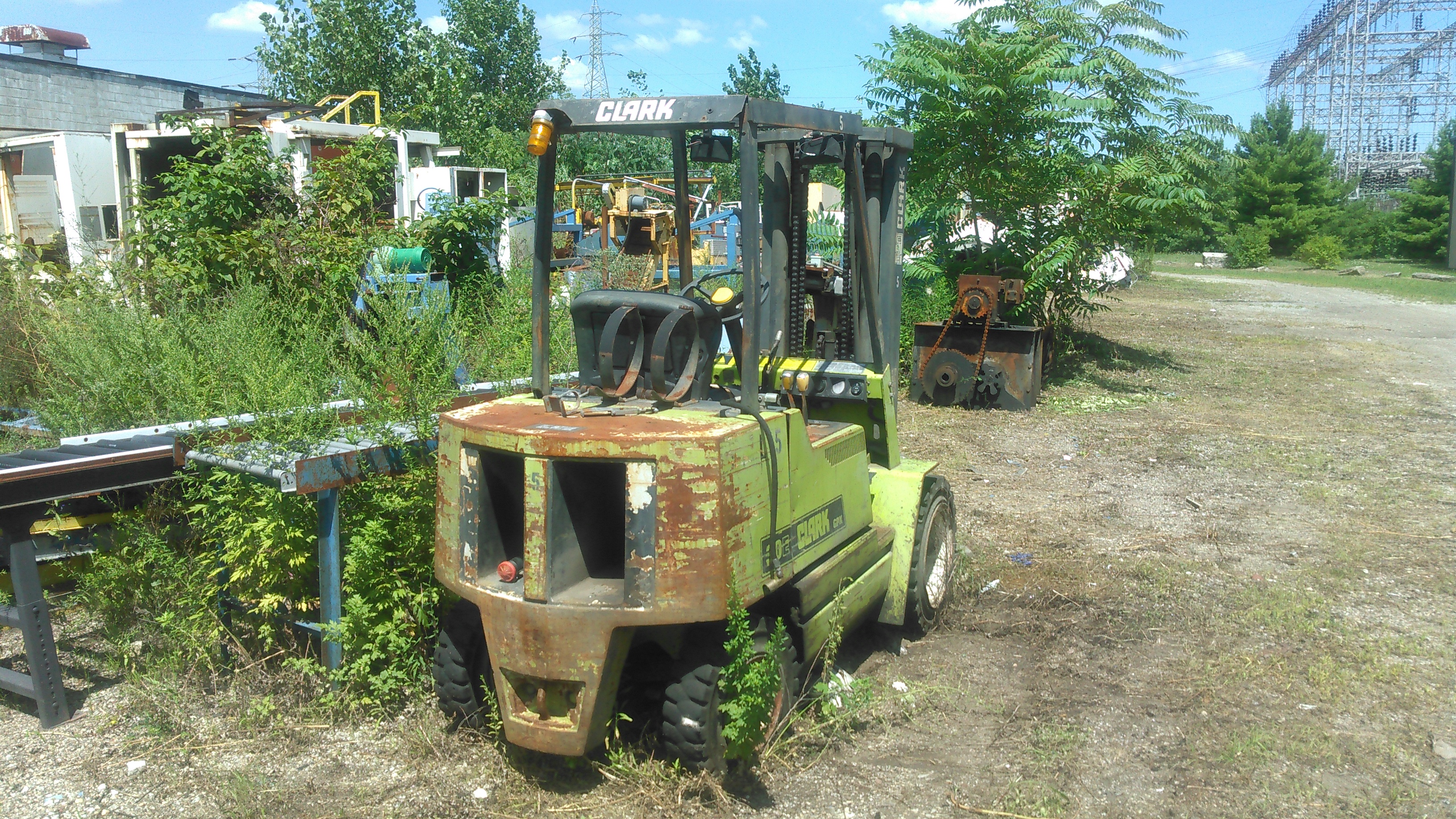

   / Project Clark forklift #29
very few forklift projects out there on forums it seems... just got the OK to save one from the crusher- we had this at work, terrible mechanic they were using was sabotaging trucks, overfilling oil by several quarts so seals would blow, open air intake filter boxes, you name it... anyway, this one stared leaking out the rear main, and it wouldnt pass our safety dept tailpipe sniffer, so they put it in the scrapheap 2 yrs ago... I heard they were going to clear out the old courtyard where we park scrap machinery, went out to take a look... got a bridgeport and leblond lathe that way years ago, just love saving old junk... anyways, this 'gem' is a 1994 model- yeah i gotta pull the motor to fix it, but even at home, shouldnt be a issue, other than room...boss says free- get it outta here, cant pass it up- although free usually gets expensive :) put a new battery/plug wires/cap/rotor/oil/few spings wires/hoses on it and son of a gun, she started :) everything still works, bodywork is actually decent too- should be able to fill/paint/decal to look like new, once the leaks are fixed.KIMG1113.jpg

A place that I worked back in the 90's had an old Clark Lift that we were not allowed to use because it smoked and leaked.
I needed to use it often so when the owner wasn't looking I checked it out.
Turned out the crankcase breather was stopped up completely forcing oil out the crank seal and rings.
It stopped leaking and smoking went way down!
A couple months later the owner sold it. :(
