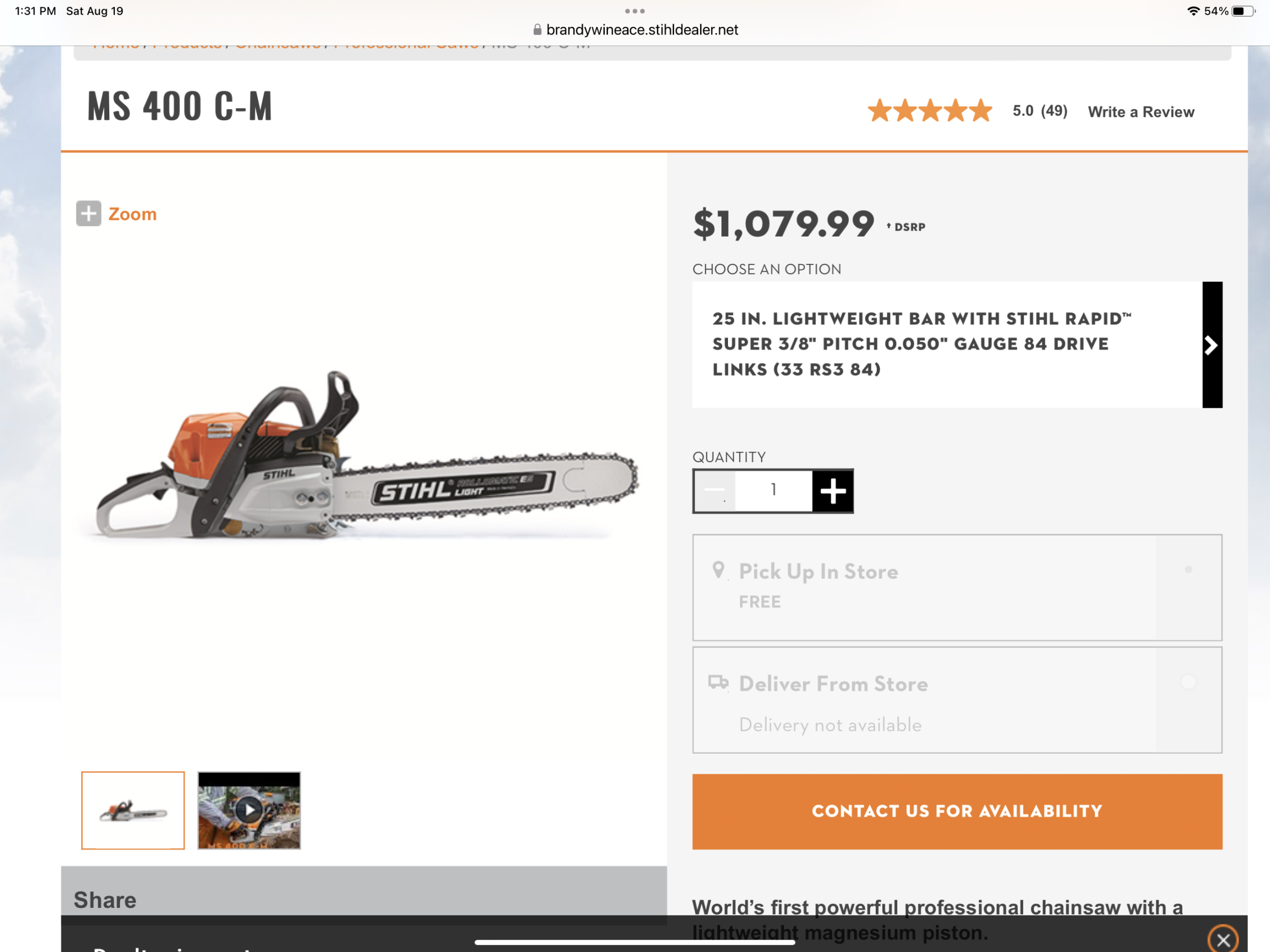

I’m looking for a used 25” pro saw right now, but the prices people want for used give me pause. Why not spend a few hundred more and get a screamer out of the box? Used saws always seemed like such a risk.
Anyway-gotta replace the Makita/Sachs 6401.
Looking at Stihl 400 w/ 25”
5.4BHP
12.8lbs
magnesium piston
I can get 10% off this price

You don’t need that big of a saw to pull a 28 heck a 60cc will do it. If I was in those shoes I’d be looking for the lightest option you can with good anti vibe that way it’s more likely to get used.
Also what bars do you already have?
   / 'Professional' grade saws vs. 'Homeowner' saws #113
Im looking at the Stihl 400 Has real nice power to weight ratio and the price is real good. Will run a 25”, which is fine.
Currently have 261C with 20” and Makita/Sachs 6401 with 24” (scored piston/cylinder)
   / 'Professional' grade saws vs. 'Homeowner' saws #114
If you forsee a future use for the saw beyond the current cleanup job, today's price may seem like a bargain compared to what it might cost in a year or two. I think the little arborist top handle Echo saw I bought back in March has already jumped in price.
   / 'Professional' grade saws vs. 'Homeowner' saws #115
Something like a 372w or even an original 372 will run that 24” bar you already have same with a 562 all with better anti vibe vs the 460’s that are rubber mounted. If you’re dead set on Stihl I’d look at a 462 they’re a nice short bar saw, mine I’ve ran 32 but it’s not the happiest especially if the grind is aggressive. I put the Stihl 462 and the Husky 562 in about the same class I do prefer the way the Husky feels myself plus I’ve put a lot more hours on one vs the 462. I haven’t ran the newer Huskies like the 572 or the 592 so I can’t comment on how they handle longer bars but the original 372’s when they were hopped up they’d pull a 36 nicely, where the 385/390’s we’d go up to a 42 some guys would put 50’s and the 395’s would pull 60’s.

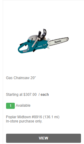

A thought... And it involves Home Depot... So it may not work. I have had good luck a couple of times buying used rental tools. This one is a 64cc 20" Makita. Just a thought. There may be semi local rental yards that might sell you something that will work well for you at a discount from new?
