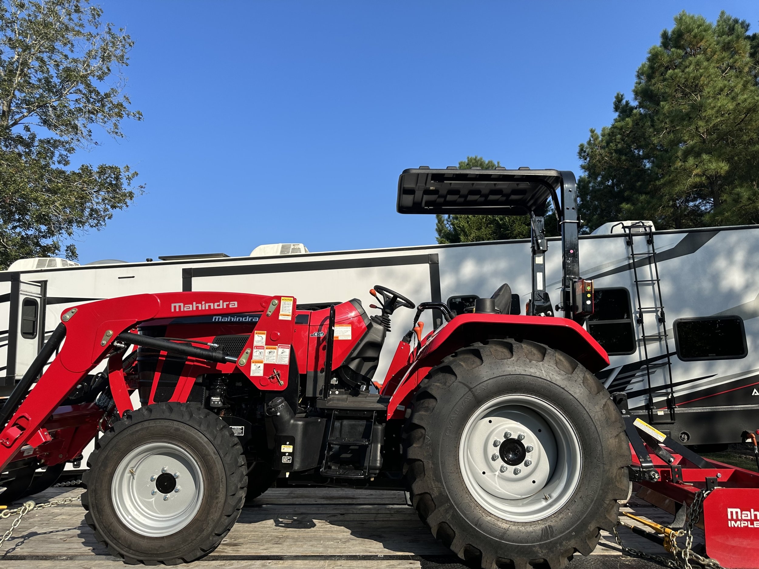

So far, 30+ hours on my 5155, and I have had zero issues with it. I did have a small leak on one of the hydraulic lines on the FEL, but a quick tighten solved that. I was not watching what I was doing, moving logs in a tight space, and hit a taller stump with my stairs on the left side of my tractor, they got all bent up, but that was the only damage. They still work, but I will replace them soon. I added a canopy to mine, and I added ballast to the rear tires and front tires. I also added the W.R. Long third function kit, and it works like a charm. I use my Mahindra grapple more than anything. I will add a hydraulic top link very soon.
This tractor is a BEAST!!!!

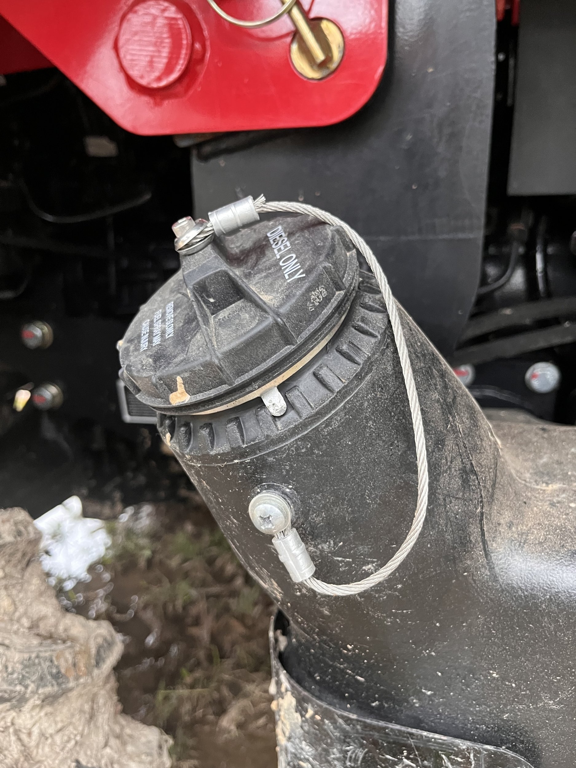

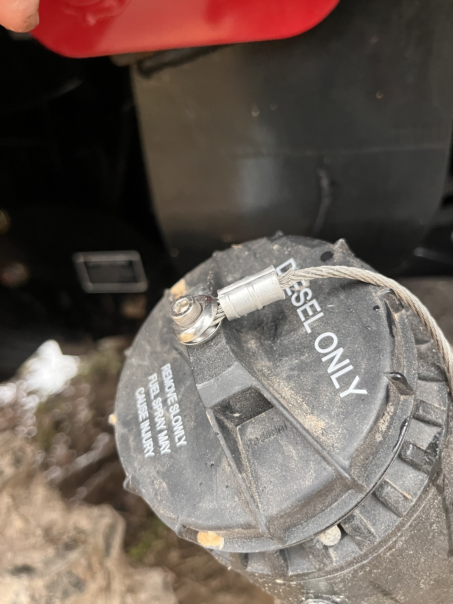

can you post a photo of the fuel cap tag line, had a similar issue where the black top of the cap came off and broke the plastic retaining strap. I searched thru the brush and found the top of my cap and it went back on like new but that retaining strap is a constant issue.
Sure can. I'll grab some pictures after work and post them. I agree the strap is flimsy and the way it hangs off the side makes it easy to snag on anything. The way I've done the wire is where I can actually spin it so it rests flat against the tank.
be interesting to see as i'm currently going free willy with my cap. after chasing my cap under the tractor a few times i have decided that free range is not the proper state for a fuel cap.
This tractor is a BEAST!!!! View attachment 849663
What brand of canopy do you have? All the ones I’ve looked at sit on top of the rops and I don’t have enough clearance on my barn doors for them. Looks like your setup would work.
