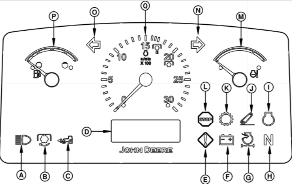

Some models would display error codes in display. What lights are coming on? DOes anything seem to be malfunctioning when lights are lit? I am attaching a pic of dash. Area "D" is where codes may be displayed if it is equipped that way. If not equipped, then only way to read codes is for dealer to plug in. I am not aware of any "affordable" code reader. Most systems cost thousands of dollars. 5m display.PNG
/ Problems with new, used 5085m
J and E lit up. 3 point will not actuate..
/ Problems with new, used 5085m #9
Without a code to guide you it is hard to say what would be causing your problem. I would suggest to first check all fuses to be sure they are good. hen check for any disconnected wiring around hitch area. There is a hitch position sensor, draft sensor and hitch raise and lower solenoids around rear of tractor. You also could have hitch raise and lower switches on the fenders as well as the hitch controls in the cab. Problem could be any one of the solenoids, sensors, controls, wiring or the hitch control unit. Also could be a calibration issue that requires connecting computer to tractor to recalibrate.

Unfortunately it looks like you have no way of reading codes on your tractor without dealer computer. I believe that was not available for your model until a later year model. THe Service Advisor connection on your tractor is behind the seat. There should be a panel behind the seat held down with 2 thumbscrews. Remove that panel and on left side under cover is a large round black connector. That is where you plug in to do diagnostics. There is a performance monitor that can be bought to plug in to do diagnostics and calibrate hitch. Monitor and wiring harness to plug into diagnostic plug runs near $2000.00. If you have diagnostic manual, it will tell you how to use monitor to diagnose.
