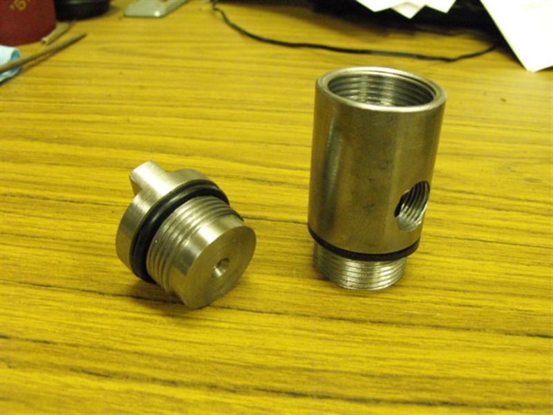

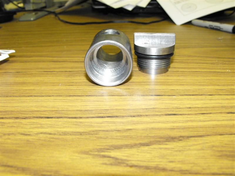

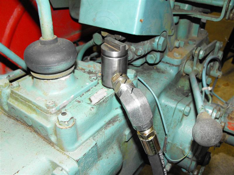

I have been out learning how to use the loader and testing it. Everything with the loader seems to be working alright but two things have shown up that I didn't expect. Tractor is a YM1900.
1) Hydraulic oil from the transmission is seeping out around the shifter boot. I am assuming it is being caused by the return adapter I made in order to route the loader valve tank port back to the transmission. Since I never had this problem before I put the loader return line into the oil fill hole, I'm pretty sure it is the cause. Not sure why or how to stop it. (See photos of the adapter)
2) When dumping a full bucket of dirt, the bucket will speed up once it passes the break over point. Then it will take a few seconds before I can move it further down. I am guessing it is creating a vacuum in the cylinder and the pump can't keep up with the flow rate going out. I am reasonably sure this is not a good thing and could use some help or ideas on how to correct it.

#1.....? Is the trans case/reservoir vented..?...it maybe venting thru the rubber boot.....the adapter fittings are very creative, nice work.....would like to see a piece of tubing incorporated in it to deliver the return oil below the oil level to alleviate turbulence at the fitting creating air/foam.......
#2.......Possibly overrunning load creating suction in hyd lines (pump flow slower than load inertia)......flow control may help...Parker F600S Flow Control Valve.....

#1... I can add a tube extension as I don't see anything directly below the opening down to the oil level in the transmission. The only vent that I am aware of sits on top of the 3pt assembly. It's a small curved tube. I have not checked to see if dirt dobber's have plugged it up. We have a problem with them here in Oklahoma.
#2... The pump on this tractor only puts out 4gpm which works the loader well enough but may be the problem as you suggest. Would I be able to put the flow control valve in just the bucket lines? The loader goes up and down just fine and a full load does not have the same effect on those cylinders. I don't know enough about hydraulics yet to understand exactly what is going on but I don't like it:mad:

Hey Gary, like another member said add a line where u installed the return to go fuller into the trans. This should stop the leak and cut down on the air bubbles which is not good to have in the oil.
I guess I will have to make a new piece that is longer. I thought about just threading the inside and screwing an extension on it but the idea of it coming out and falling into the tranny is a little unnerving. I'm sure there are ways to lock the threads against that but it would always be on my mind that it could happen. I'll let everyone know if that cures the problem.
