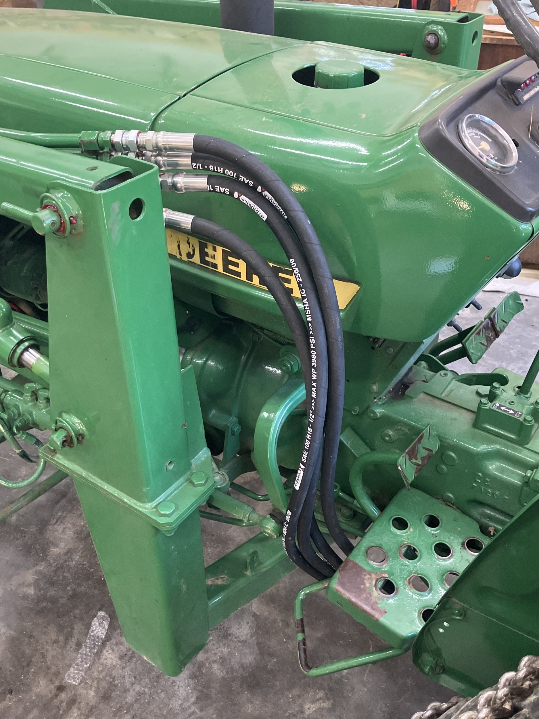

I just replaced the 4 hoses on my 1987 Jd 950 with a 75 series loader. The old hoses were breaking apart so I figured better safe than sorry. I got all my new hoses on and now the loader has a mind of its own, sometimes it gos up sometimes it go’s up halfway and emits a loud wine. Sometimes the bucket will curl in and out sometimes it wont and I get the same wine. I checked my hyd oil level and its still on the upper 2/3 of the dipstick.
I was hoping it was just air in the lines at first but I’ve been cycling them for about 30 minutes and it still isnt working right. Worked fine before I replaced the lines.
Is there some kind of bleeding valve or procedure? I looked in the shop manual and couldnt find anything.
One thing to note, I ordered 1/2” hoses instead of 3/8” on accident and couldnt return them so instead of buying a whole nother set of hoses I just bought reducers. Not sure if that could cause any issues.

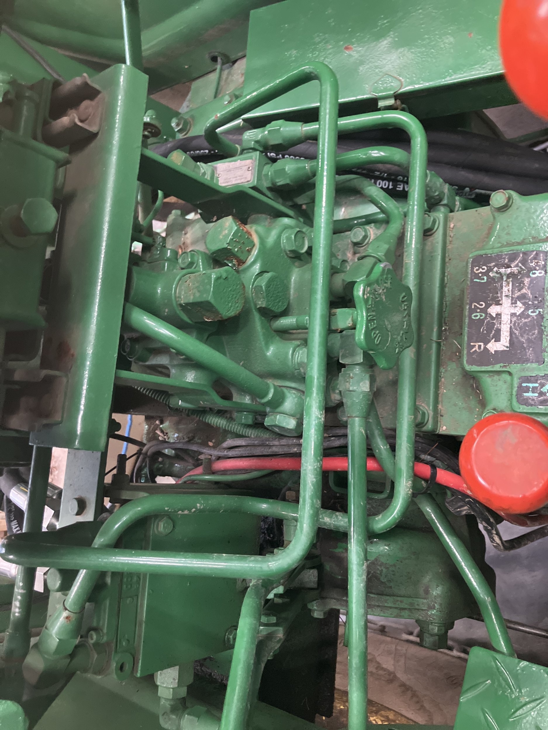

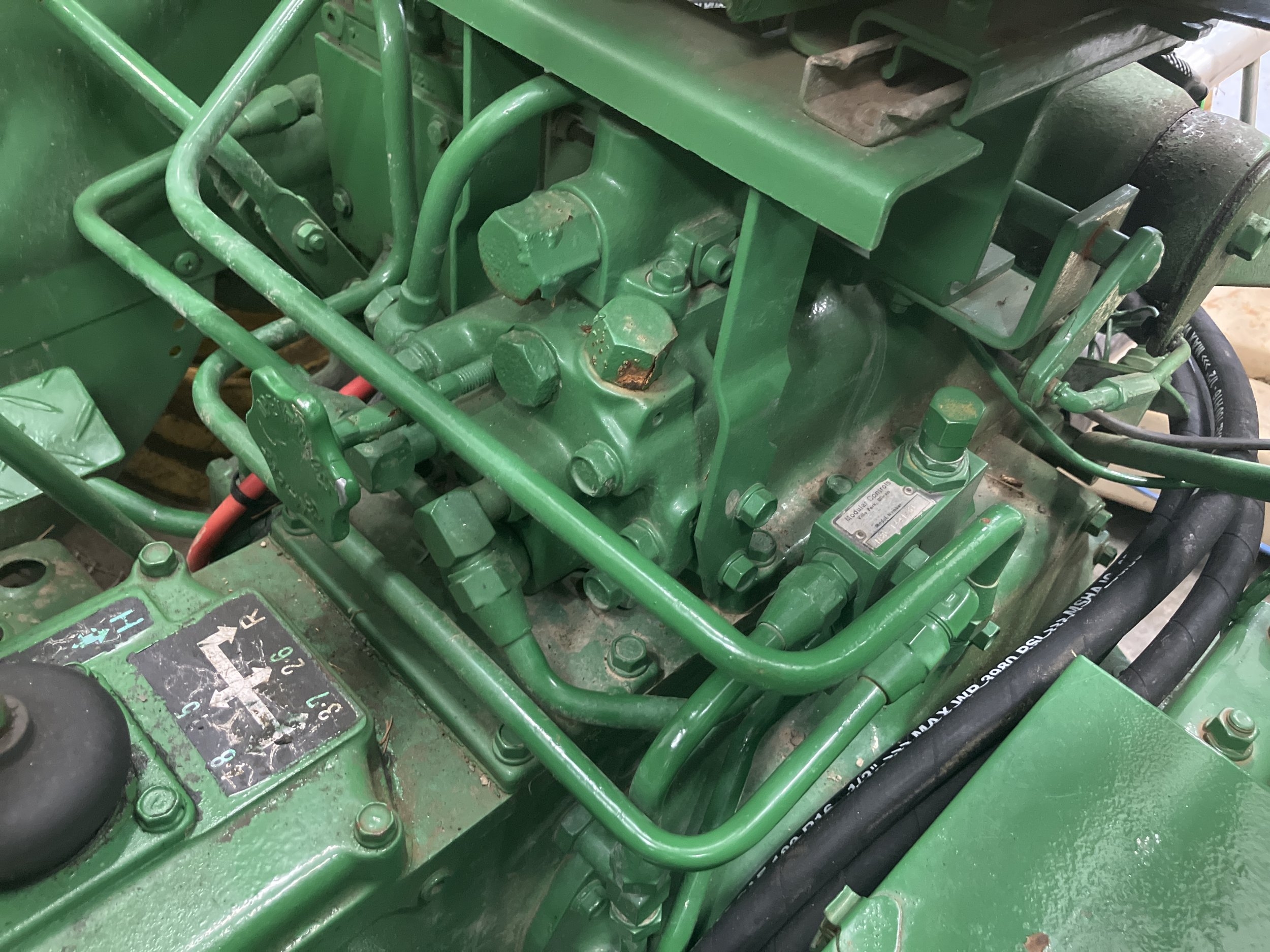

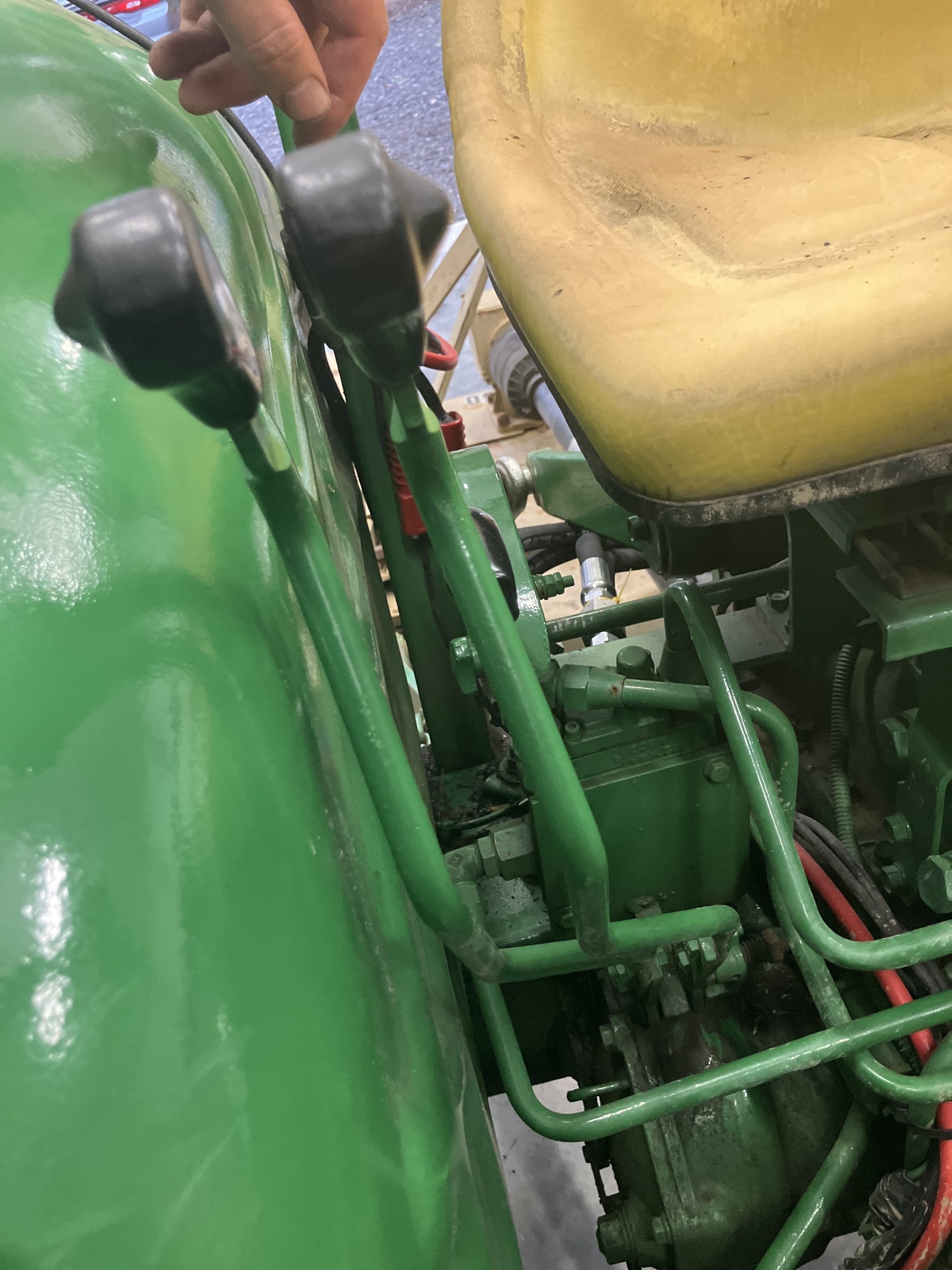

From my ongoing research there are different setups for this tractor so I want to post a few more pictures so people know which I have.
The whining nose is coming from the unit directly under the seat where the fluid is coming in from the pump. It only whines when the loader stops moving. The power steering and 3pt systems both seem to be operating normally.

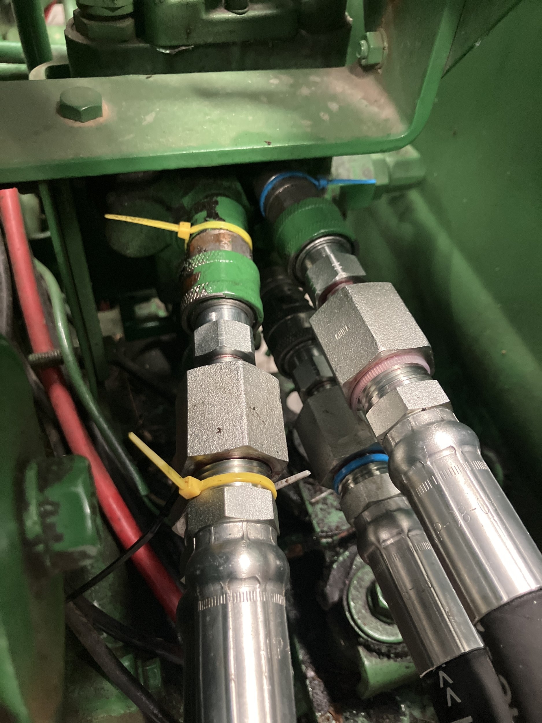

If you have your color zip ties correct then you have them connected wrong in your picture. You have the white connected to the blue.
Good call. I didn't see those pictures before. You're absolutely right.
/ Jd 950 FEL issue #12
I was seeing the same thing.
