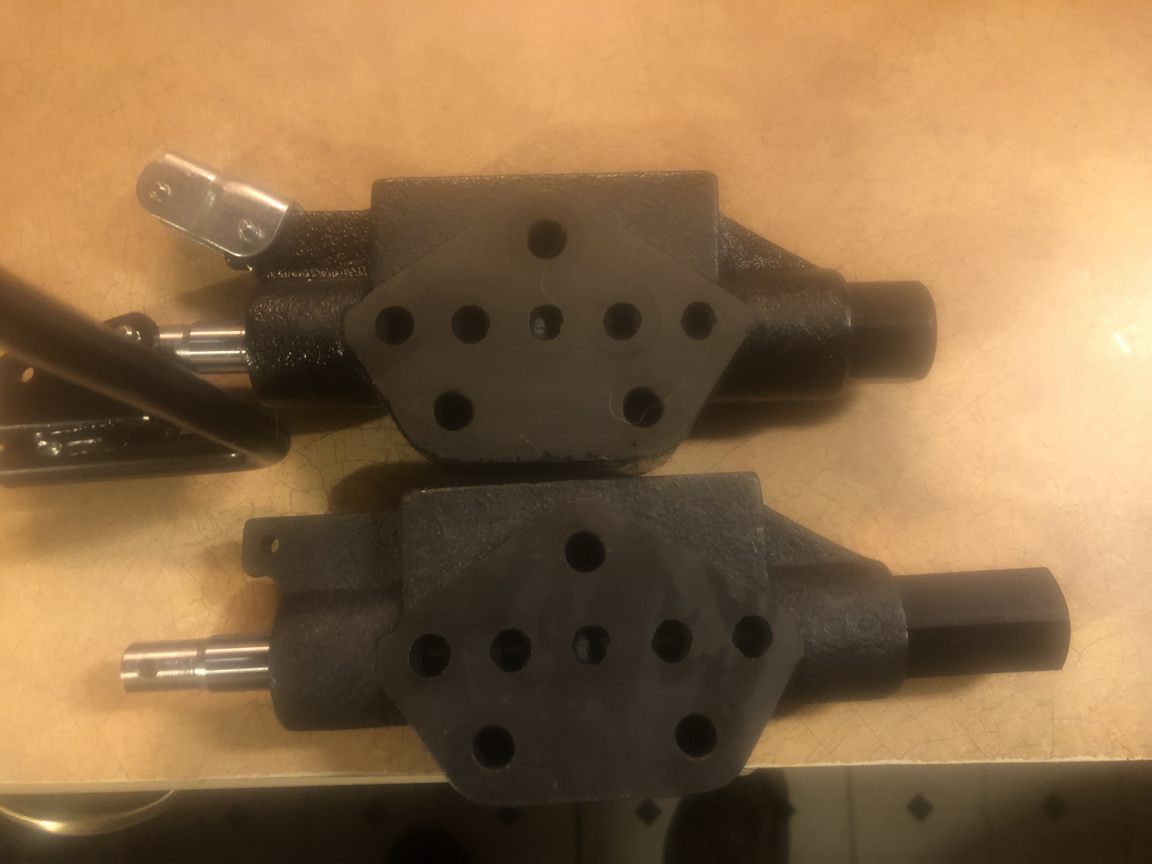

GreenMtns, I haven’t installed mine yet so it was easy to take pics and describe what I saw. the valve with the long hex bolt in the pic is a bl7373 detent valve. The one with the handle is the standard spring center valve. On the 5 ports that have fluid go through them, I can see daylight through everyone but the middle hole with them being in the centered/ neutral position. The standard valve is the same way. I was wondering if yours looked the same or if something was blocking one of the ports. If you can’t there is something blocking the port making it and the other 2 valves not work. It could be an o-ring on the internal rod that goes through the 5 ports. If you need me to look at anything else on the valve bodies, just let me know

I just checked the spool and it is like you said. In the neutral position you can just see daylight in all but the middle port. So I do not know why this spool just screws up the system when installed. Remove it and all's well.
Since all spools show like that in neutral it should not make any difference in the order they are stacked I would think. I neutral the oil should flow right through them in any order.

It is going back for this reason and that BL7373 is a Detent Valve (Not Self Canceling) which is not what I need because I do not run wood spliters or other implements that need a constant flow of fluid.
