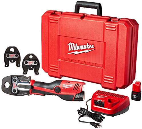

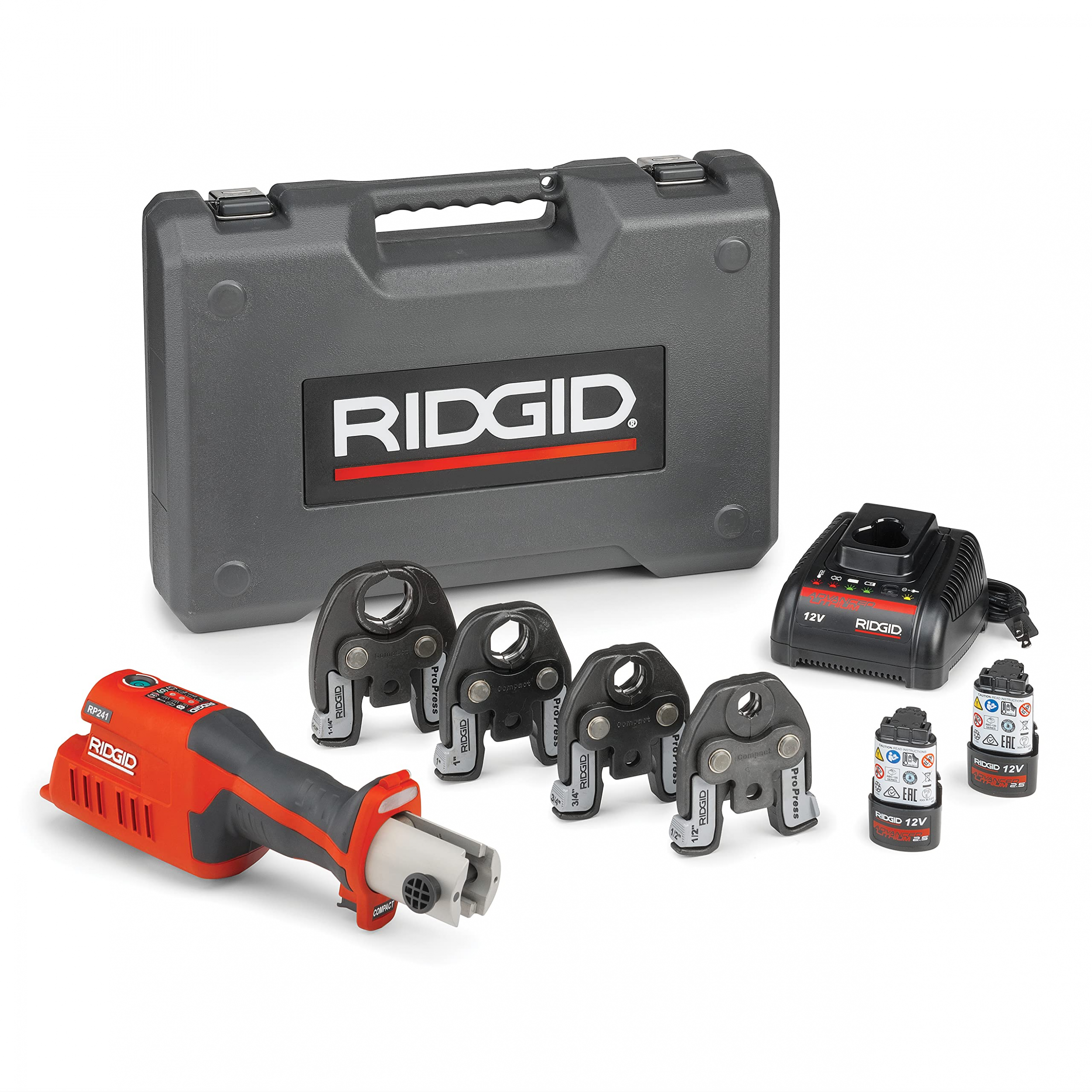

Has anyone used and name brand pro press copper pipe crimping tools for 1/2" and 3/4" copper pipe? Pros, cons of specific brands.

Yes, I have - I've used both Ridgid and Milwaukee brands and crimped from small to 2" copper lines.
Great for doing repairs. But, as with anything that is sealed via gasket - guys I know are weary of putting these behind walls. I have only used Viega fittings, I believe they have an assumed 50 year lifespan.
As far as between the brands - Milwaukee's will fit nearly anywhere - nice when working between stud bays. Ridgid seemed quicker, more power, but bulkier.

Wish I could be more helpful - if you already have a lot of Milwaukee, go for it. For 1/2" and 3/4" - the smaller batteries will handle it with ease. Otherwise, Ridgid offers a nice product - I believe a few models even have a fully rotating head.

Have used alot of propress with a rigid tool.
They are expensive, but I can say they are excellent for repairs. My experience is in a production factory setting. Old copper can be a PITA to sweat with the cleaning of of the old copper, fluxing, and making sure it is DRY. And YES, hot work permits....The pro press dont care and saves valuable time. Which when you have to shut a production line down that cost $600/minute of downtime....and you can propress a leak in 30 seconds flat and sweating takes 5 minutes for prep and drying of the line....that single repair just paid for the tool and fittings.
