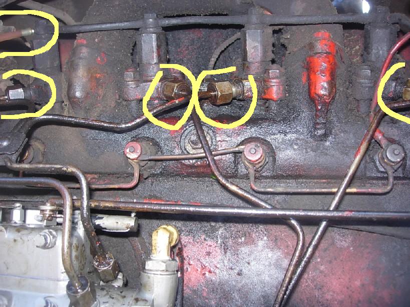

Ok, I took some time out to get a couple pictures.
First picture is of the pump with the fuel lines to injectors attached.
As you can see by the state of shine.... this pump didn't originate off this tractor :eek:
the second picture shows the injectors. The top left circle is the fuel return line and you should be able to ascertain red fuel in there which tells me the pump is pumping SOMETHING??

   / Prime new fuel injector pump? #27
I think this service manual covers your machine. If so, there is good news and there is bad news. The good news is your injection system appears to be self bleeding. The bad news is the self bleeding isn't working. :(
Anyway, take a look and see if this book helps. It appears to be completely readable through the Google Books web site.

   / Prime new fuel injector pump? #29
The end of this pump has a splined shaft, doesn't it ?
Was it splined so it would only fit one way ?
Reason I ask is if it isn't timed correctly, priming it now will be just for practise.
Any hoot, we need a good flow out #1 bleed screw with key off.
DO NOT crank with #1, #2 or any connection between injector pump and fuel tank open. All your going to do is suck in air.
If you can't get full flow from #1, work your way back to tank till fault is found.

   / Prime new fuel injector pump? #40
I'm glad you finaly got it figured it out. I would however be concerned about the extra bolts. If it was me I would remove the oil pan and take a good look to see where they came from. It could prevent a lot of greif later on.
