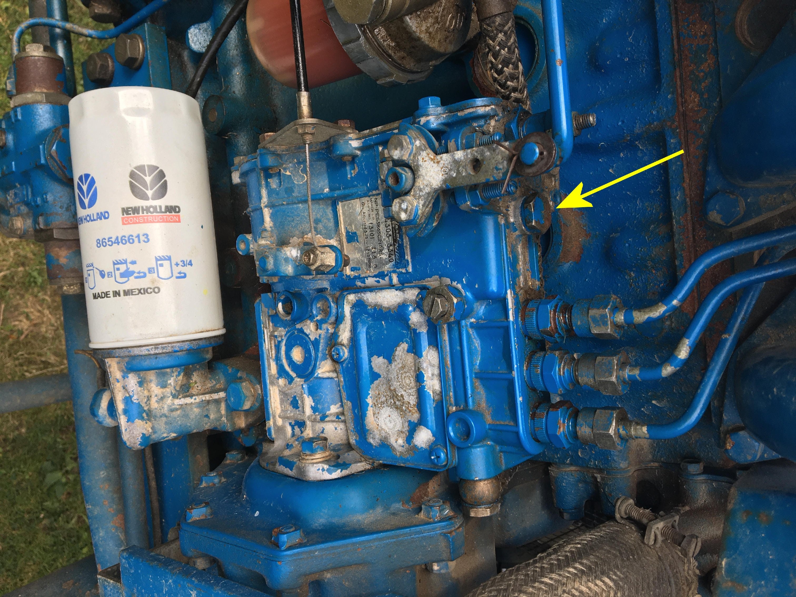

Hello all,
Just changed the fuel filter on my ageing 1910 , bled the filter holder till the fuel came out, but cranking it up it doesn't start.
Loosened the injectors and cranked but got no spurting fuel, just a dribble.
Assume it's the pump which has an airlock, so where do I bleed this off?
Picture of the pump shows this nut on top, taking it off I kind of expected fuel but nothing.
Is this supposed to be primed?
I thought maybe when I removed the filter the fuel all ran back..
Help !
   / Ford 1910 not firing after changing fuel filter
#2
It's the bolt on the side ... found this out from a Youtube reply on a video. ;)
