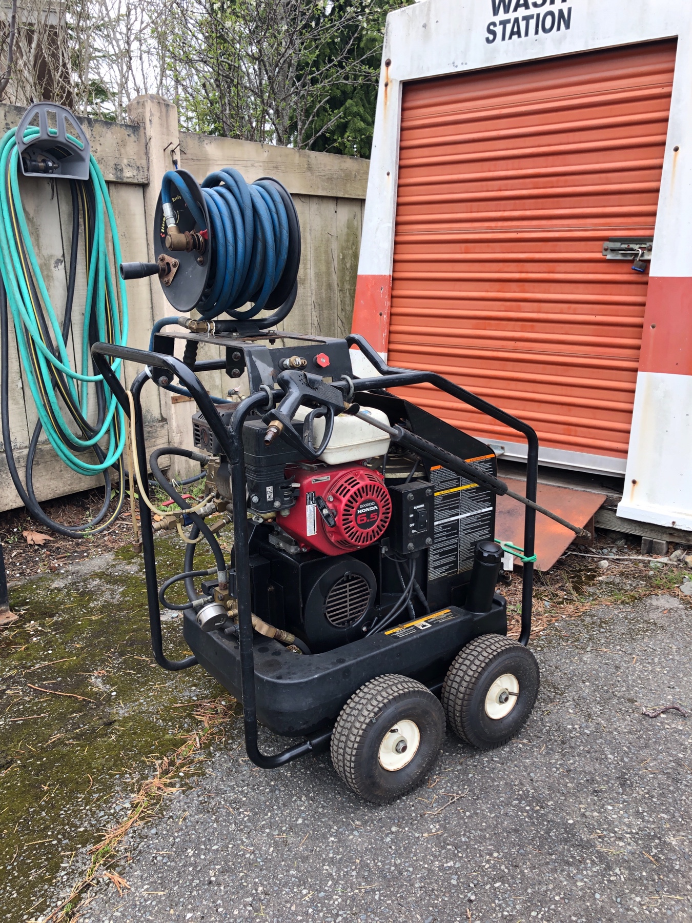

/ Preventative maintenance #8
A good start would be to invest in a pressure washer. It makes regular servicing less of a chore and easier to spot the start of potential “issues” whether it be an oil leak, hairline crack or failed weld.
If funds permit, make that a HOT pressure washer.
Hot high pressure water is vastly superior to just high pressure cold water.
Cold water smears much of the old grease around.
Hot high pressure water (with soap) blows the old grease completely away.

I have a steam genny. The grease doesn't "blow" anywhere and just kind of dissolves and runs down. Same for your skin if the beast happens to turn on you. Kind of dangerous.
Consider it done! :)
