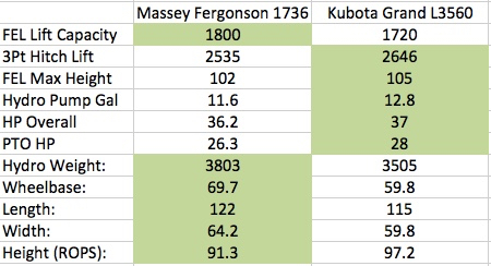

So as i have done more over analysis of my choices I just want to be comfortable with my purchase. Looking higher and lower and just wanted to share some of my work to perhaps save the time for folks down the line. (as it has helped me to look at older threads and not ask the same question) Here is my comparison of the Massey 1736 and the Kubota Grand L3560. Pretty close even on price about +1K for the Kubota.

Once again, regarding hydraulic output, you need to understand the difference between total flow and specific flow. The L3560 does not run 12+ GPM to the implement circuit (loader, remotes). That number you posted was Implement Flow on the Massey, and Total Flow on the Kubota. If you did Total Flow on the Massey it would be a higher number.

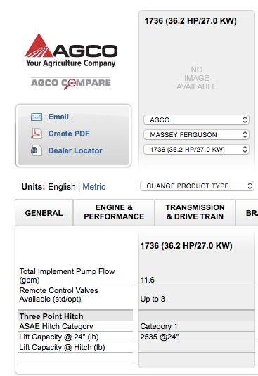

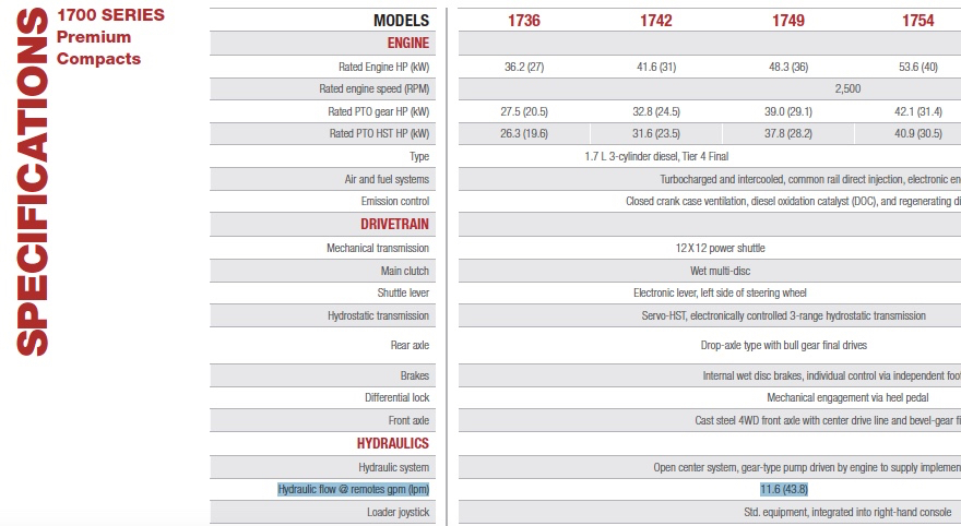

As for the Hydro flow. I can only blame MF for their crappy marketing and website. It really is irritating. Attached are the images I am working off of for the info. They only list total flow. Where the Kubota site sites both implement and steering flow along with total. I would assume Tractordata.com only take the info that the sites/marketing provide.

View attachment 453409View attachment 453410
I like what the premiums have to offer with both the MF and Kubota HST drives. The feature of having an anti-stall guard is nice. I also like the station of the Grand and the Massey. The treadle or rocker pedal I am not a fan of, don't really hate it, just seems a bit awkward. Looking overall what I can compromise with. I feel I must have extendable lift arms and that cuts all the economy lines.
Honestly I keep trying to guide myself MF way. There are some other items I will publish (pricing etc) after I buy. But do not want to show my hand to the dealers if I have not shown too much already. Thanks again for the help!
That number "at remotes" means implement flow. Add steering flow (separate pump) and you get Total Flow.

Ah, I see now. Sorry I have gotten so bleary eyed reading all this dang info. Still cannot find the steering flow but I get the implement flow.
Actually, in this case, their website was providing very specific information, you just have to know how to interpret it. Hydraulic flow to the remotes is implement pump flow. In short, the Massey has about 50% more pump flow to the implements compared to the Kubota. That generally only shows up in how fast the implements move...bucket curl/dump, etc. It's not the biggest thing, but it's nice to not have to wait on the machine constantly. They have similar numbers to the steering pump, and I can't recall ever reading anybody complaining about slow steering response with any modern machines, so it's probably not worth considering.
