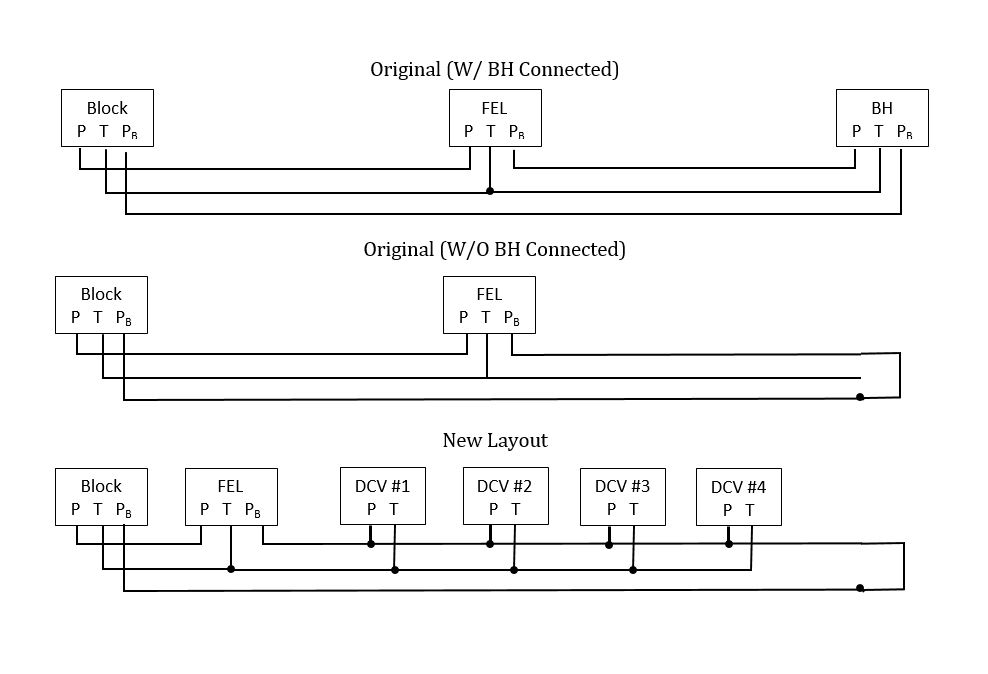

I chose CC valves because my thoughts were that I was simply adding four valves, in parallel, into the interconnection between the P and PB that needed to be maintained when I took the BH off. Seeing as how there should always be flow through that part of the circuit between the P an PB, I didn't think that the CC would be a problem.
As far as where I was inserting the gauge to get the reading, I put the gauge on a tee right after the QC fitting and before the first DCV. If you need a more detailed schematic please let me know.

Thanks for the verbal wrist slap and the input. To answer the question JJ, Northern Tool did not ask what I was hooking up. If you have a moment; take a look at these one line schematics which pretty much depict both the layout as well as the train of thought that went into this.
I chose to go with CC valves because I was under the impression that I would not be truly dead heading any the legs of the circuits as I was providing a continuous path for the pressure being routed through the PB.
If I need to swap out to OC valves will I have to re-plumb the subplates in series or can I keep them in parallel as they are plumbed now?

In OC hyd circuits, the flow is in series from pump to tank.
So with all OC valves, the pressure line is the input, and the PB passes fluid to the next valve IN port.
With a three gang subplate, the ports are connected internally, so that on the basic subplate, you have one IN port, a tank port, and work ports for each valve. The pass through fluid for the subplate is through the tank port.
You could call the tank port the PB if you want as it has a 3000 psi + rati
The subplate tank port does not go to reservoir unless it is the last valve in the hyd circuit.
Your hyd circuit should look something like this.
Pump to FEL, PB out to subplate IN port, subplate tank port to 3pt IN port.
If you want a relief valve for the subplate, they do make them with a relief port.
The relief for the solenoid valves is upstream, the lowest setting relief valve in the series flow path.
I recommend sending your CC valves back and exchanging for OC and OC subplates.
