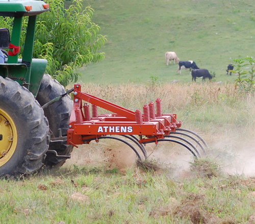

I would use a Chisel Plow, a Primary Tillage implement, or a the lighter version of a Chisel Plow, the Field Cultivator, a Secondary Tillage implement.
Either will aerate your ground without bringing up new seeds.

Pools and puddles are from poor drainage. Solve by aerating as in Post #3.
