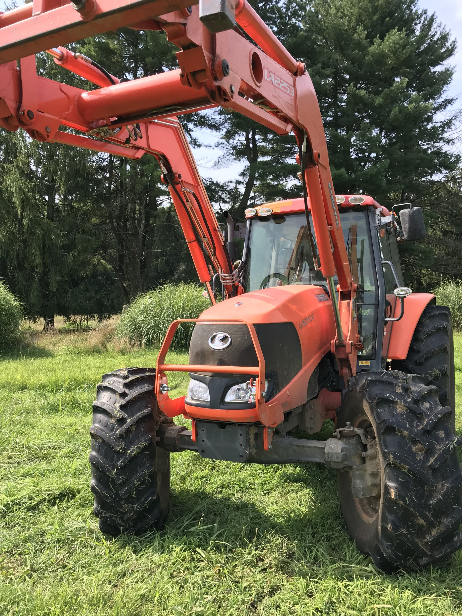

I found a Ford 8340 SLE within a reasonable distance. Does anyone have experience with the Power star 40 series Fords? I'm mostly reading good things about them. According to Nebraska Test Data, they're quite fuel efficient (about the same as the Cummins in the MX134 I was looking at).
I was very close to buying one about 15 years ago, but was scared off by the parts availability. Was looking at larger NH Genesis series tractors, too and they have been out of production for almost 30 years. I did like the “de-tuned” bigger 7.5L NH diesel and the transmission. They were ahead of their time. Never liked a small engine turned up to its’ max for power.
You can pull a 3x3 or even a smaller 3x4 large square baler with them as long as it’s on flat ground. Round baling would be very easy with one.
Fuel efficiency “stats” are nice, but just a little bit of operator inefficiency (leaving tractor idling, running too high of an RPM for a given task) will kill off efficiency.
An MX-135 is a more robust chassis and probably weighs quite a bit more. So it would give you more stability for loader work and more traction.
