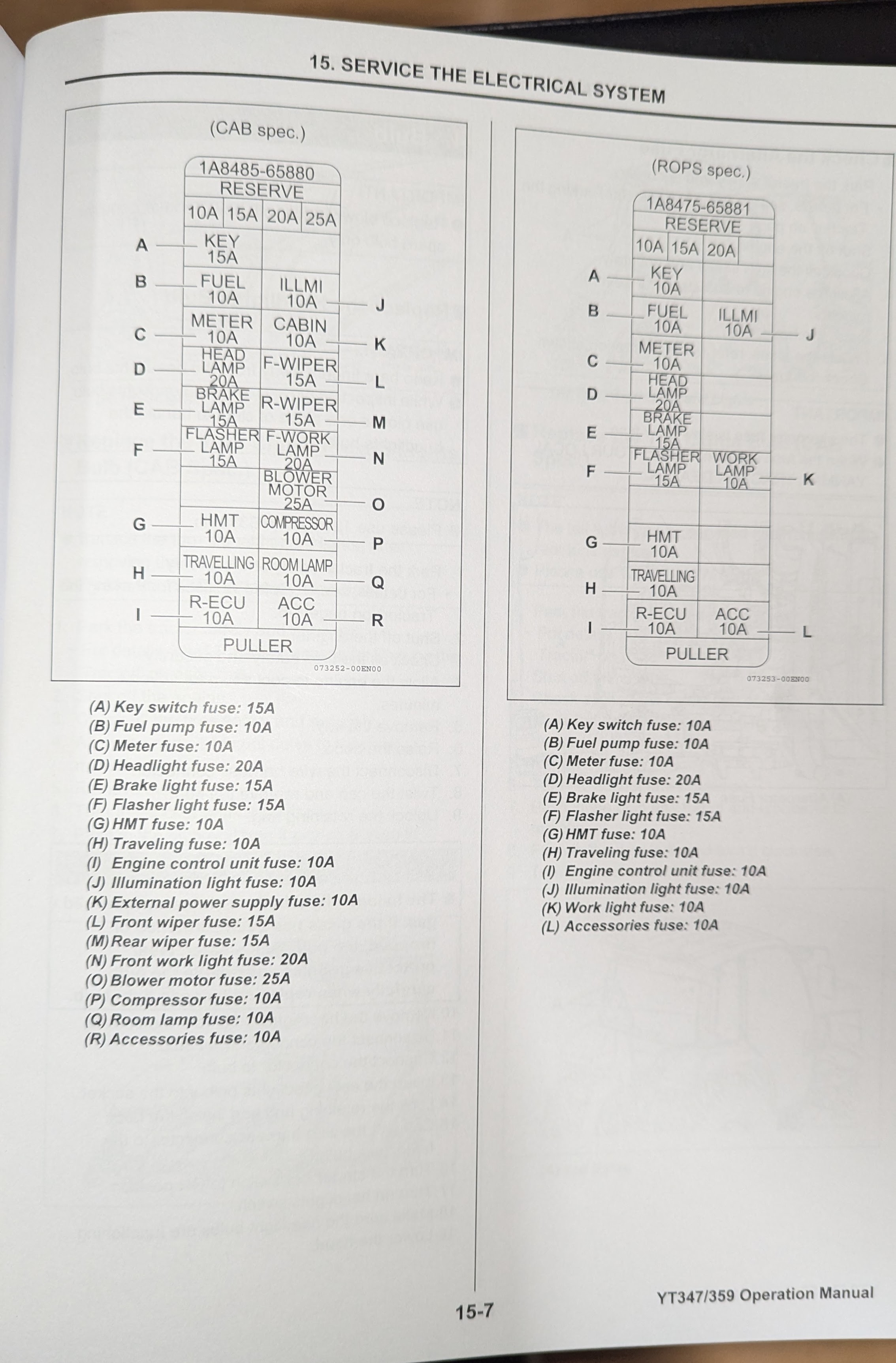

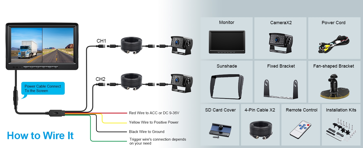

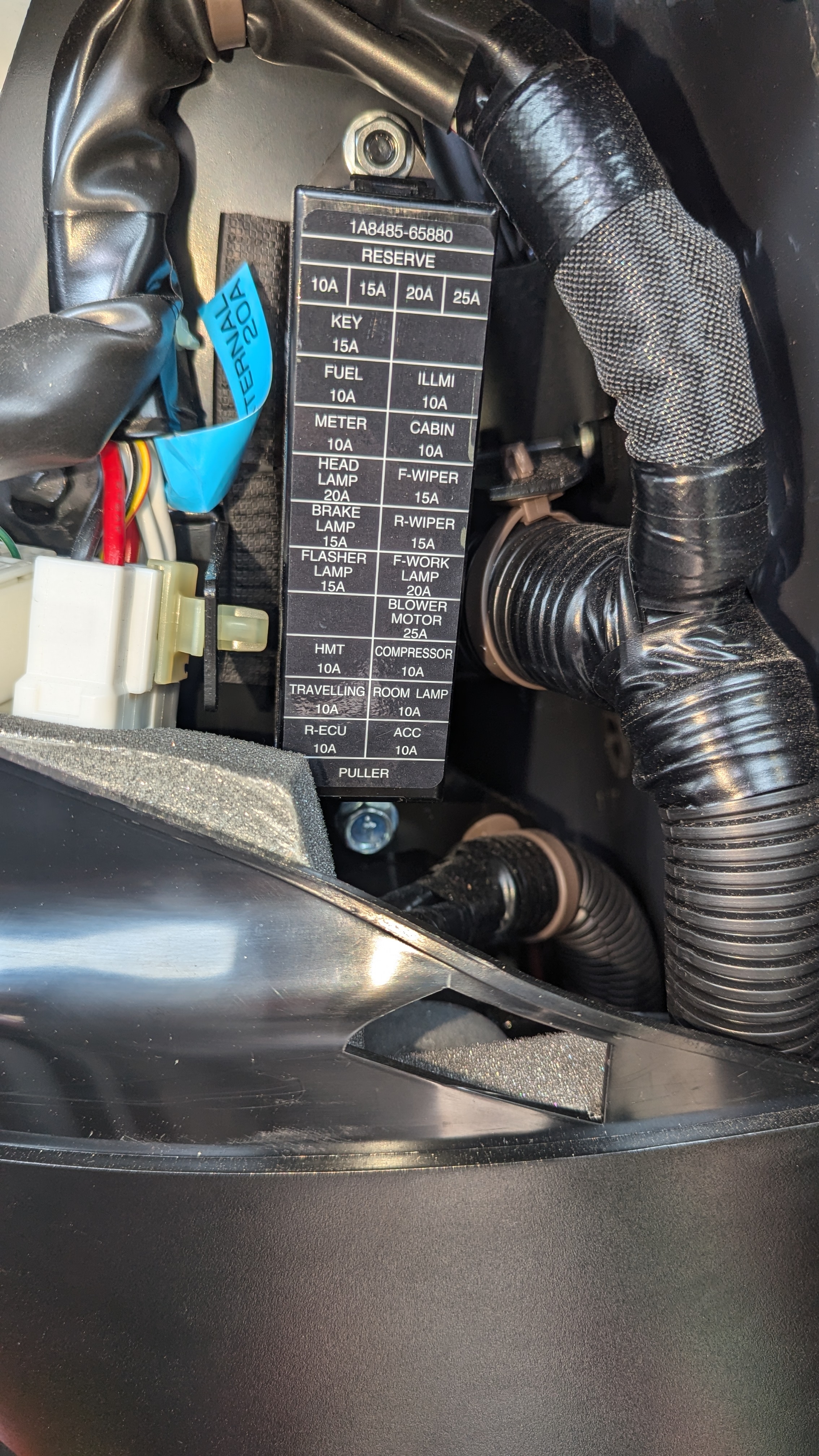

Thanks for that, Willy. Here's the diagram that came with the system. Also, attached is the fuse/amps diagram for the YT359. Looks like it's a 10AMP fuse. I'm guessing the ACC fuse is the cigarette lighter as it says not to use as such but for accessories only. It's the only extra power outlet inside the cab. On the cigarette lighter cover it says 12V 120 watts max and it's controlled by the ignition switch (tested).

I’ll get an adapter for this. Thanks for confirming everything. However, I need to verify a couple of things: The 'ACC' fuse is labeled 'Accessories' but doesn't specify in the manual what it is, and I believe the 'External Power Supply' fuse is for the cigarette lighter. I don't have an outlet on the back of the tractor and the fuse for 'External Power Supply' is labeled 'CABIN' which makes me suspect it's the actual fuse for the cigarette lighter plug. If that’s the case, I’m wondering if I could use an 'add-a-circuit' fuse tap on the ACC fuse to power the system?

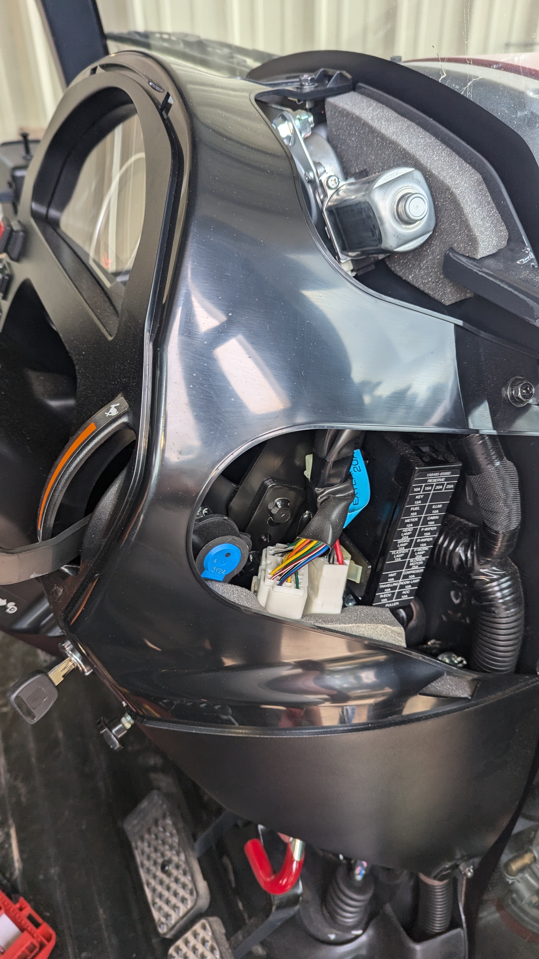

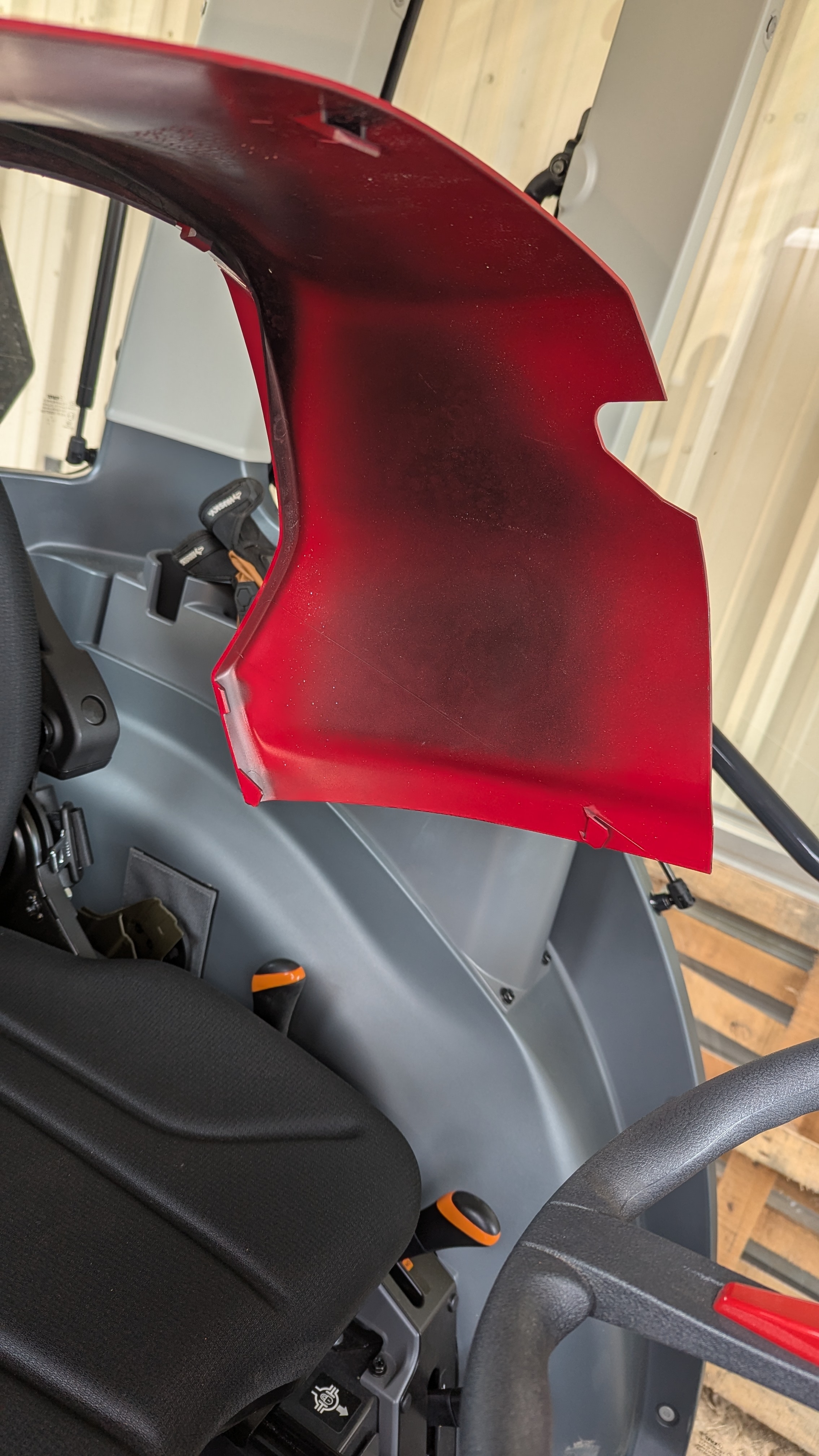

I contacted the dealer to confirm and inspected it myself as well. The ACC fuse, labeled 'Accessories,' powers both the cigarette lighter and the radio. The CABIN fuse, labeled 'External Power Supply,' doesn’t appear to be connected to anything. According to the dealer, it’s likely for the external power plug in the rear, which is installed on some models but not others. He also said most cab camera systems draw very little amps and should be fine running off the ACC. Both fuses are connected to ignition power. I’ve attached a picture to show how the dash cover is removed. It slides towards the driver—don’t pry it towards the doors. Push it towards the driver's seat, and it will pop off easily. Also, you can use a plastic trim removal tool to assist if needed. I'll post pictures once I'm done with the install.

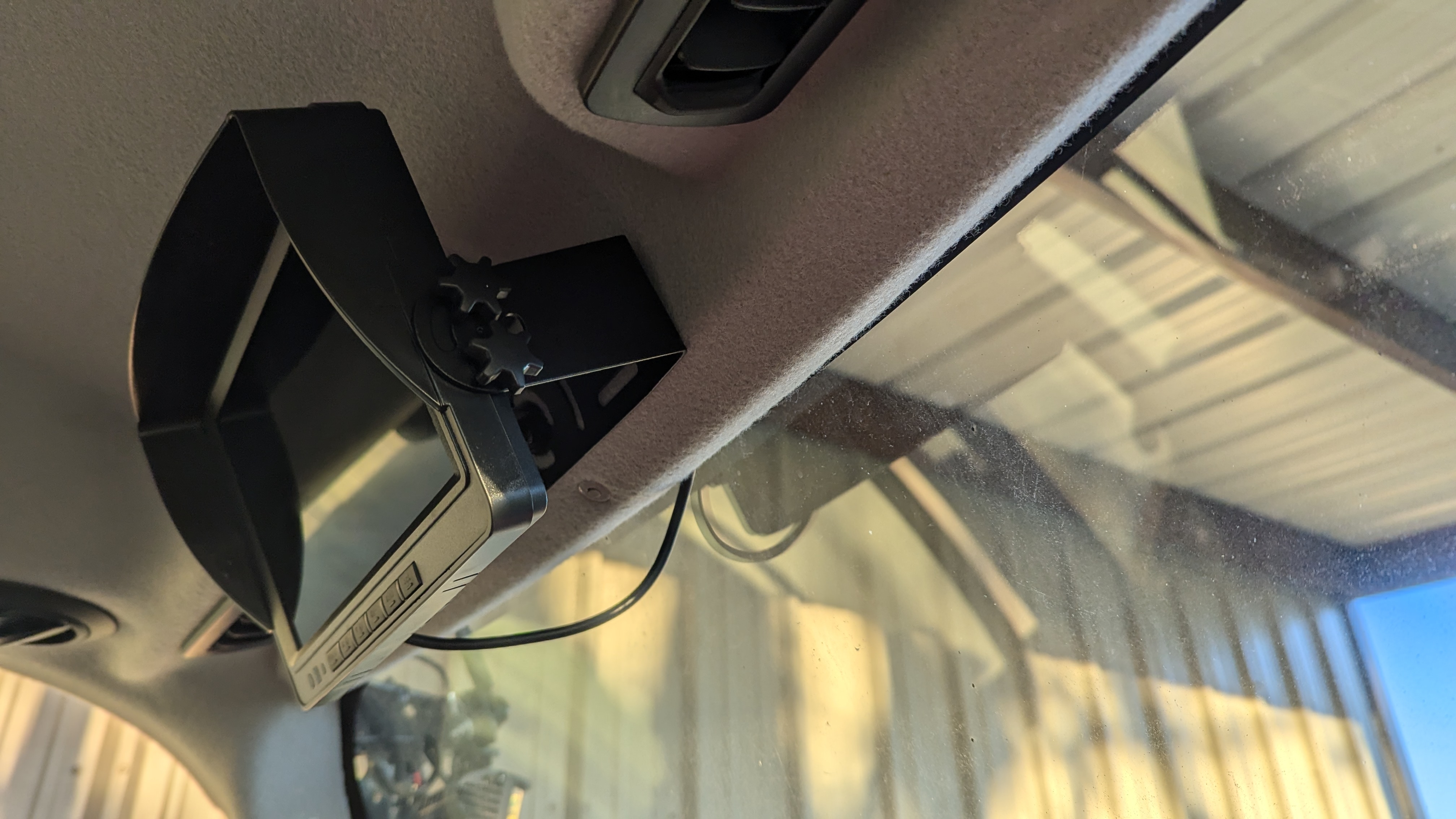

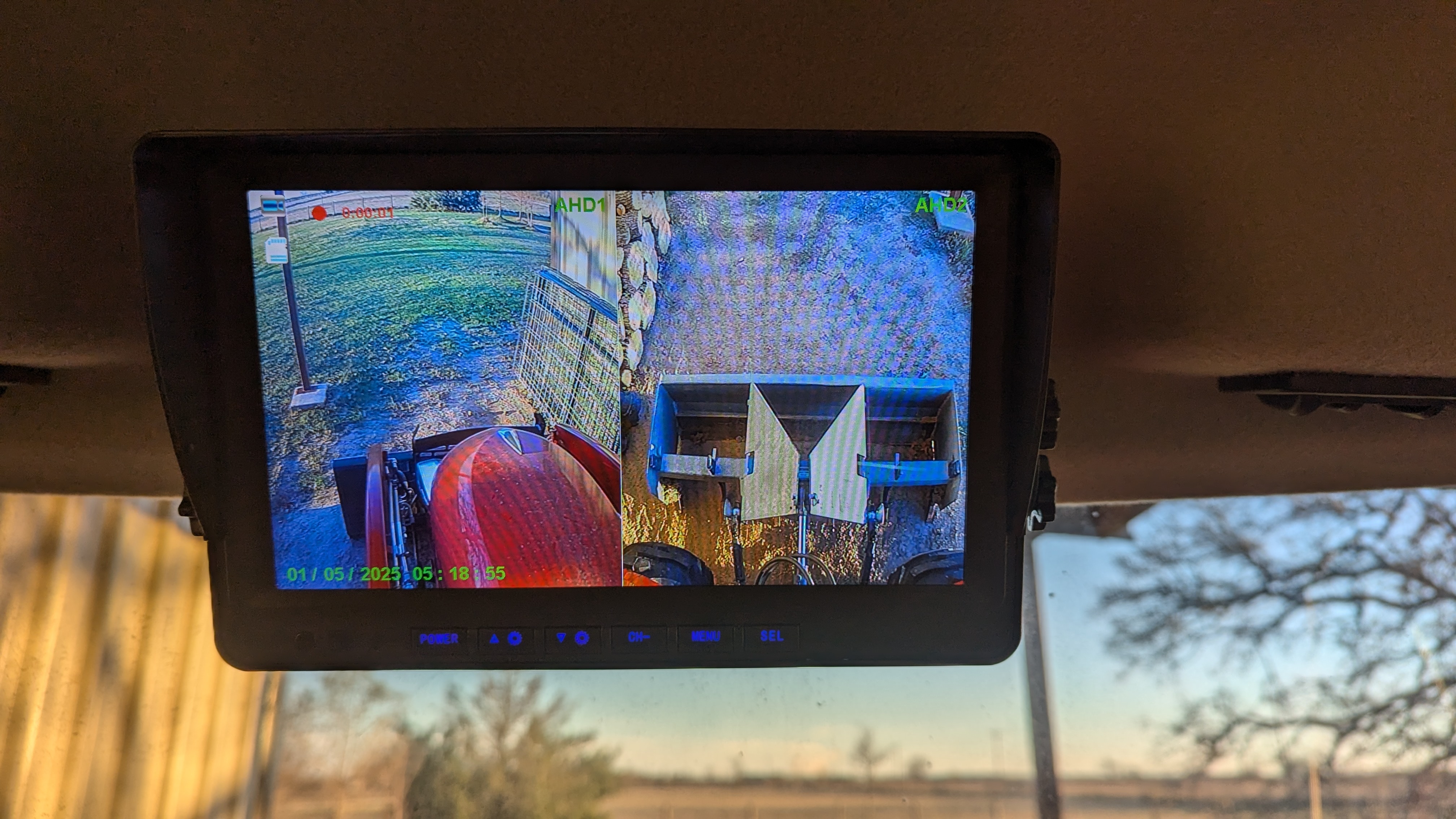

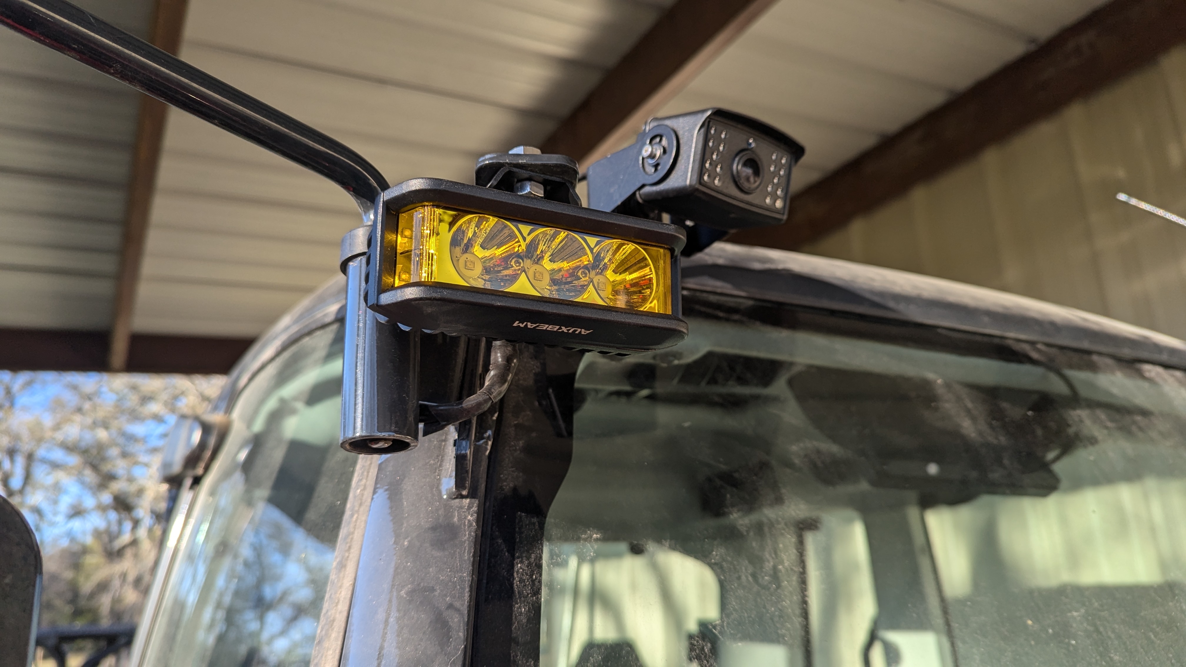

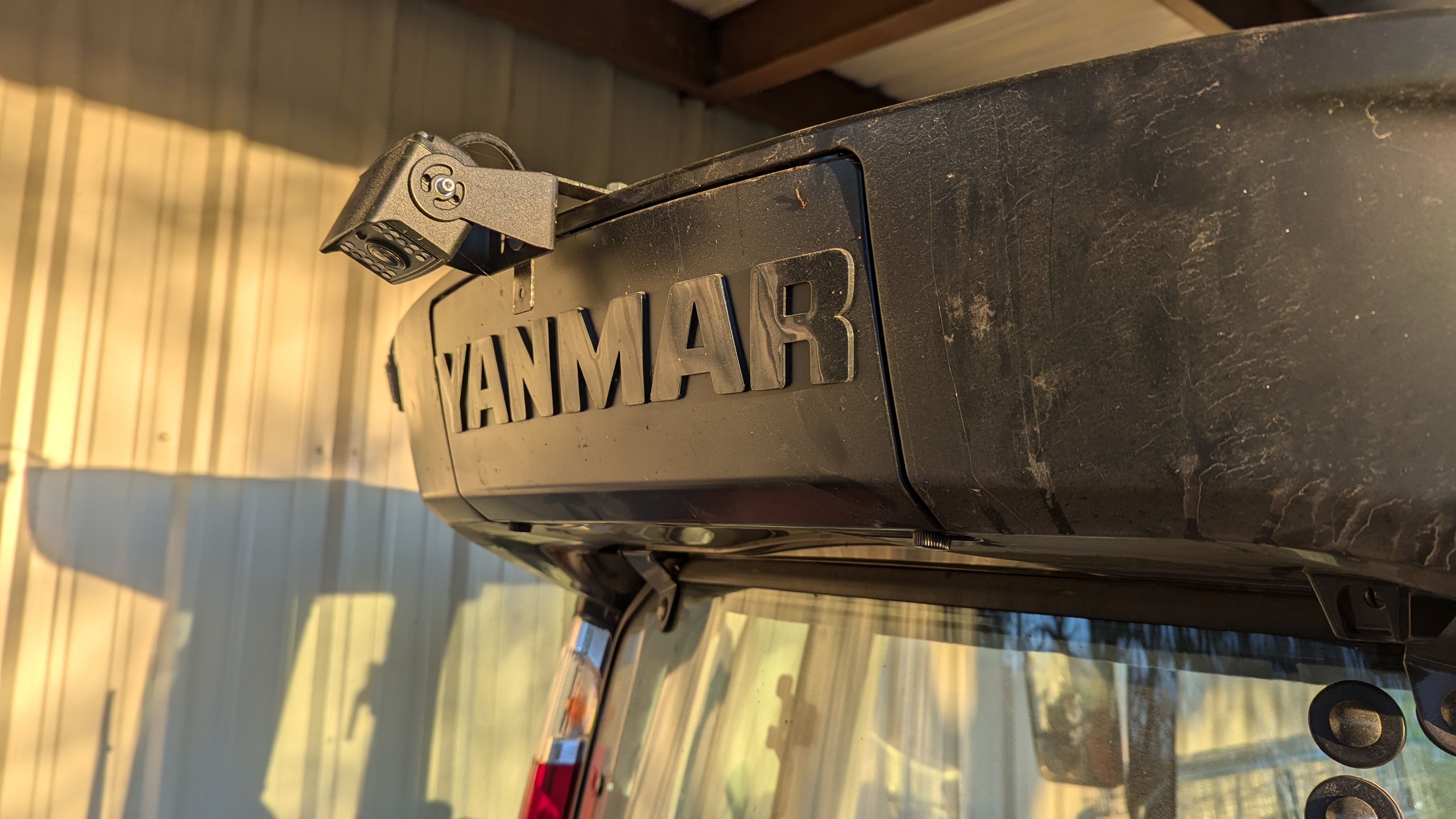

(y) Turned out good. I just wired directly. Might need to adjust front camera but happy with it.
