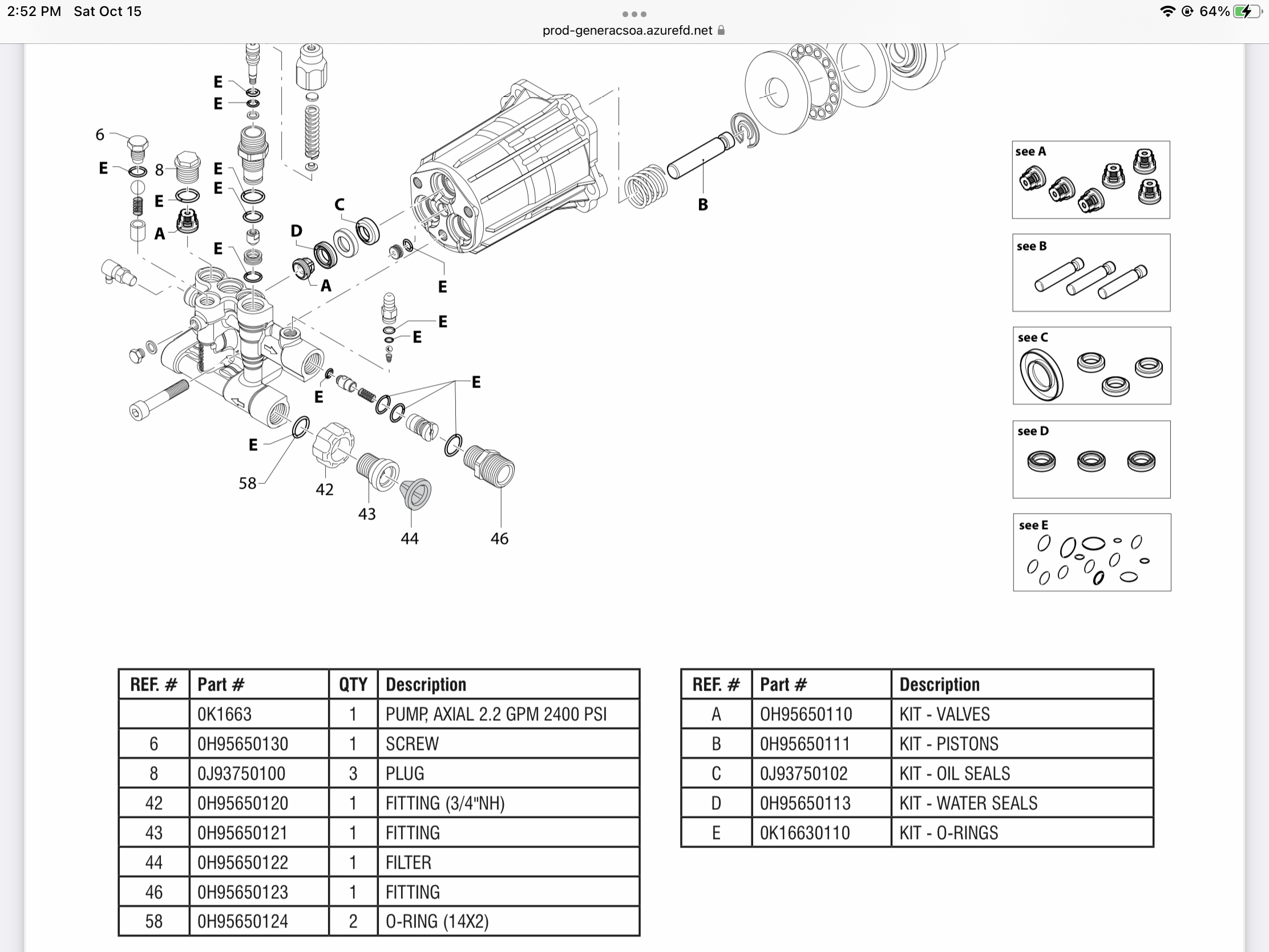

Thanks guys! You were right, there was a hex fitting behind the screen, 8mm, and I removed it and got the plastic coupler off. Now I’ll order the new one and be good to go. Thanks again.
Nothing wrong with the pump at all. It’s 6-7 years old and still going strong.

I have a Generac gas power washer and I am having problems with my water inlet fitting. It’s plastic and the threads are stripped which causes a huge fountain-like leak. For the life of me, I can’t figure out how to get the plastic female fitting off to replace it. Has anyone ever done this before?
