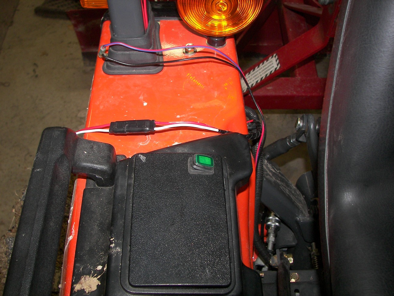

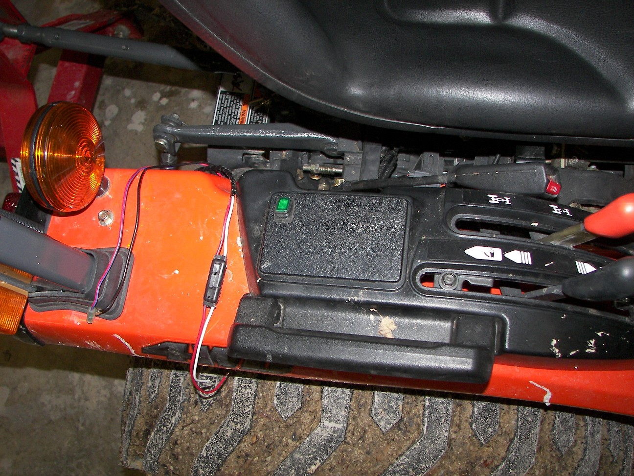

When I put lights on my ROPS I put them on a plug and it is no coincidence that it is the same type of plug that my electric sprayer has as well. All I have to do is unplug my lights and plug in my sprayer and I use the light switch to turn the sprayer on and off with. The power I used is the factory wiring for the work light that is under the right rear fender, its fused and turns off with the key. As far as wire size I just matched what was on the tractor or the plug connectors.

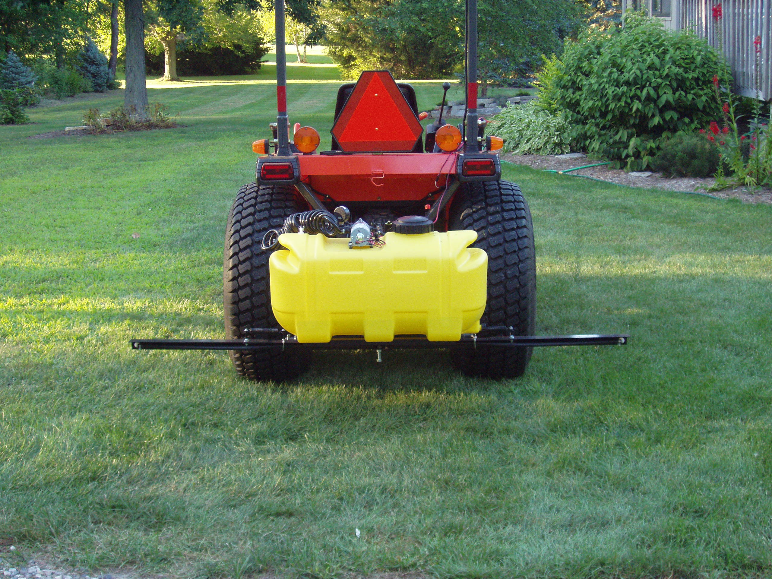

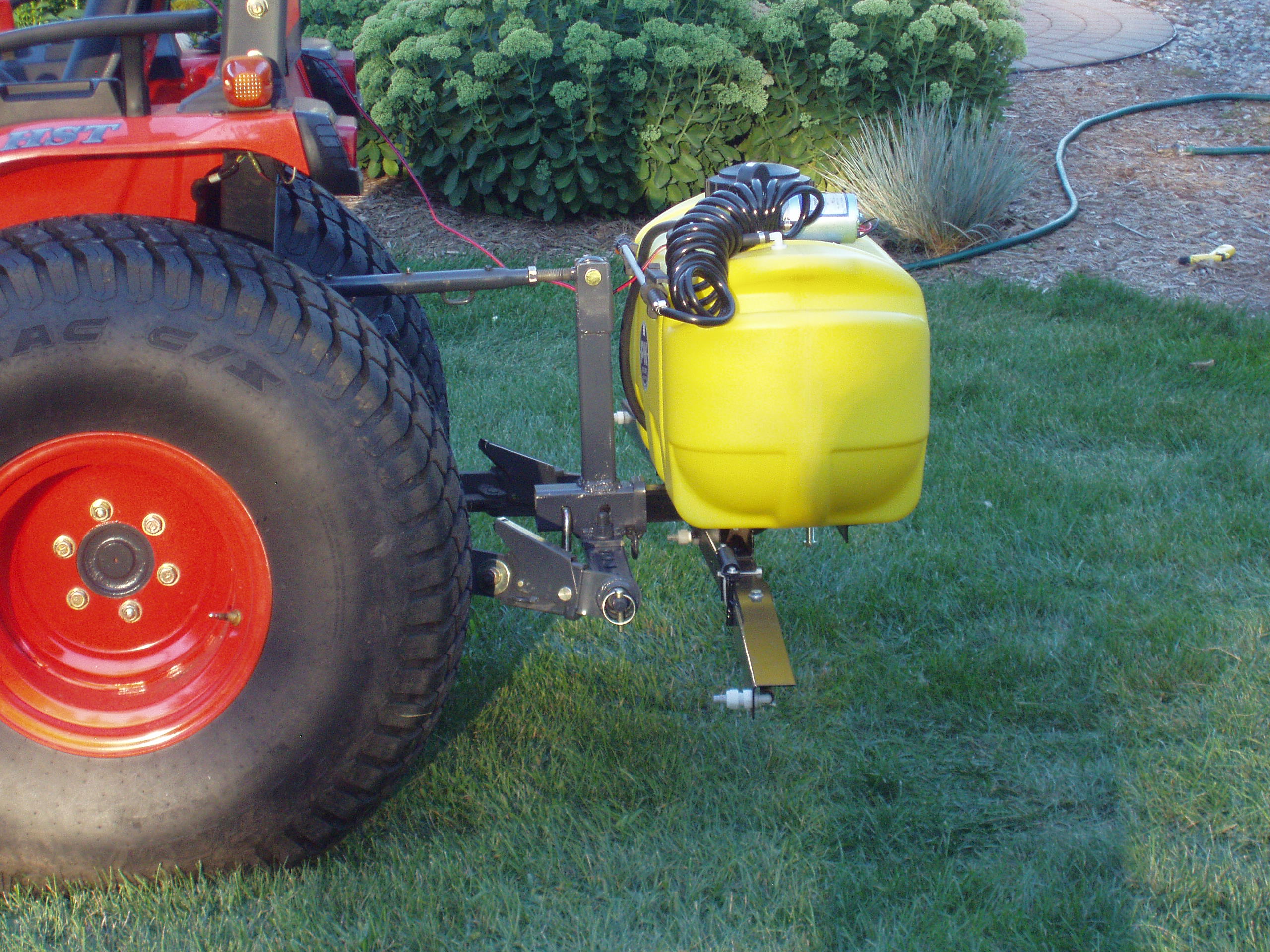

I use an electric sprayer with my B3030. I powered it by using the rear worklight wire to activate a 30 amp relay when the key is on. I ran a fused wire from the battery post on the starter back to the relay which I mounted under the right rear fender. The relay has three power out circuits. I use one to to power the sprayer and the other two to power the lights I added to the Rops. Works great and has fused power available just by turning the key to ON. I also added the 43 amp alternator for extra capacity.
