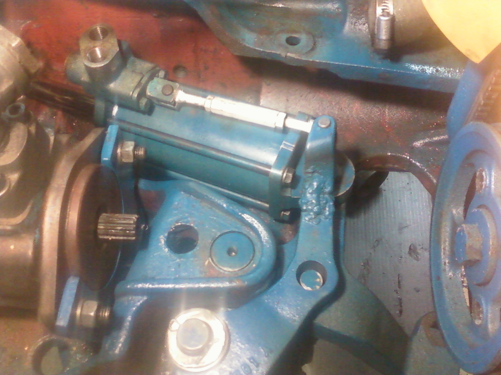

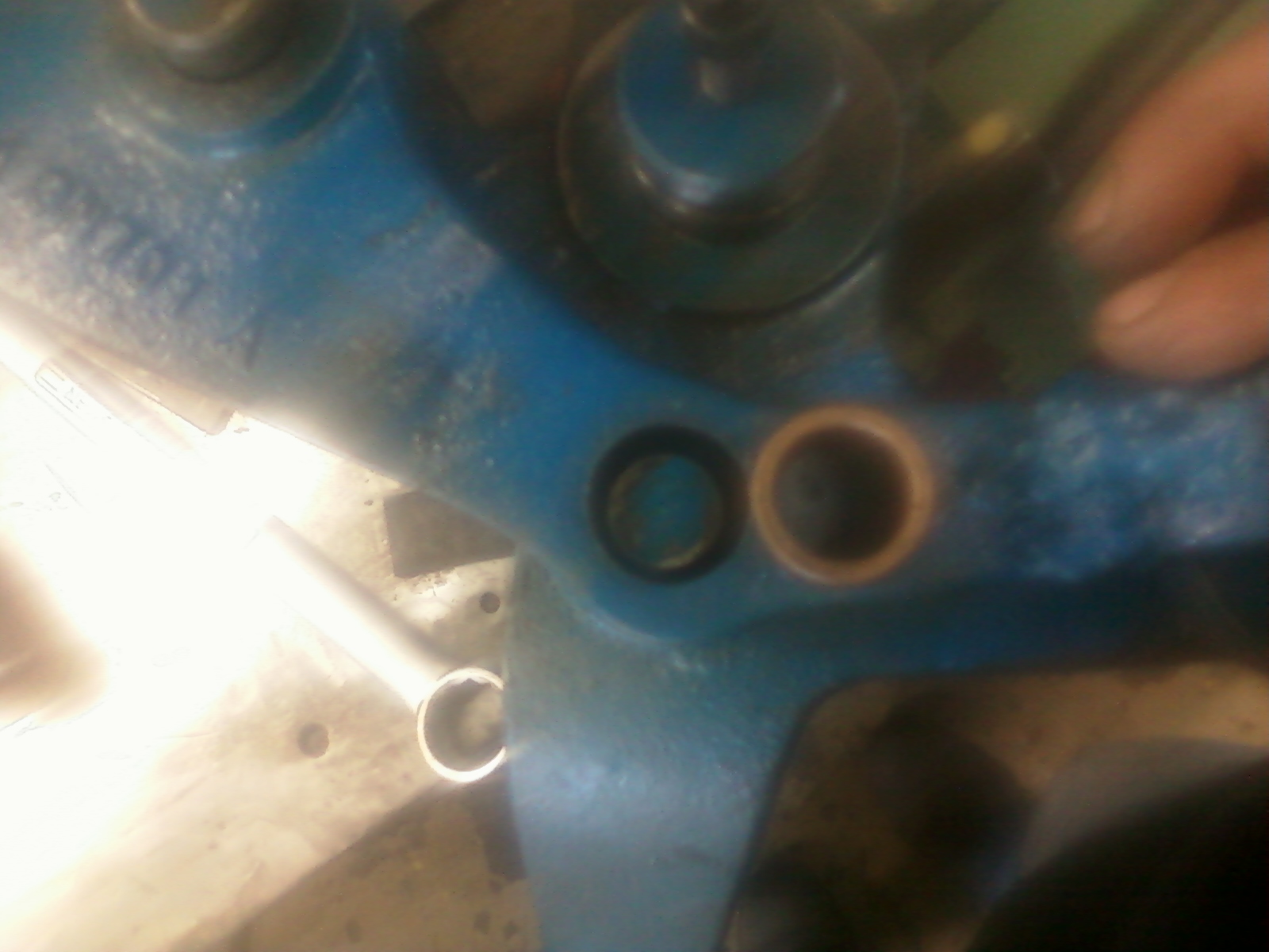

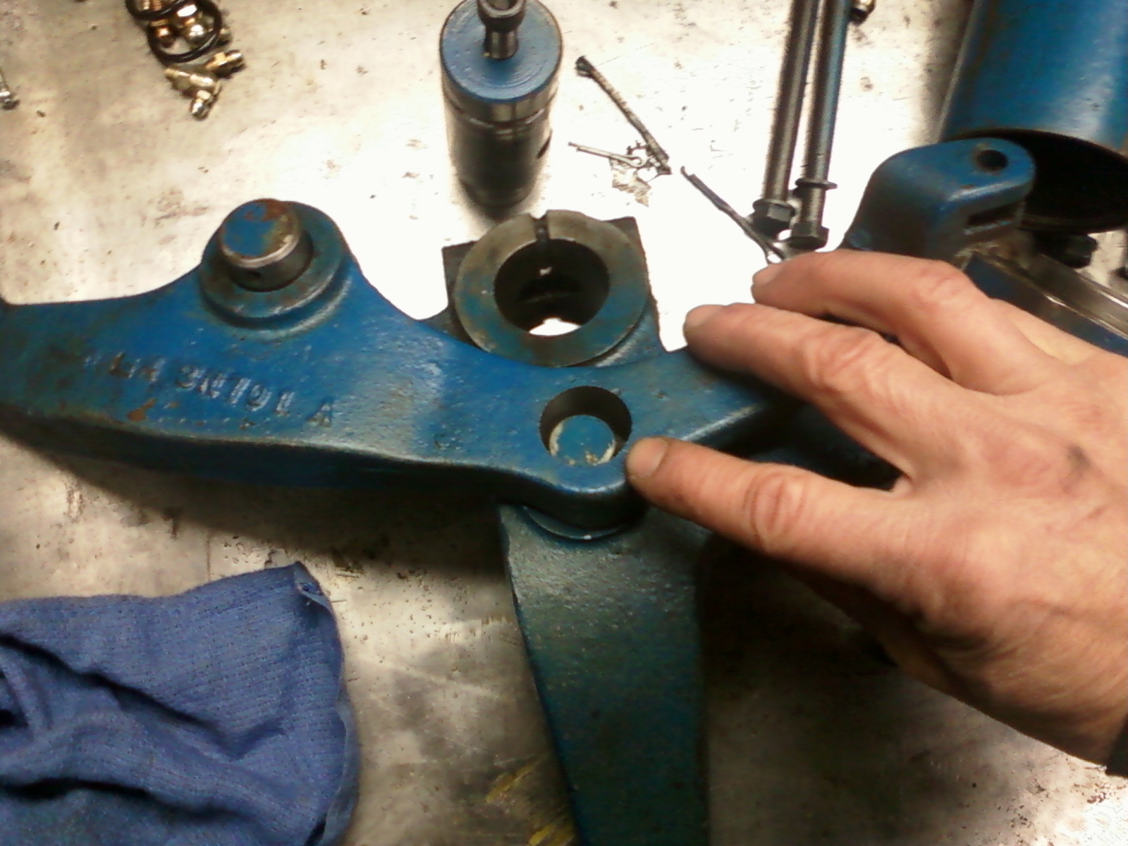

Got busy working on other things, now i am back to the tractor. I decided to take it all apart again since the PS cyl leaked some. With the parts on the bench I was figuring out how this works & I think I screwed up. While re-rounding holes & adding bushings to take out slop,I took out the play needed for the rod to operate the valve on the cyl. So all I need to do is remove my bushing. I will know in a few days for sure when I put it back together.
I will post how it went (with pics.) when I get done

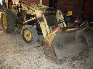

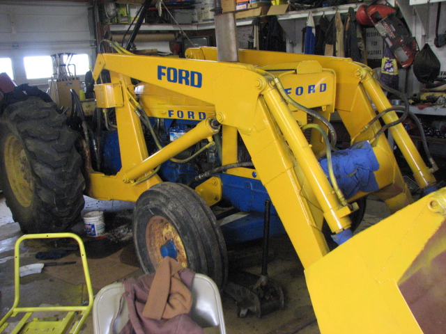

Some pics as I promised, The 1st is from the add when I bought it. Then some of the screw up I had to re-do. And one of current with a lot still to do.
