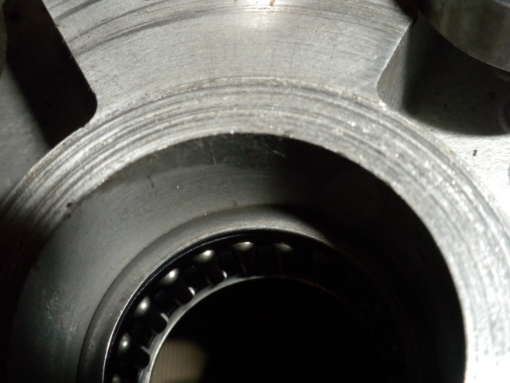

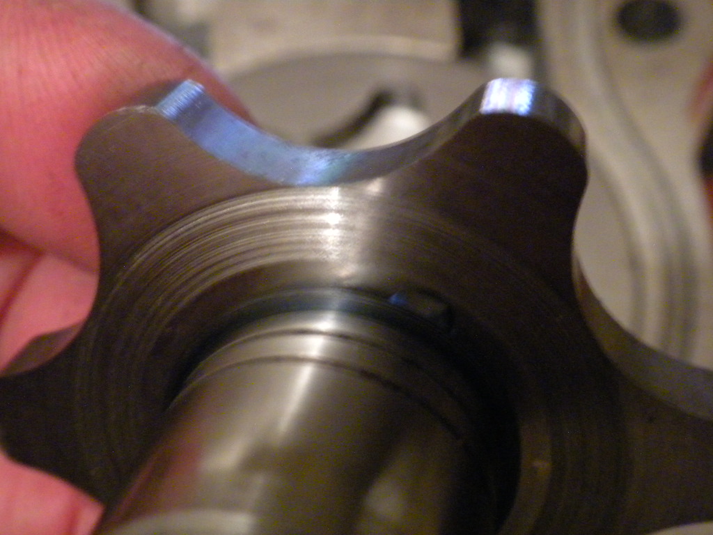

Here's some more pix of another housing that is damaged
this pump had less than 1 hr on it.........the customer bought a new complete pump, installed their-selves, then one of the drive motors locked up while it was on the maiden voyage
We fixed the drive motor (bearings came apart internally) then yanked the pump and found this
contamination from the drive motor got stuck in the charge pump section and main piston section......when the customer changed the pump they should have yanked all the motors and freshened them up with new seal kits (they would've found the root of the problem was actually a bad hyd wheel motor)
You guys should proceed with caution when working on these units cuz they are working directly with the drive motors and share the same oil back and forth
Many hyd shops will not work on hydrostat pumps without doing the corresponding drive motors to cover their butts
